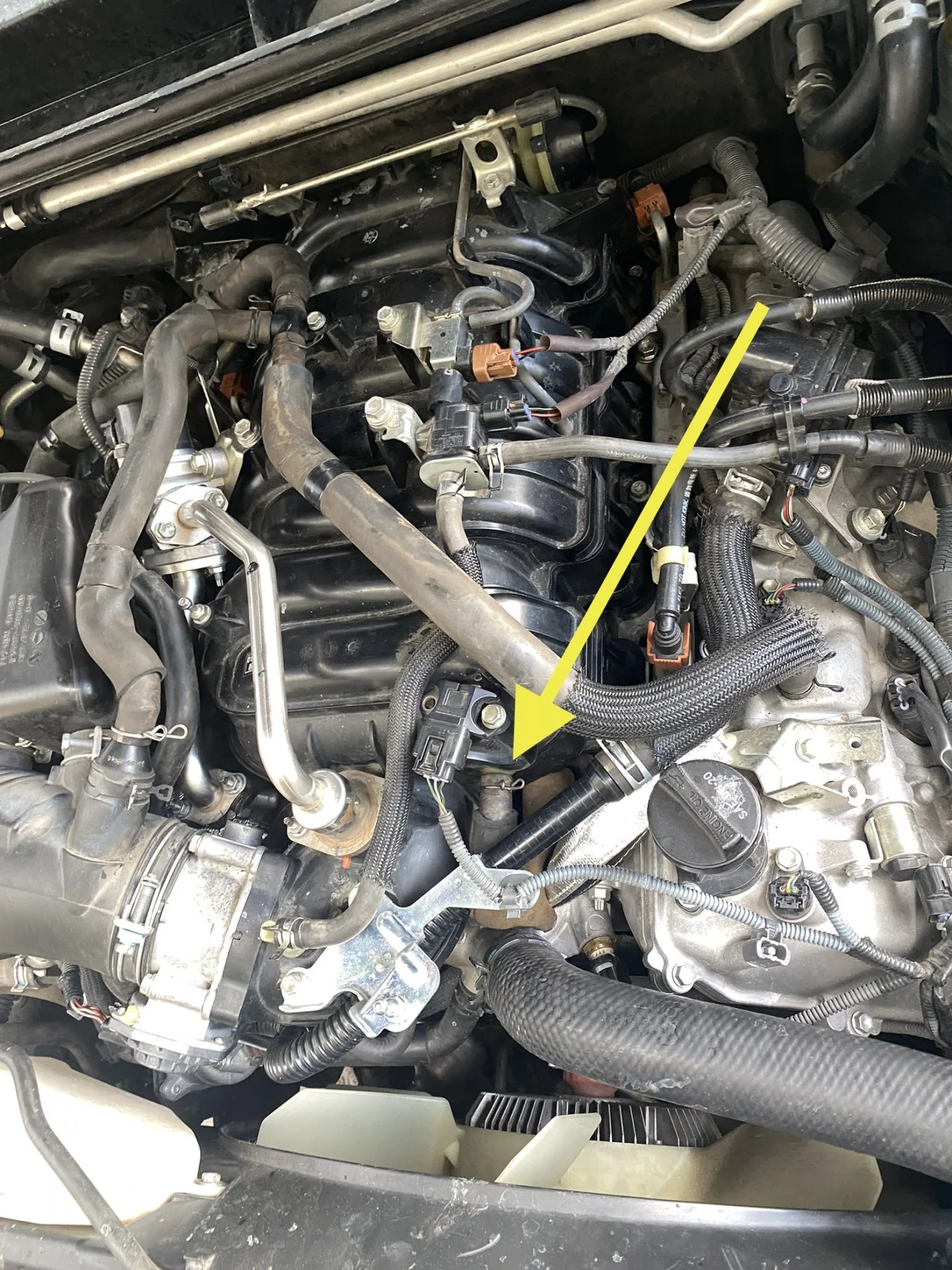

What we’ve learned, thanks to his hard work, is the issue is within the intake manifold. When I picked it up, he mentioned he finally was able to find something else that stopped the symptoms, much like blowing air into the intake. He disconnected the short air line that runs from the PCV valve to the intake manifold and let it sit for the 1-1.5 hours and it didn’t long crank.
This connection:
Based on that, today I did the same and was able to replicate it, with that line unhooked and it sitting for the right amount of time, the long crank problem ceased to happen. I then repeated the process, disconnecting the line and plugged the intake manifold port (leaving the PCV Valve output side to vent) and it exhibited the issue. So the issue isn’t fixed by the PCV system venting, it’s the intake manifold venting to atmosphere that solves the problem. There’s either hot air (likely not the problem) or fuel rich-enough air/EGR recycled air collecting in the intake manifold and that’s leading to the long cranks.

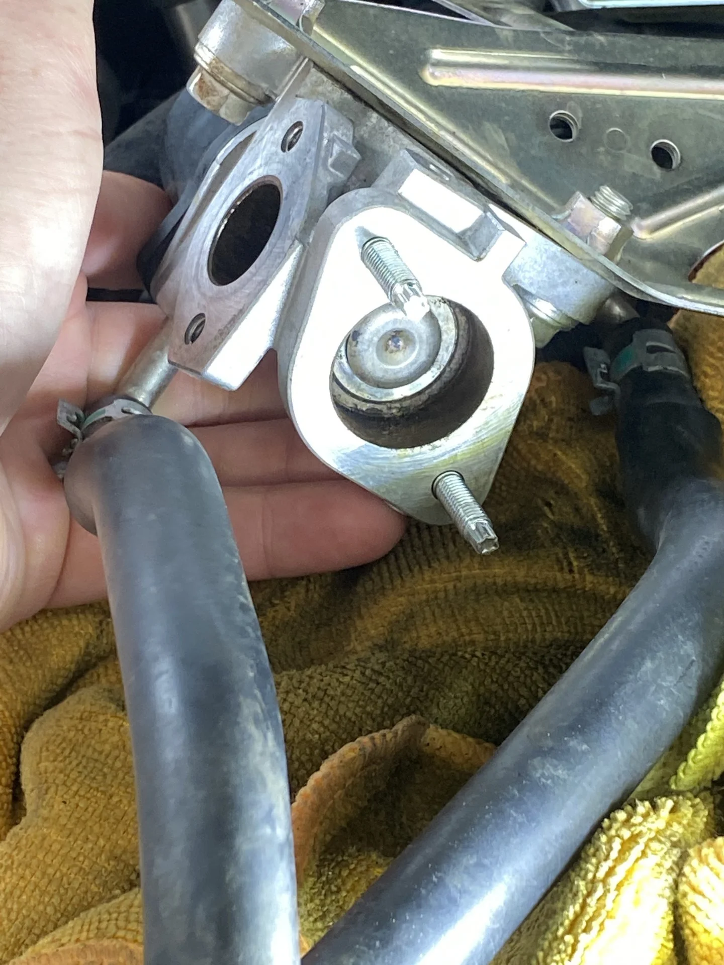

Pulled the EGR valve and it had plenty of gummy gunk in there, but appeared to be fully seated closed. I also used a poker to push the valve open and closed a few times and it seems to operate smoothly.
Here’s the bottom side, aka the outlet of the valve, where the center plunger extends out from the body of the EGR valve to open. It’s closed in the pic and after cleaning it with carb/choke cleaner.
I also fished a metal snake down the EGR air lines and didn’t find any obstructions in the passages.

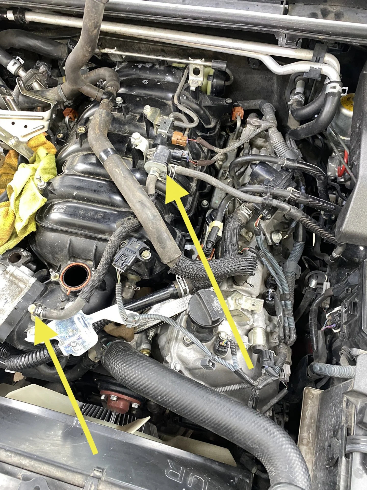

I looked around, questioning what else might be a culprit and this purge valve sticks out. Best I can determine, it routes back to the fuel tank/vapor canister and will vent excess vapors from that system into the intake manifold intake runner. Valve and where it enters the intake are highlighted.
I’m waiting to check the EGR cleaning results before moving onto disconnecting the tubing from the purge valve to the intake manifold, plugging the intake manifold opening (leaving the purge valve outlet open to atmosphere) and seeing if the long crank happens or not.
With the fuel vapors not making it into the intake and the intake not venting, it’d tell me if this is the source of what is filling the intake manifold.

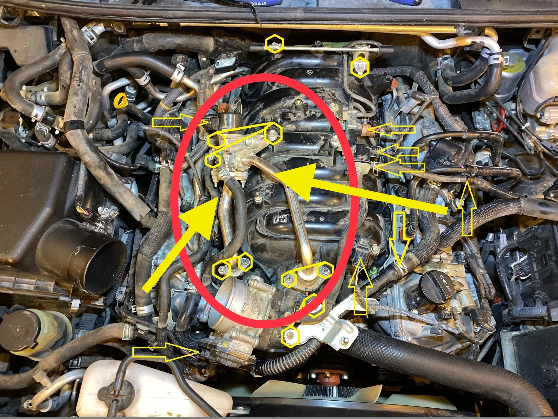

EGR cleaning is pretty straight forward. You don’t have to disconnect the coolant lines that run to/from it just to clean it. Just unbolt the three 12 mm bolts that mount it to the intake manifold (top three circled bolts) and the four 10 mm nuts on the inlet and outlet gas piping (bottom four circle nuts) then the whole EGR valve housing can be moved around, flipped over, etc (there’s enough slack and play in the coolant lines).
The remove the inlet and outlet pipes from the main body (four more 10 mm nuts) and you’ll have direct access to both sides of the plunger valve. I used a few rags underneath and choke/carb cleaner to flush it out and a rag to get a bit more aggressive on the outlet side. Blew it clean with shop air and reinstalled it.
