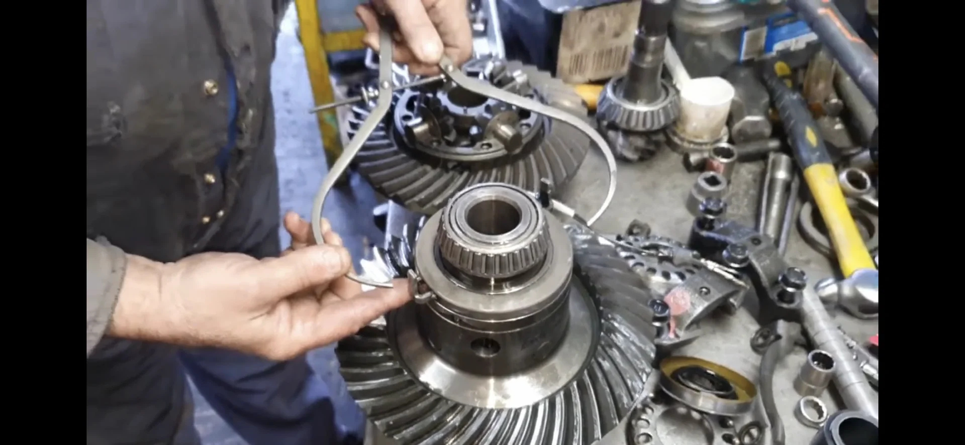

I saw a comparison between the elocker and the tjm .. wow the e lock is a lot smaller carrier, smaller axle gears, 4 pinion x is not as good, side bearing small socket all head screws I wasn’t impressed. Even the internal locking ring was small.

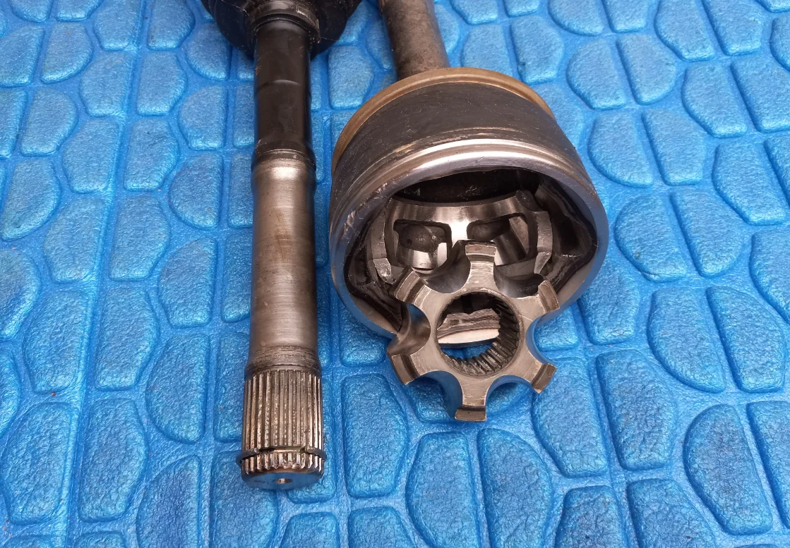

3) I have destroyed a fairly new OEM outer CV axle from rough wheeling without damaging the eLocker.

...3) I have destroyed a fairly new OEM outer CV axle from rough wheeling without damaging the eLocker...
This is all you really need to know. An OEM CV axle being the weak link in the chain? That's all that should ever be asked of it then a little more.
Yep. I think of it like a fusible link that blows when I get too ruff.

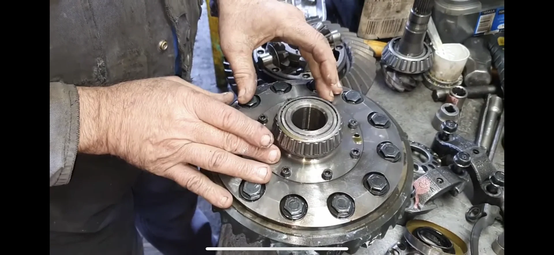

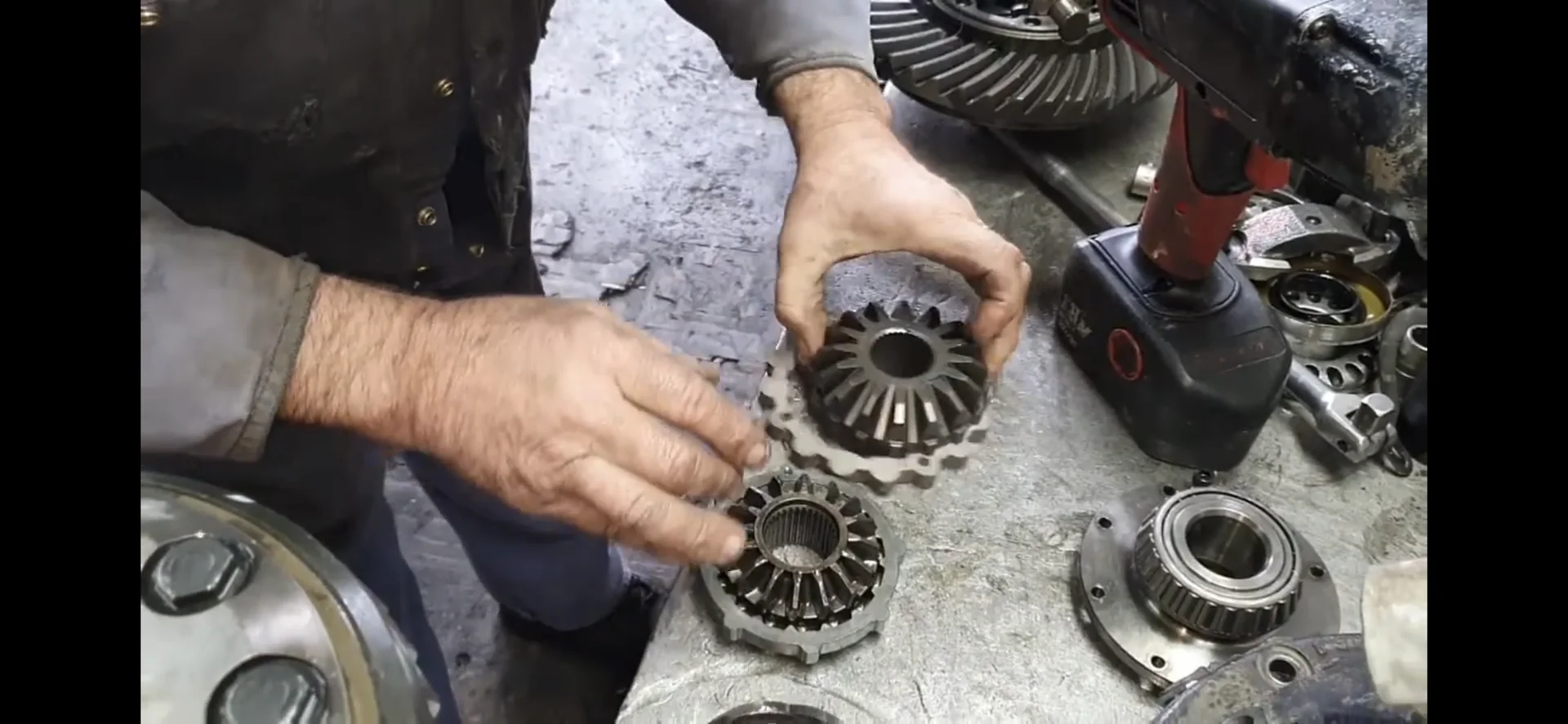

Just contrast yota rear Pro Locker / Elocker compared…
Carrier is smaller for the larger ring gear
Pinion 4 cross shaft one peice vrs 3 peice
Lock ring to axle gear huge size difference between the two.
Removable bearing housing in the e locker held be small bolts … hex head screws.
Now , back Of my cruiser… that small dif would work, agreed by not heavy duty for the rear when compared if you look at the design.
My two cents…
Now the front 8 inch maybe he about the same. But they neck down the e locker to smaller components for the 9.5 Toyota. That. Am not crazy about IMO .
