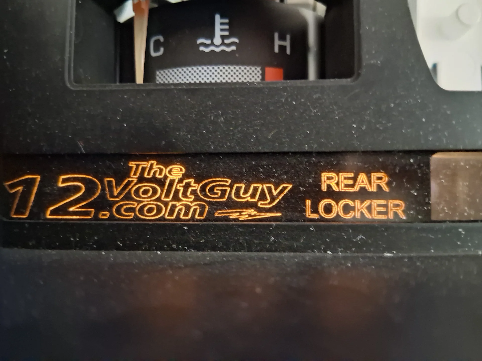

I can laser engrave whatever you need.
just did one for my 924runner, logo +REAR LOCKER

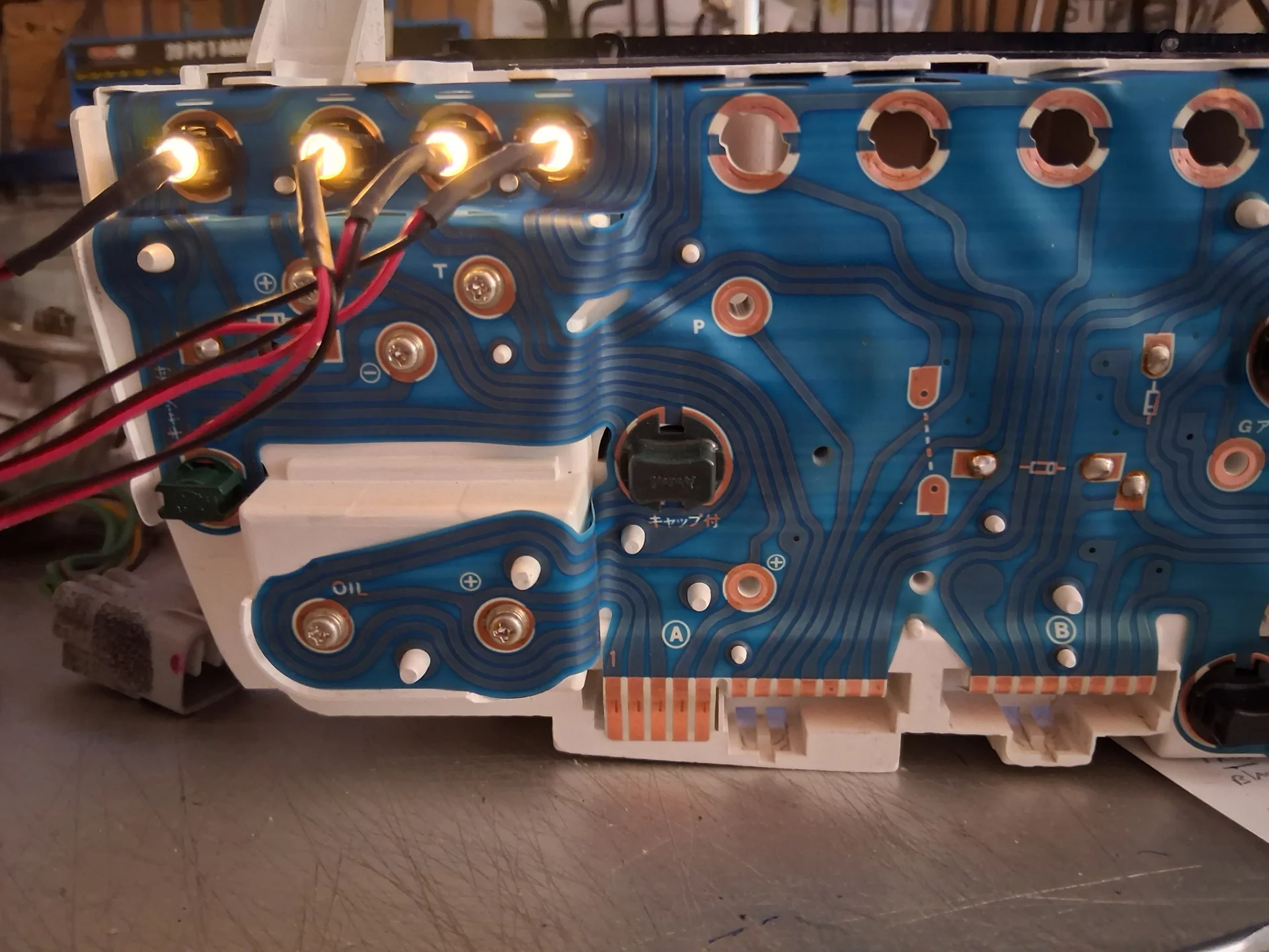

drill out bulb holders & install LEDs from rear

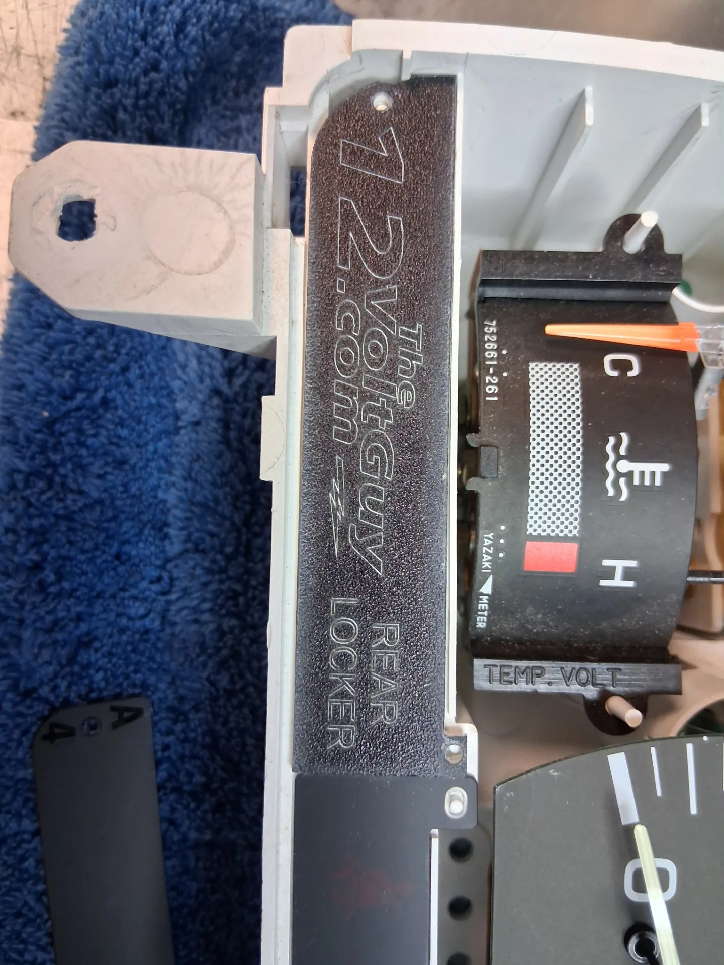

need size or current piece as template
takes a bit of trail & error to get right size I use laser engravable black plastis, letts come out white
I'll upload pics when I get time

Do you got a pic of cluster front rear & taken apart? I can laser cut engrave as seen above any words you want or symbols
i'll get more pics to show detail of how it's done
can also use different color LEDs to backlight blue red green amber orange pink these are colors I have
or any color they make LEDs.
these won't be but $10 shipped
free with purchase of my e-locker wire kit
