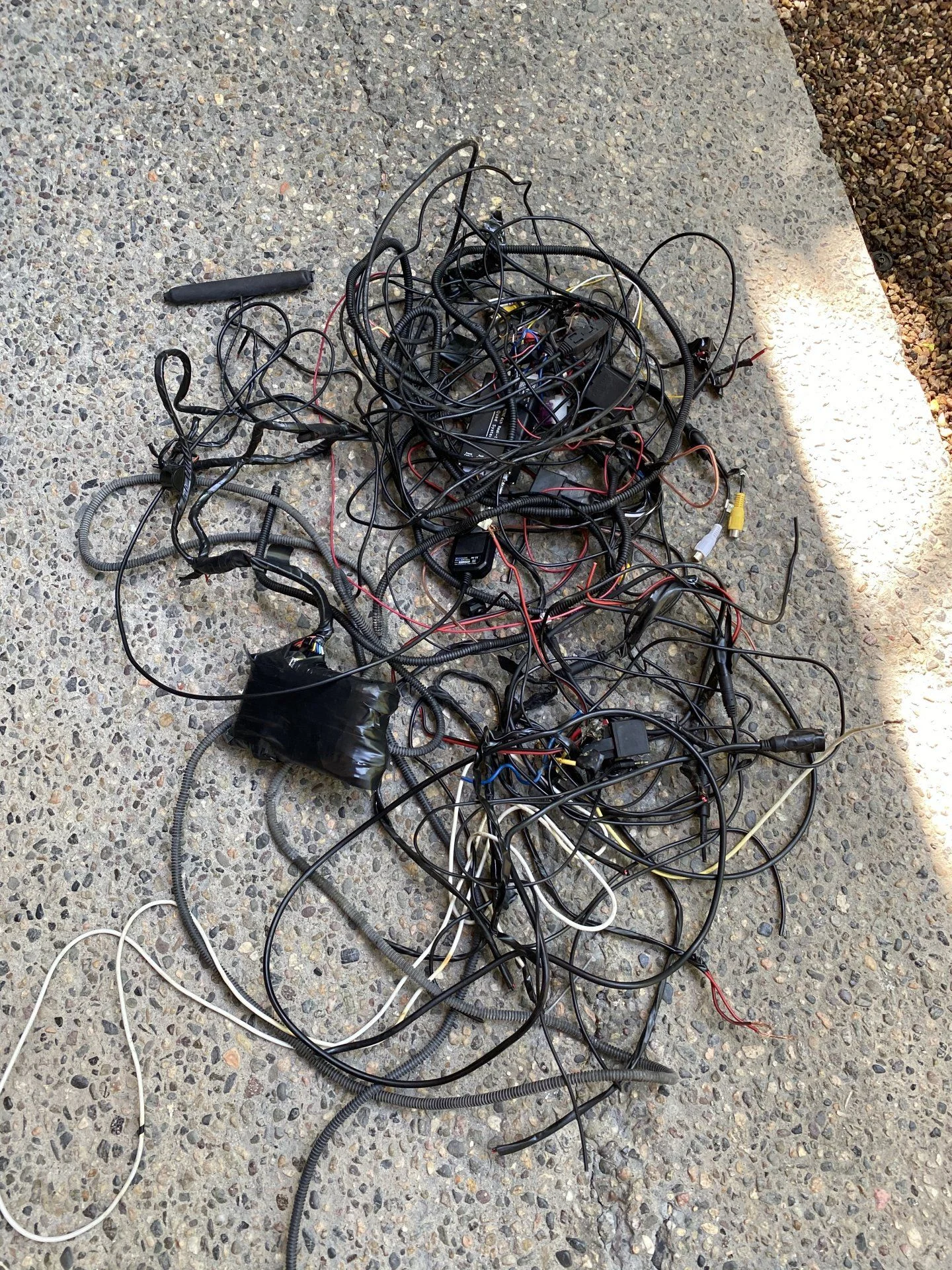

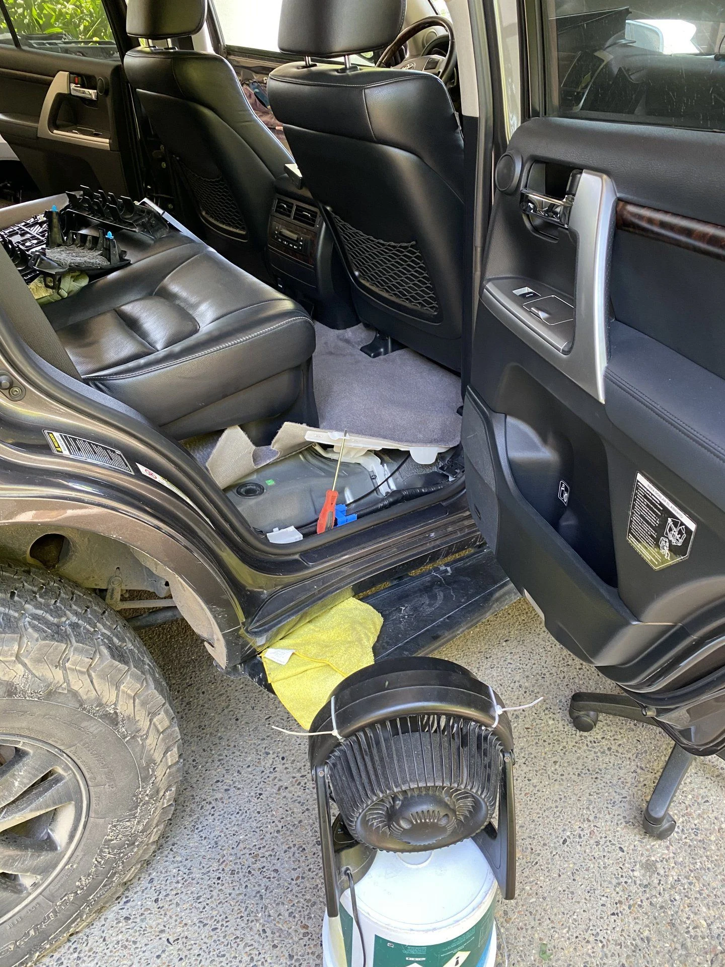

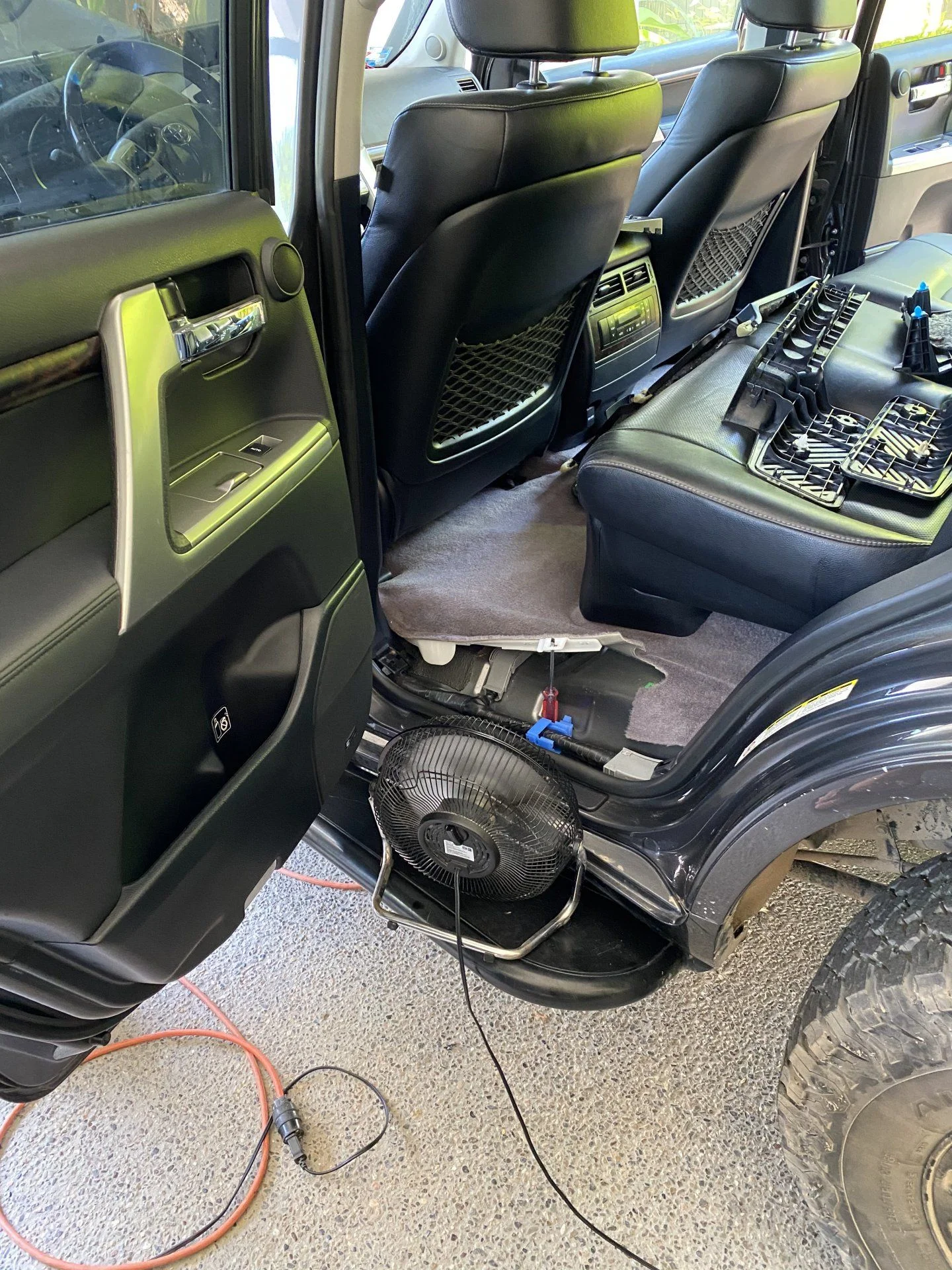

Thank you for the positive note. Much appreciated. The locksmith had it open in 2 minutes. It started so I moved it into garage, parked it, disconnected battery cables and proceeded to pull apart Trim pieces to lift carpet and block it away from the floor boards to get more air flow. In doing so I came across a mess of aftermarket cabling for seat massage, gps locator (mex version doesn’t come with it stock), side and back up cameras (also aftermarket; junk). All poorly spliced in to who knows what at the door sills so who knows what shorts that was causing. All cleaned up now with waterproof sleeves over splice points.

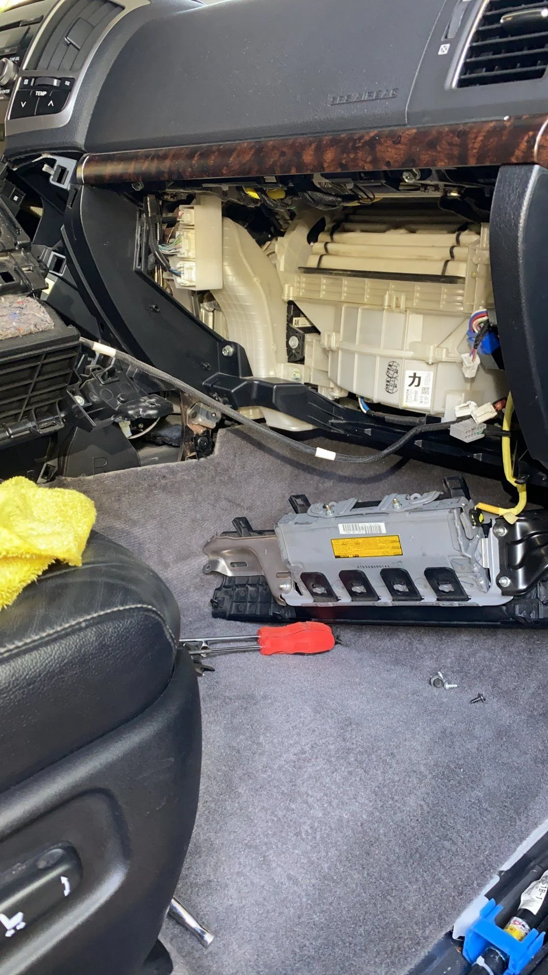

Can anyone give me a link show me how to pull my dash? I am in this far, may as well get the rest of the aftermarket wire out.

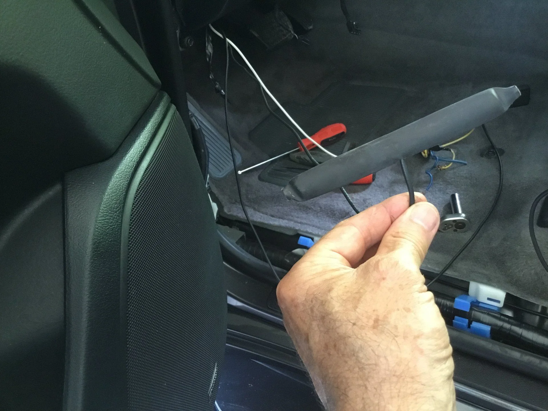

And can anyone tell me what this is in picture. It’s a Belden 8216 RG wire. Mystery to me. More aftermarket?
That device with the RG wire is very likely an antenna of some sort. I don't know if it's OEM.
Anyone else have an idea what this wire might be? I’m digging behind the dash but it goes deep.
I wouldn't bother pulling the dash, but that's just me.
It was antenna for aftermarket gps locator. History.

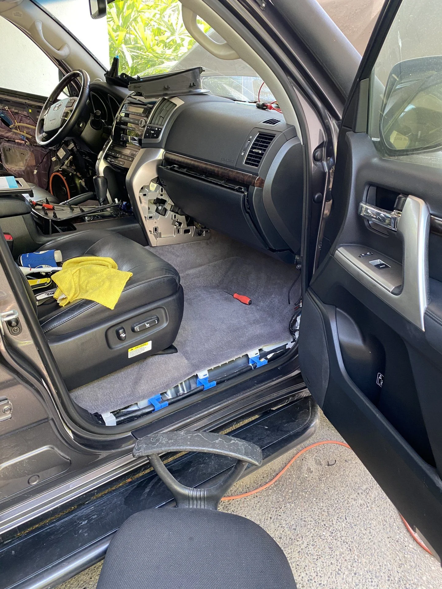

A general question for you all. Is it normal that I had water entering cabin almost immediately? All door frame seals look perfect. Door seals themselves look fine with the exception of each having separated from 2 fastening points right around the flexible wire housings. Remember I had 4 inches of water in the cabin within 5 minutes.
Yes, it's not a submarine. There are drain holes in the rockers and doors so that the truck doesn't rust from the inside-out.

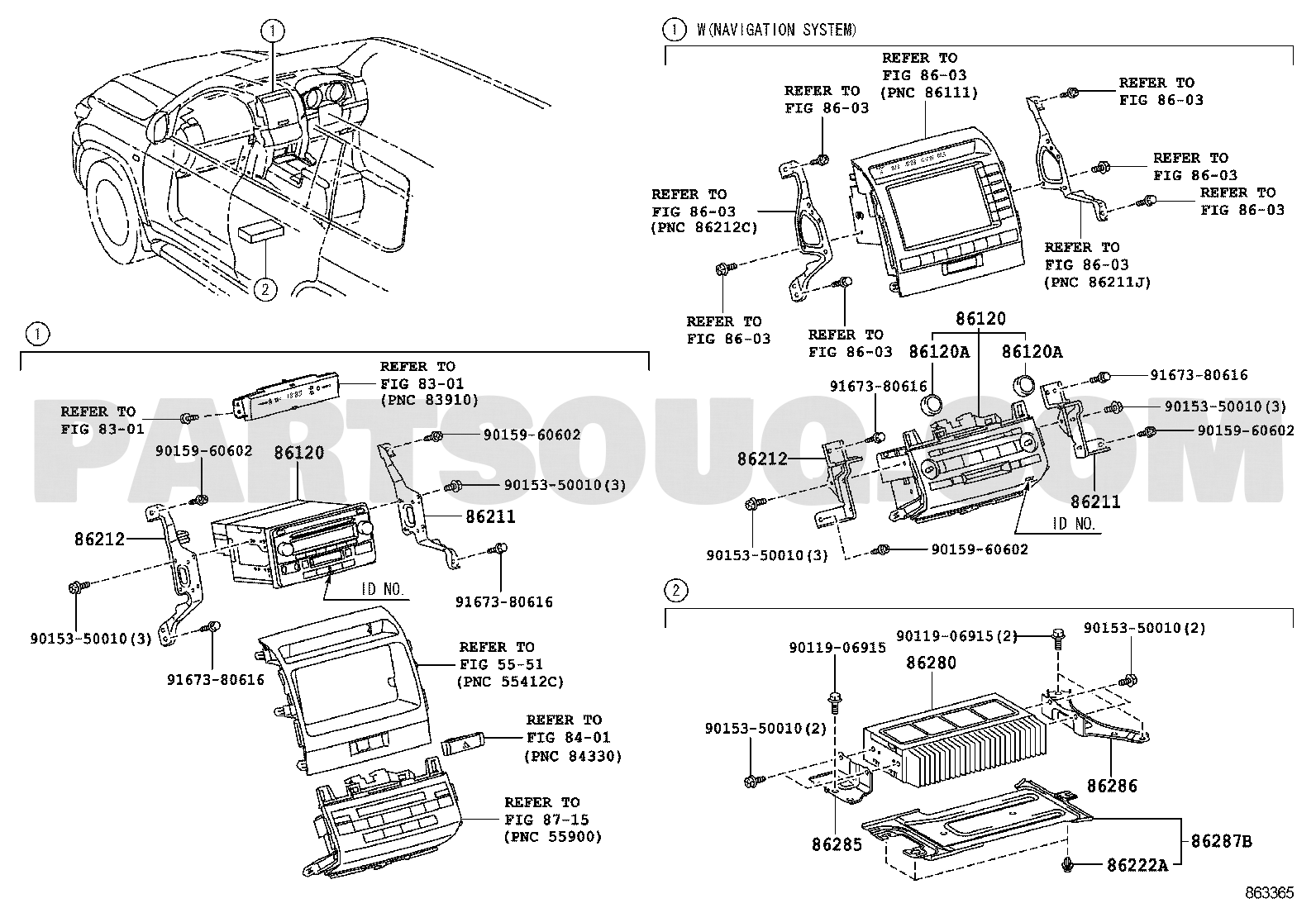

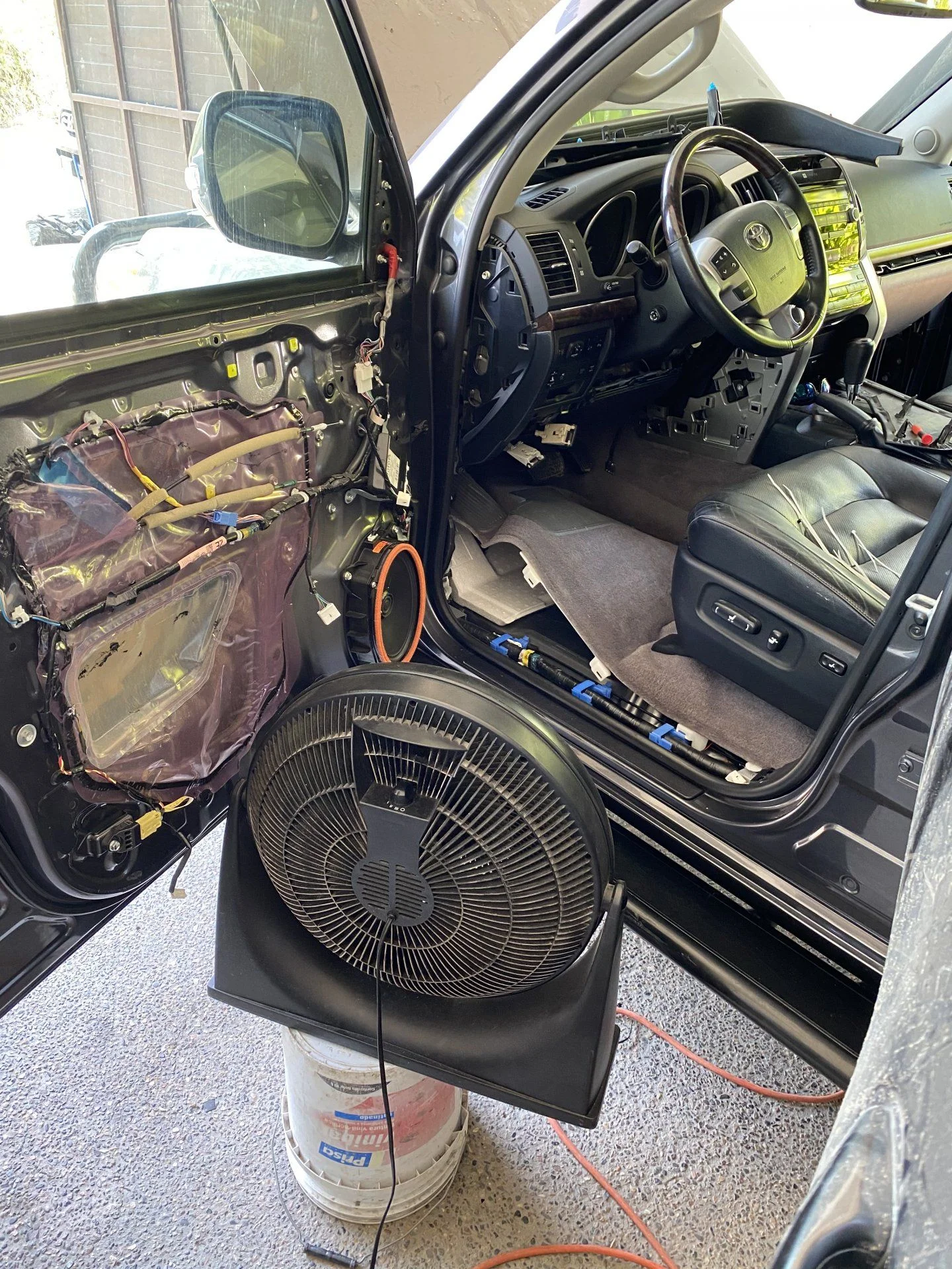

Day 3 - Fans on by day and dehumidifier by night. Still a bit damp in spots and a touch of smell, but not too bad. Connected battery just now and fired it up. No warning lights and everything seems to be working except the stereo. All display and functions of stereo seem to work. But no sound. There was some loud popping from speakers on occasion when battery was connected, but nothing constant. No sound from AM, FM or Bluetooth. No sound from voice command either. Ideas where to look for that fix?

Be sure to dry under that piece of styrofoam in the drivers foot well.
This is why I pulled glove box and the rest. To clean this s*** out.
The catalog shows a "COMPUTER, MULTI-MEDIA INTERFACE" under the passenger seat. That may have something to do with it.
Any place I can find that catalog you refer to online? And/or a diagram of that interface unit?
I use : ToyoDIY.com However you need a grandfathered user ID to see illustrations.
Here is an alternate:
