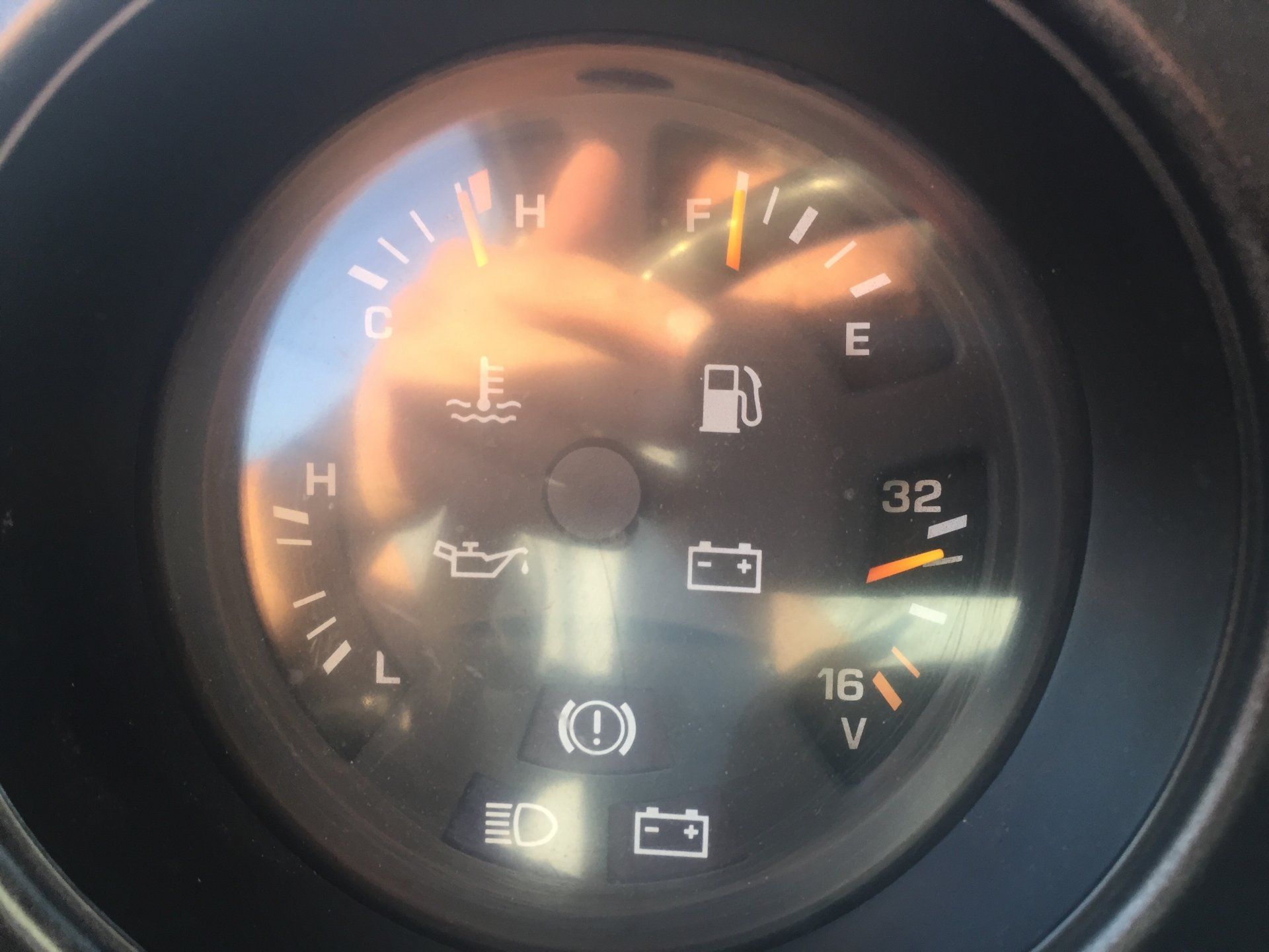

I do have a new problem- I nearly overheated while running 70mph or so on the highway for about 15min in 100deg temps this week. It ran fine, never skipped a beat, but as soon as I looked down and saw the temp, I pulled it off the road and parked in the shade for 30 min. Temperatures stayed low normal as usual as I carefully drove the last 10 min home after the cool down.
I'm assuming a clogged radiator, given how nasty the coolant looks. Need to drain it next week and get it cooked out, assess the thermostat and water pump.
You should probably put an EGT gauge on this.
