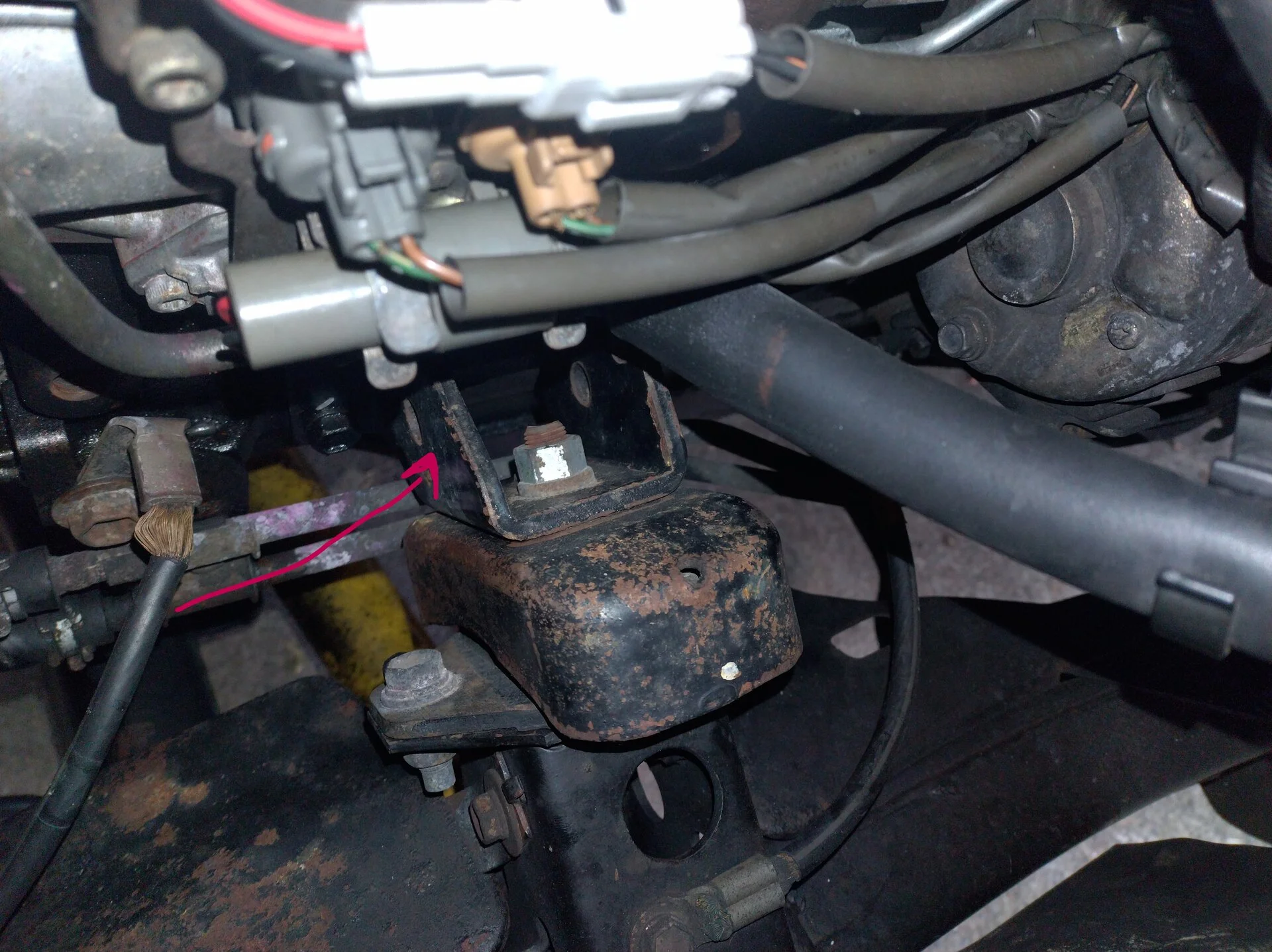

I have a question with regards to replacing the engine mounts on my LJ78 | 2LTE.
Do I need to remove the mounting bracket (4 bolts) indicated with the red arrow from the engine or is removing the 3 bolts enough to remove the mount?
Are there any other considerations I need to consider before jacking up the engine, i.e. exhaust mounting to be loosened, gearbox mounting?
Any guidance will be greatly appreciated.
I believe just the three bolts, but you have to jack/lift your engine up a bit to remove the mount then ( so the stud can slide out of the upper bracket ).
