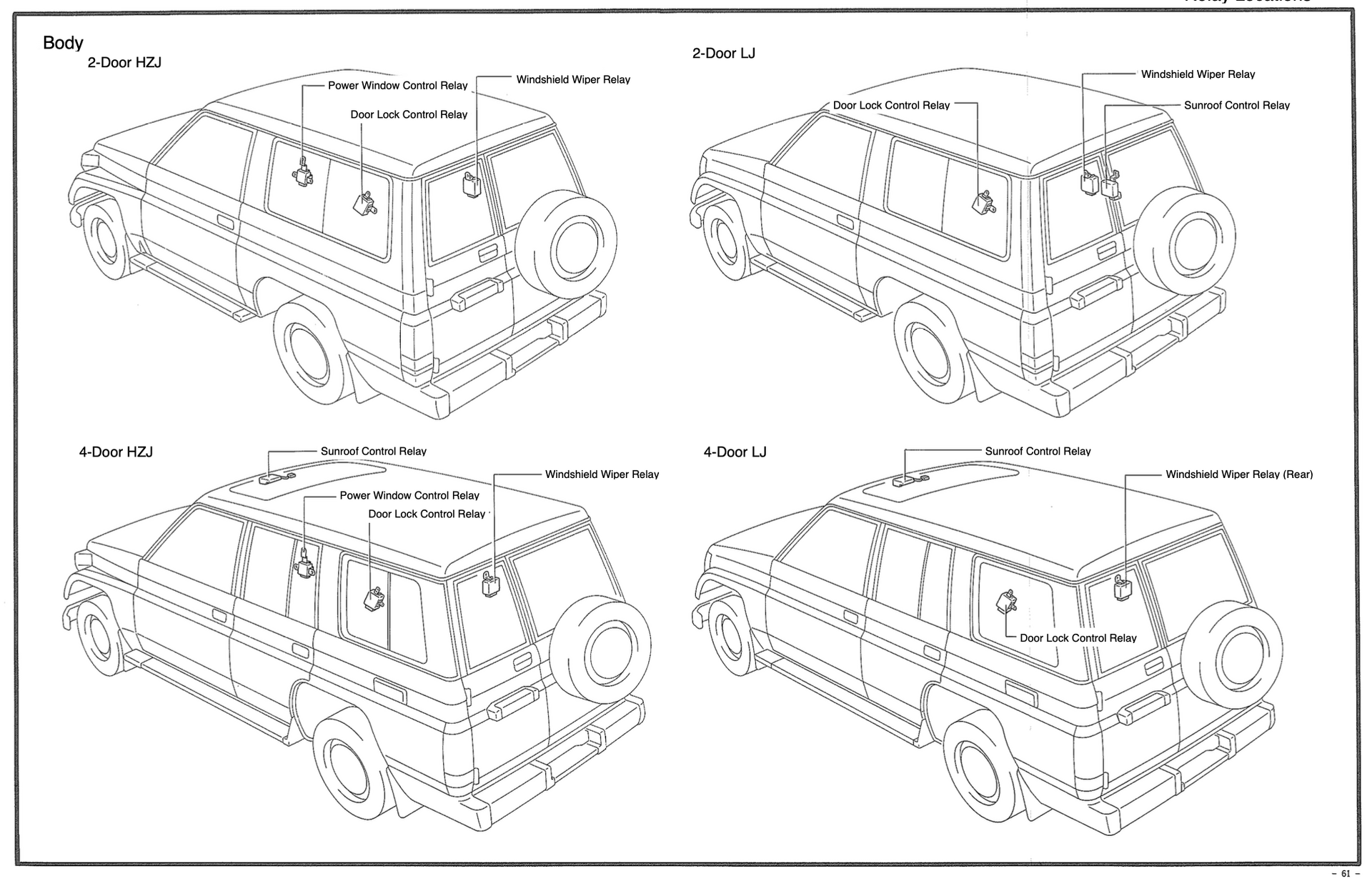

Anyone know what that box does and what that cover is actually for? Goes up beside the drivers head on the roof
The box is likely the rear window wiper relay:
The little plastic cover is for one of the interior temperature sensors for the inside/outside thermometer on the dash.
Thanks 👍 thought it was the relay for thoughs wipers. Makes sense why I didn't find anything under the cover as my truck doesn't have the temp display unfortunatly
I was wondering if models without the temp display had the covers or not, I guess that answers my question!
