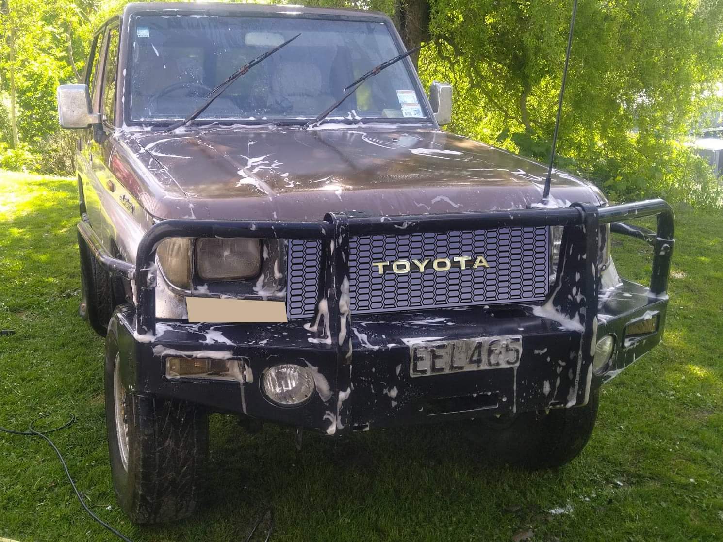

Did some mods to the bullbar aswell. Cut the old mounts off and started making new ones. I made the old mounts when i first got the truck when I was 18. Only had a couple bolts holding it and it would move when the scrub bars weren't bolted up, guess I was more worried about how the truck would look rather then how it worked back then haha. Pretty rough job glad I'm a slightly better welder now. I moved it back 50-60mm as it was a bit like a table on the front. Cut the sides down to give it a bit more clearance on the tires, need to get some more steel flat bar to weld on to the sides and to make the bottem mounts. Looks better I think
Also thinking about getting a custom grill laser cut and cutting the old plastic one a bit to fit it over top. I cut the guards off and ditched the trim under the grill when I first fit the bullbar and it left a gap about 50mm right along that realy annoys me. Probably should have cut it out of the bullbar and left the truck panels but I was young. Seen a few 80s and 70s with custom grills In Aussie that look good and it makes them stand out. Played around on Photoshop with a design. Il fab up some sheet metal to go under the lights to and paint them the same colour as the new paint. Got a mate who can get aluminium water cut for free so only cost me a piece of aluminium so worth a try
