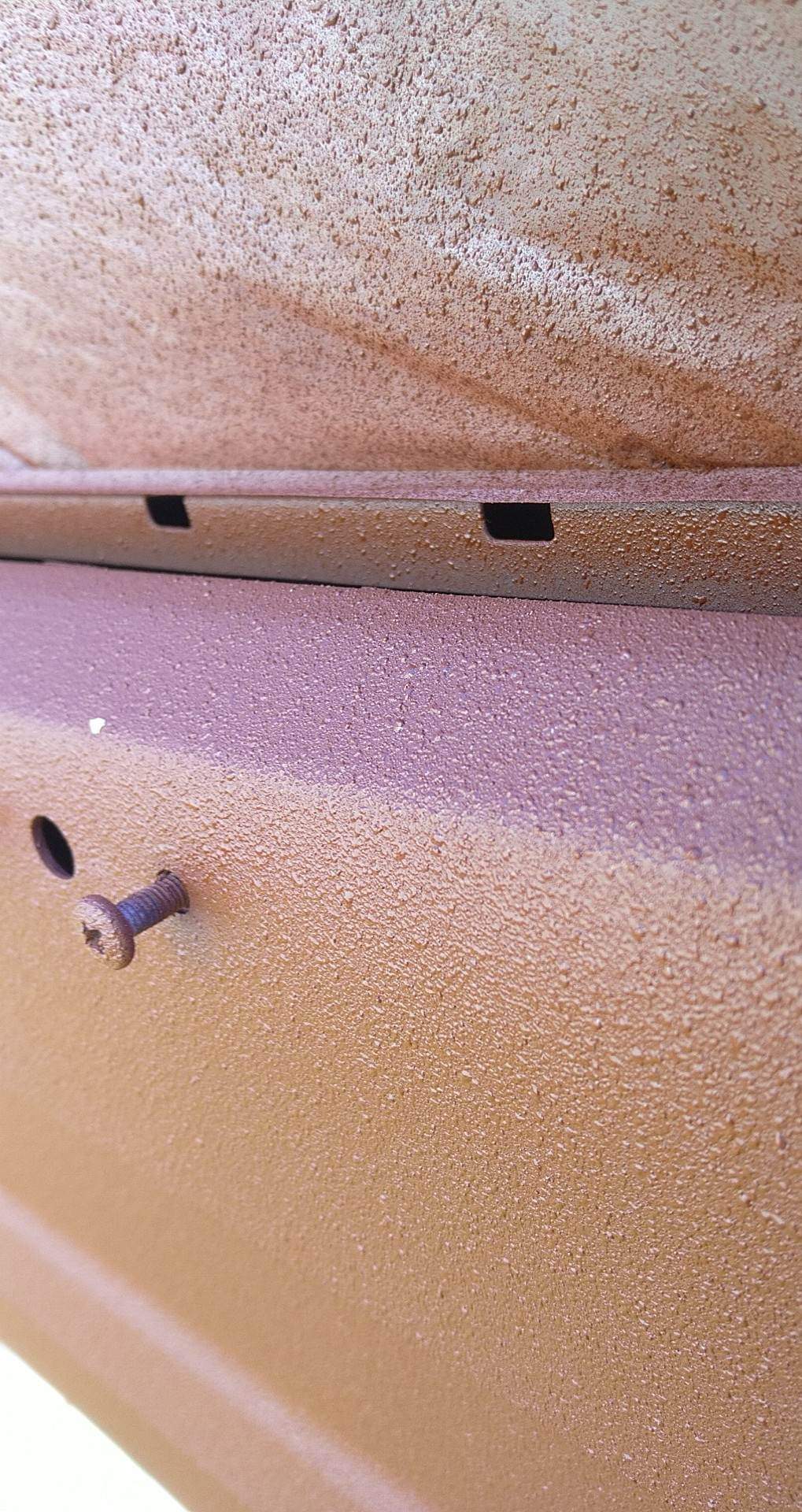

Been stripping it down to raptor coat it. Paint was pretty tired and clear coat was cracking bad on bonnet and guards, got a mate that raptor coated his l300 4wd and doesn't look to bad. Used to get scratched a bit in the bush so hopefully the raptor holds up a bit better, opened a can of worms stripping it back found a couple bad spots of rust in the roof that I had to cut out and replace. Couple bad spots on the rear quarter panels and the rain gutters arnt to great on the driver's side. Stripped it back with the wire wheel and por15 the hell out of it. Actually bent up the top layer and got it inside on the worst bit so hopefully it stops it. Had the roof liner off so sprayed all the edges with rust converter and have some penotrol to spray in there to and re did the gutter seals with seam sealed. Bloody pain to put it on with a brush didn't get a very good finish but the trucks pretty high so can't see haha
Primed the doors and bonnet and the windscreen wiper grill bit in the shed last night and got a coat of paint on it this morning. Texture looks good quiet thin which is what I wanted. Tryed drilling out a gravity gun tip to 2mm but couldn't get it to spray and had already mixed the raptor so only had limited time to muck around with it as it starts going off and I'm far from experienced with spray guns so used the 1.4mm I sprayed the primer with. Gave a nice texture but bloody slow. Might try filing the edges of the other tip as the drill bit burred them out a bit which might have something to do with it? Started sanding the roof but it's been raining for about a month here so that only lasted 10minutes as the sheds takin up by the other panels and the cruiser only has about 5mm between the roof and the rafters even with the tyres deflated 😂 going to do another coat on the inside door edges when I paint around the door part on the body (the name of its slipped my mind) and then bolt them on and paint another coat over the whole lot so it matches up
Got the paint job done, Christmas day spent painting between opening presents with the misses and baby and Christmas dinner.. you really see the damage 30 years does to the paint. Roof had heaps of stone chips that had rusted under the paint. Grinded it down and rust treated it before primer. got sick of the gravity gun cause it kept clogging up with the raptor and couldn't get it down fast enough. Had one of the raptor shutz guns and it put it down a bit rougher and thicker so should be heaps tougher. Think I like the rougher texture more looks tough and hides the crappy old paint and prep work haha Now to get it in the shed to cure

Paint looks super orange in photos for some reason but it's actually quite dark brown

Looking good bud! LOL - I did notice you had to let air out of the tires to get it into the shop to work on!! Hey whatever works! :cheers: Did you actually spray the body outside? How did that work? I am guessing you waited for a calm day. I suppose the raptor paint would hide any dust as well, so no biggie!
dropped the fuel tank that was full of gas out to clean up underneath and had to put strops between the back axle and the chassis to get it down more to get it in 😂 Yep sprayed it outside. Turned out pretty good. Raptor defiantly hides the imperfections. It's not for everyone I guess but for a older rig that's going to get scratched I reckon it's perfect. The dust just adds to the texture. it had rained the day before and even with the primer it still came out clean. It looked pretty good in grey to
