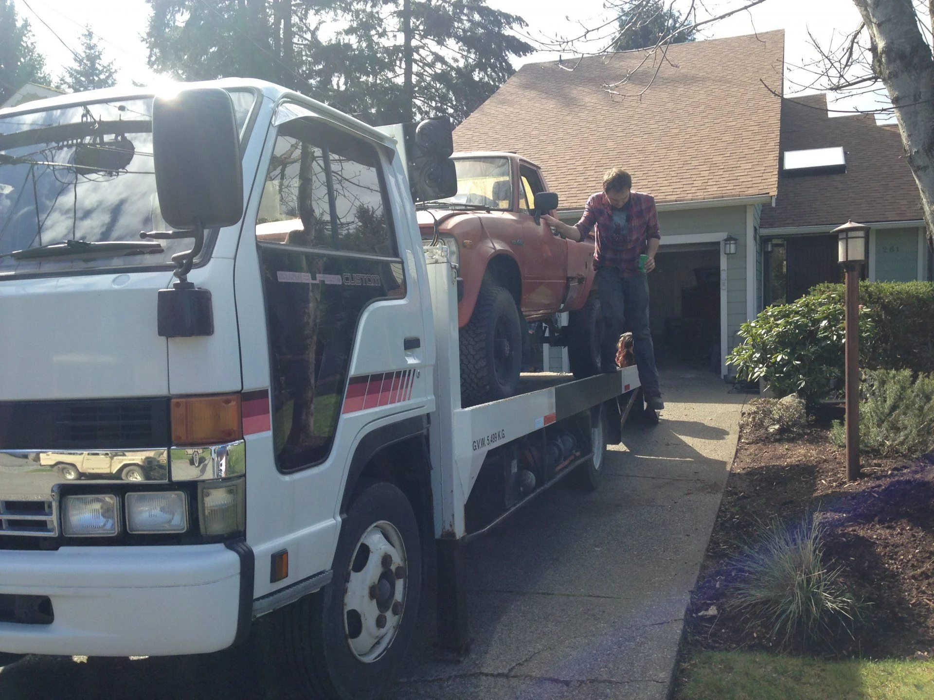

Graham had a bit of help from some good friends, his plan for splicing the frame with insert went very well, I was so impressed how well it fit just using a couple measurements and a couple of eyes... Couple of blurry pics of us at the pub..
Got to be one of the coolest car haulers I have ever seen...Graham is going to do more of a restoration and not paint it with a roller or spray bomb...It will be nice..

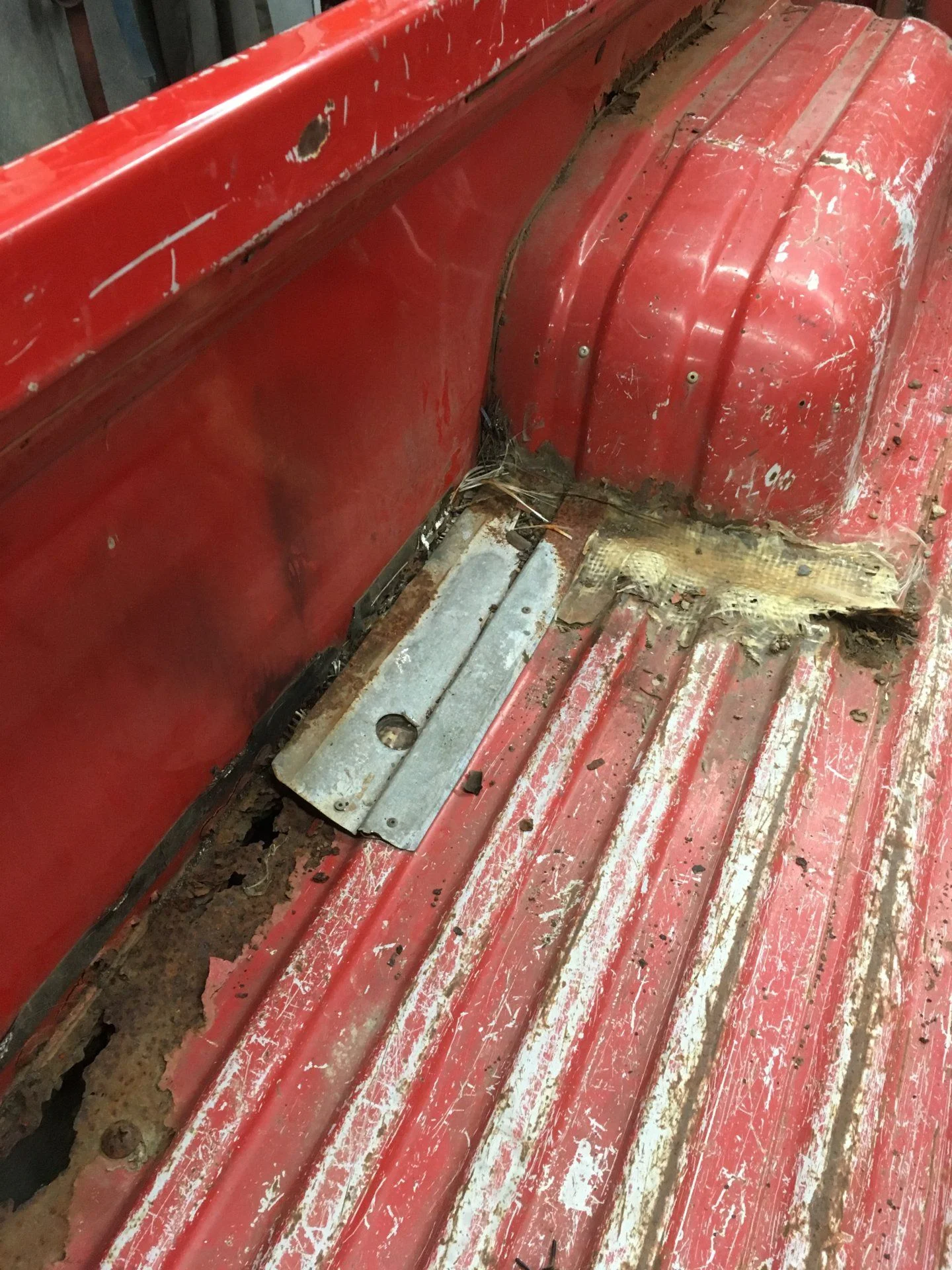

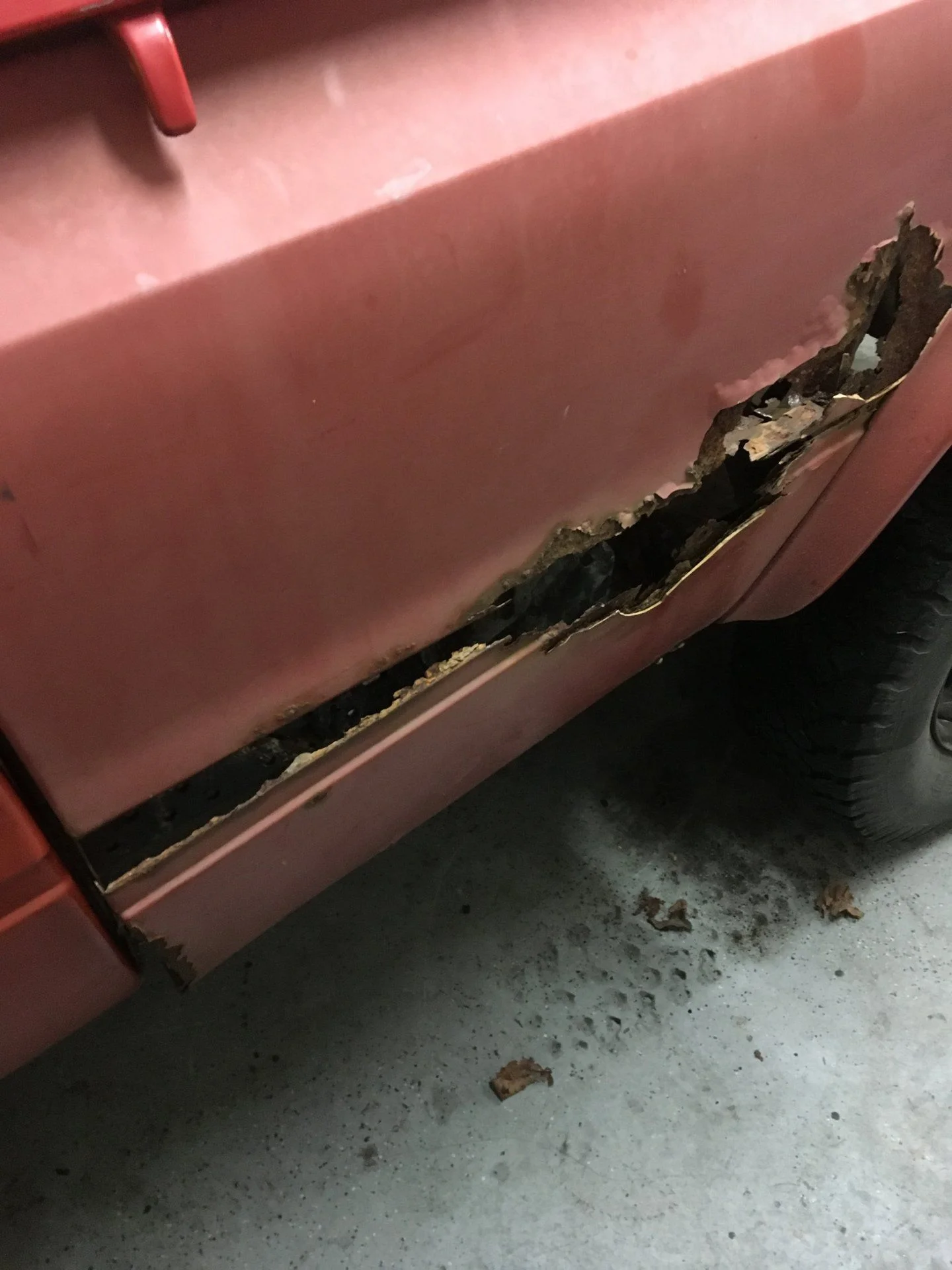

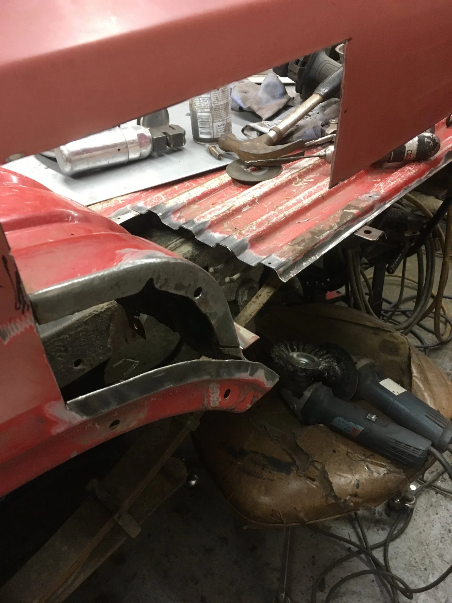

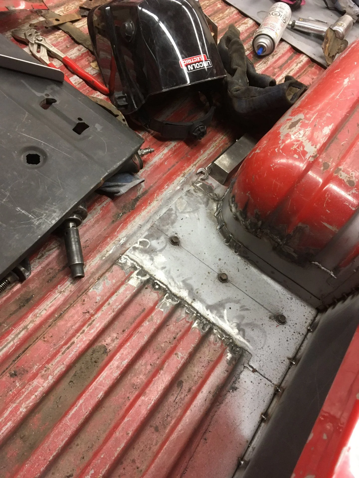

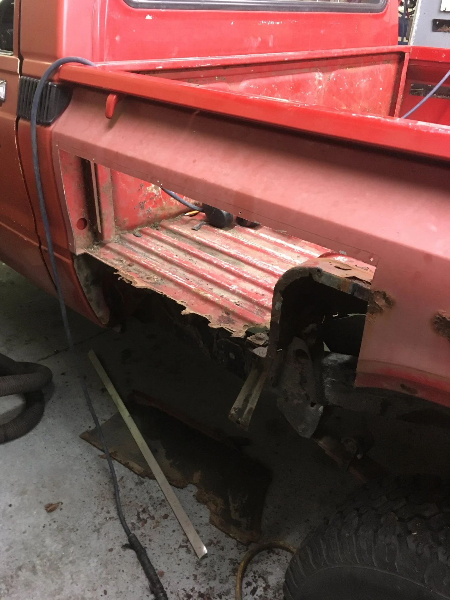

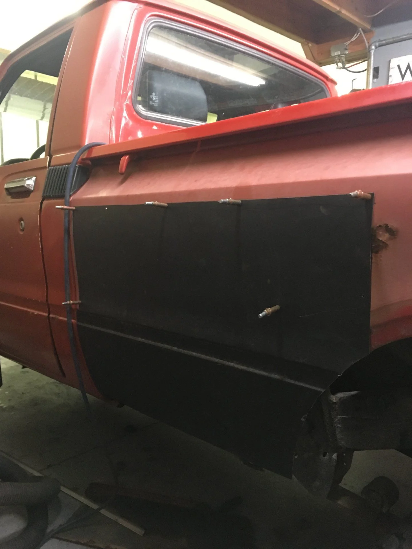

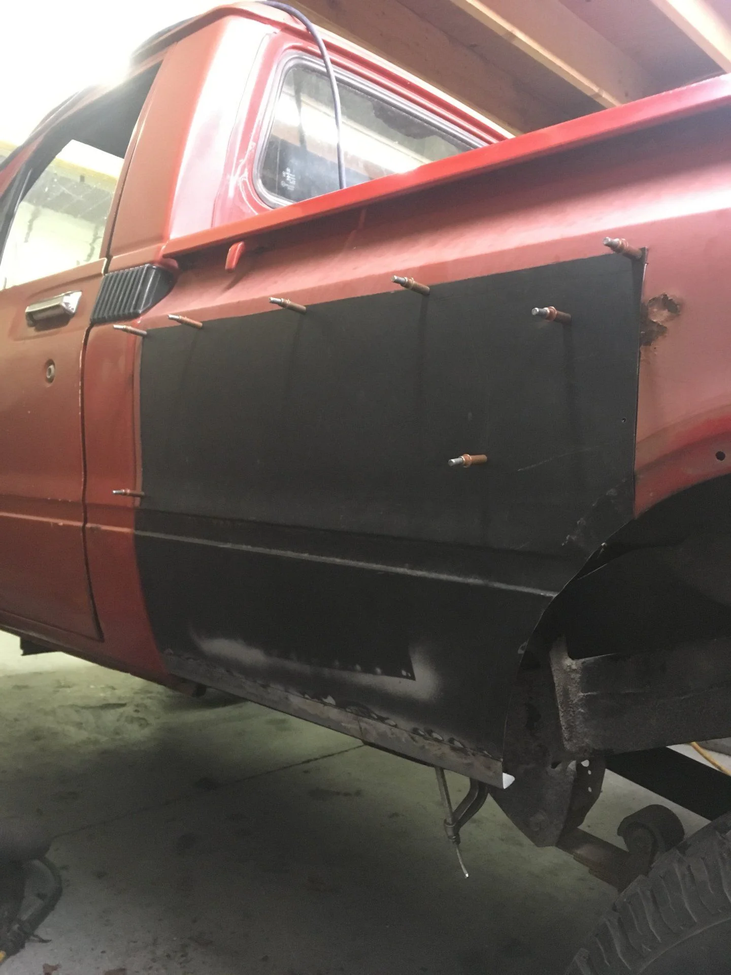

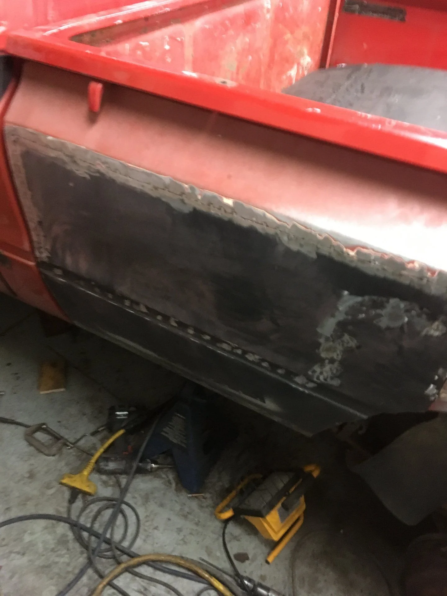

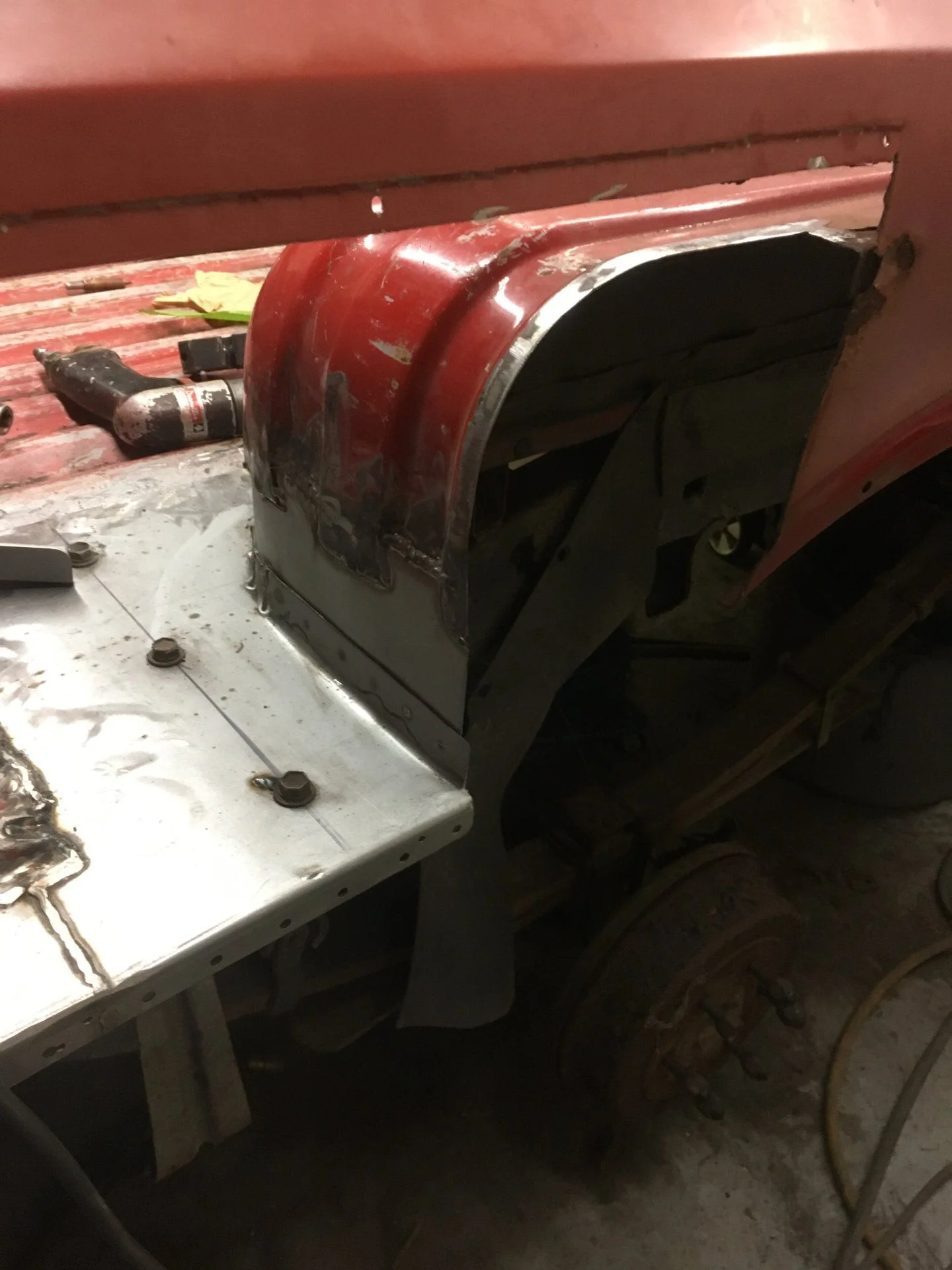

I could do that. Not too much to update yet, but I did pull it out of storage to start working on it. Spent about 3 hours on it so far, starting the rust repair on the box. I'm using door skins to make the body line on the box. Finished one forward outer panel, and will work on repairing the bed floor in that area next. Pretty happy with how it turned out so far.

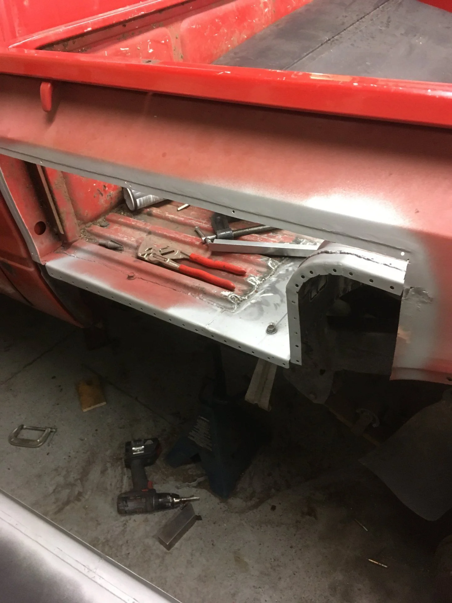

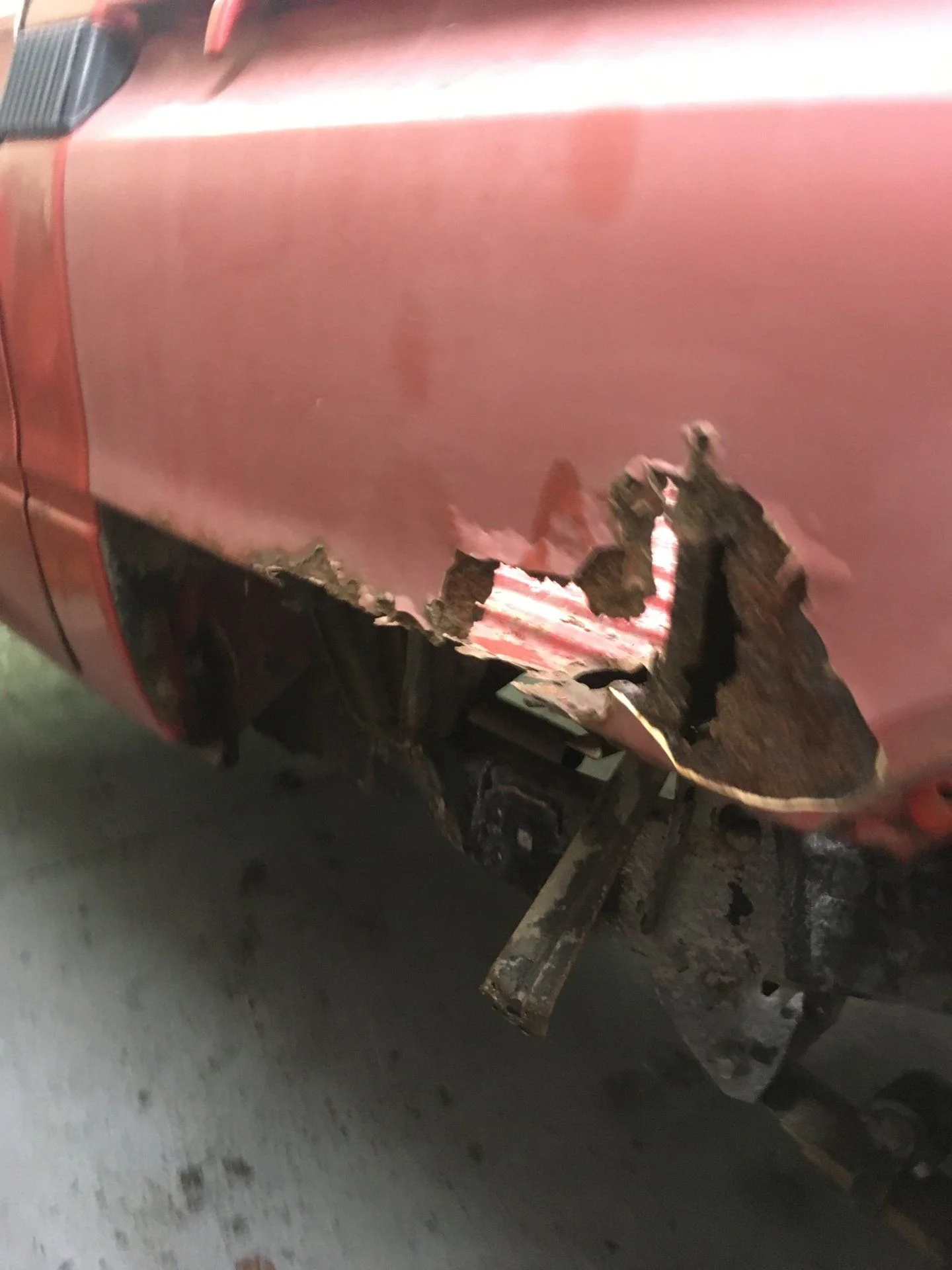

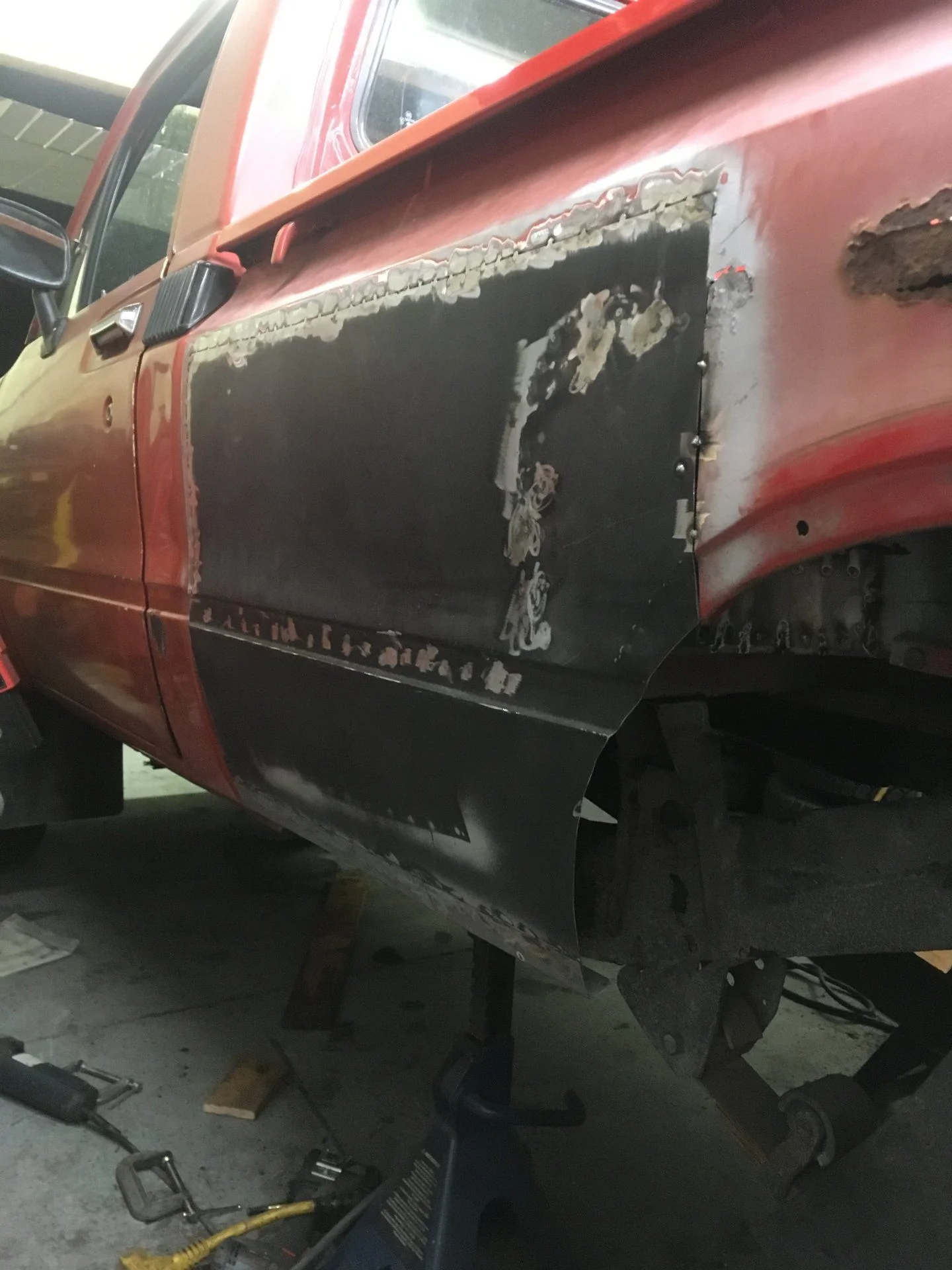

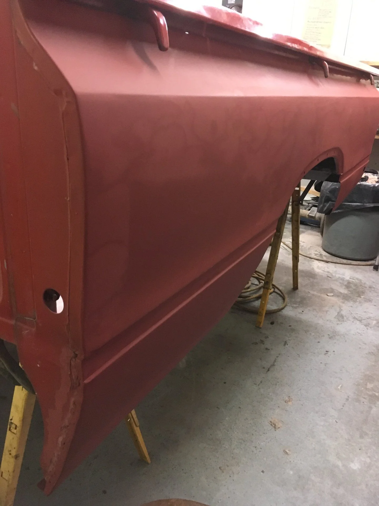

Bit of progress on this. Basically finished the left side of the box. I'm pretty happy with it, Although It took a lot of hours to get the filler reasonably level. Still a couple areas I could touch up, but for now it's on to the right side. Which was the "good" side. Not that it will need much less work :rolleyes:
