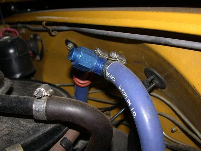

I use this setup with a water hose to power flush the head from the back of the engine with the bottom radiator hose and cap removed/disconnected. I use this after running a strong flushing agent that is compatible with the engine and radiator. I also remove the coolant plug in the block on the driver's side.

That's a great idea, bsevans - where'd you find that part?
I made it from a Russell AN tee. I turned the two legs to fit 5/8" heater hose with a lip so the hose could not slip off. You can find similar plastic ones made by Preston at most automotive parts stores.
Awesome, thanks.
