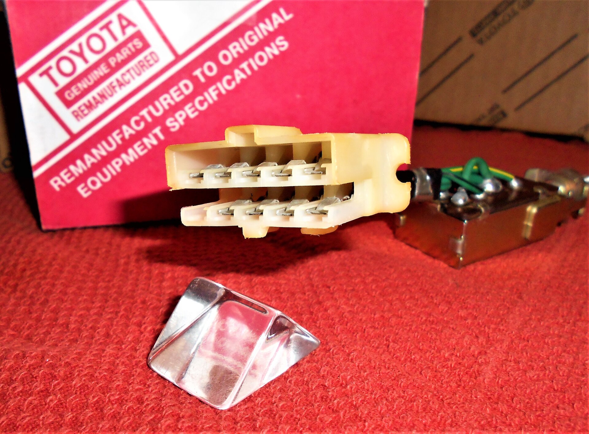

This topic below is my 2nd Technical Suggestion to inspect , confirm and verify ,.,,
- the 1975 HAZARD SWITCH has UNIQUE and well someway flawed design feature after say 25-50 + years where dust , age and time will cause your exact symptoms , the GETTING WARM quote abober in YELLOW ink , i missed last night , sorry ....
- but , focus on this details below ,
- remove your POS/ Batt Cable 1st step , DO NOT overlook this safety topic , PLEASE !
- see tech images below , should be self explanatory , and YES you need to remove the HAZARD switch from dash completely ,
- via ash tray removed access , and or cluster meter removed access , its in the center and so is your front heater box , so NO under up access .....fyi
THIS IS THE WAY ..

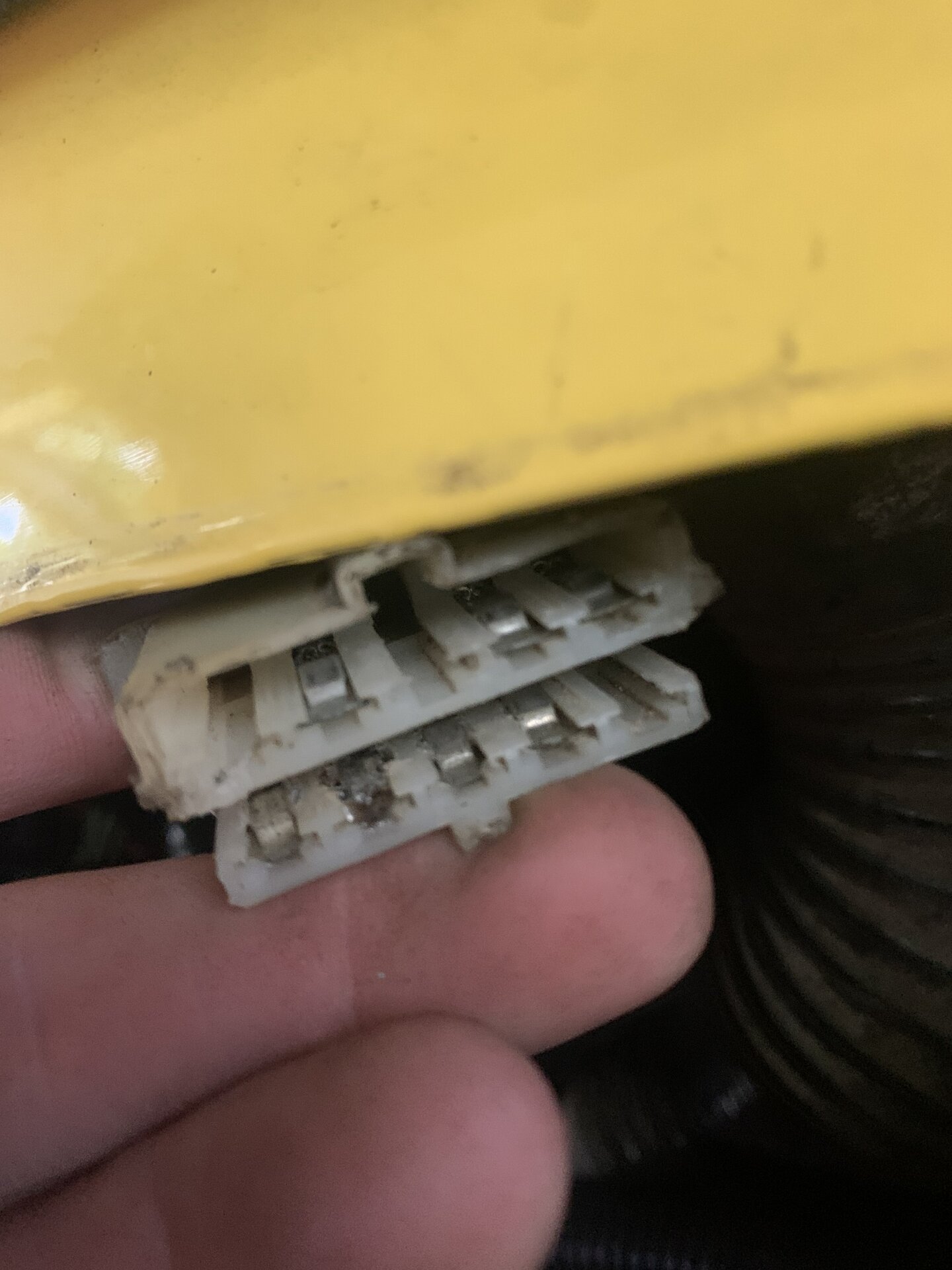

Thank you all for the responses. Here’s a status update.
I installed the new hazard switch without resolution. There is a picture below of the wiring harness with a little corrosion. Do you think that’s enough to cause the malfunction? If so, I haven’t been able to clean it off. Any ideas where to get a repair kit?
Also, I pulled the fuse box out, cleaned all of the connections and put new fuses in. The brake lights and horn are working now but one of my fog lights won’t come on and I managed to kill the battery. So I’m going to charge the battery and see where I stand before working on anything else.
Here’s the pic of the harness. The old hazard switch had a matching area of corrosion. Second pin from the left on the bottom row.
Yes that's exactly the problem.
Just fold up a piece of fine sandpaper and sand it gently - add some wd40 to wash it out.
Extracting terminals is better if you feel confident but otherwise there's a risk of breaking them.
Check you have continuity across both slides of the connector
