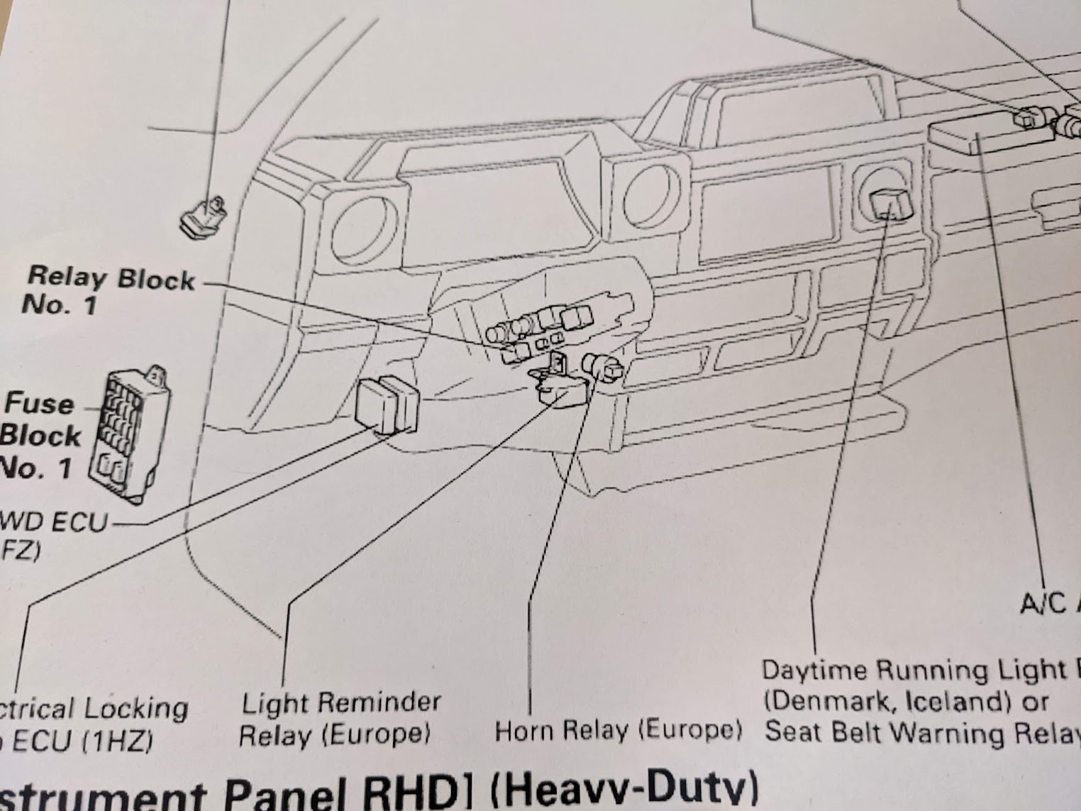

My 1995 HZJ75 has a "Light Reminder Relay"
Can someone explain what it is supposed to do... and since I'm pretty sure mine is doing nothing please explain with enough detail that I might have a shot at getting it to do its thing!

Based on that drawing it's pretty clear. If a door is open or a light is on it dings. And my HDJ81 doesn't ding. So now I have something to investigate. Sweet.
That's exactly what I think should be happening but it's not in my truck either. I have yet to find someone to tell me that this works in their rig.

Where is the location of that relay in the truck? I would like to get mine working as well. I have left the headlights on quite a few times.
Lights ON
Key OUT of the ignition
-> buzzer may buzz
Lights ON
-> buzzer may buzz

Just looked under my steering wheel where it should be right next to the reverse beeper (which I disconnected last month). Nada. Looks like a Euro spec item per the diagram above?
