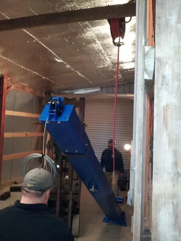

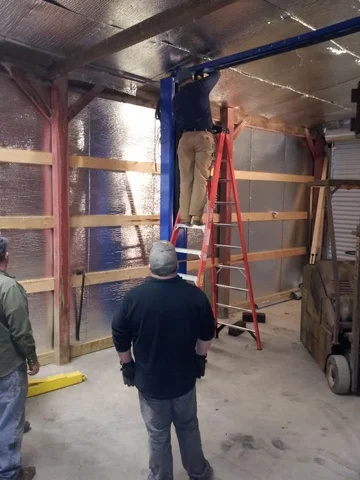

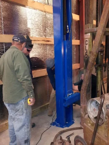

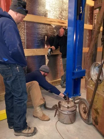

As we arrived we found Roger, Spot and Todd ready to work. The first step was to precariously raise the power side of the lift with one of the first stand up propane operated fork lift ever made. It went pretty easy and we found we could walk it into position easily. Roger had rented a massive hammer drill and what we though may take the longest - drilling six 3/4" holes in concrete per lift, turned out to be the easiest part. Todd hammered the anchors home and we took turns torquing them in place.
The second side - the slave side was easier as we were becoming confident with our new found skills. Next, I attached the crossbar and then Todd used his long forgotten high school geometry to figure out of the the two lift sides were in fact square with on another. We then drilled another six holes, slammed in six anchors and torqued them too. Just a bit of shimming was needed to ensure the sides were even and true.

We all returned to the lift install except MH who had brought a book and was feeling a bit like she might be in the way. We mounted the motor and I put gears on the lift legs. Then it was time to play with electricity. We all shared stories about being sent flying across a neighbors yard or two when either touching, spitting or pissing on something hot with live wires as Andy continually stuck a metal screw driver into a circuit breaker box that had been recovered from a pig shed older than I am. Eventually, after some wire pulling, balancing on a forklift and doing some moves you would only see in Cirque de Soleil (and some beer) we got the wires run through the pvc conduit and to its destination. Andy impressed us with his abilities and it was now time to bleed the system.
1-2-3 nothing. No juice. I asked who wired the service and Andy refused to respond with anything other than a look away. Although Todd was quick to through him under the bus. After some multi-meter work, it was discovered that the breakers were misplaced in the box and - TAA DAA! It all came to life.
We all watched as Roger and Todd squirted ATF all of the new garage slab while forcing air from the sytem and joked about how Larry would have had a heart attack if this had happened on on his new slab :flipoff2: Up and down and lots of squirting - had some beers - now its a party!
