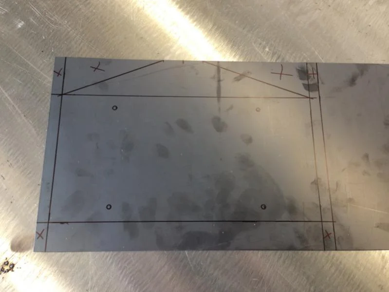

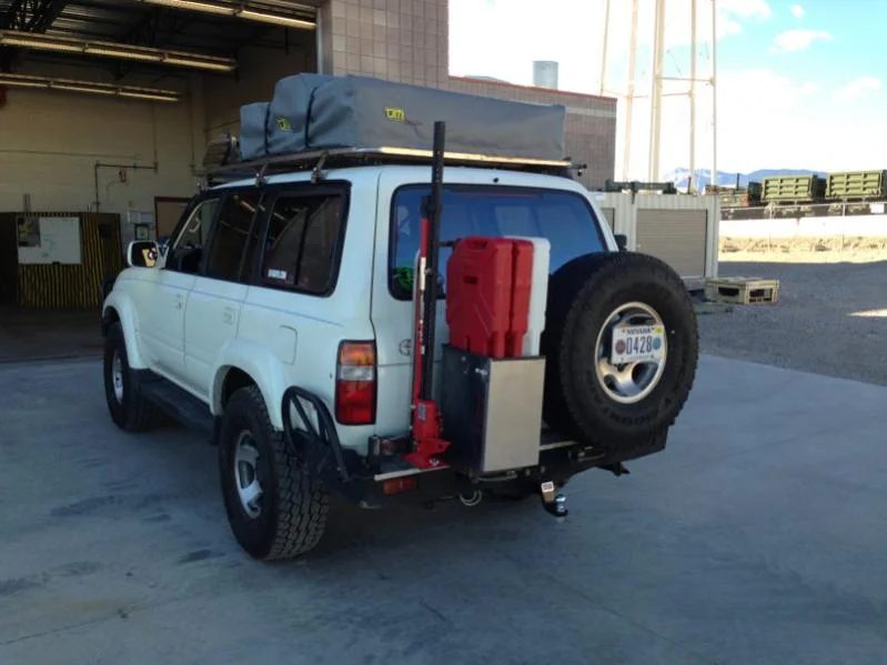

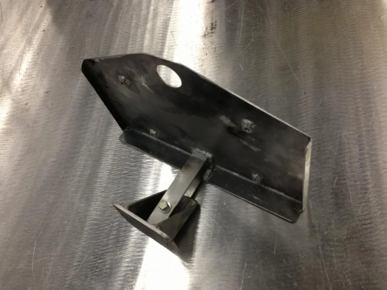

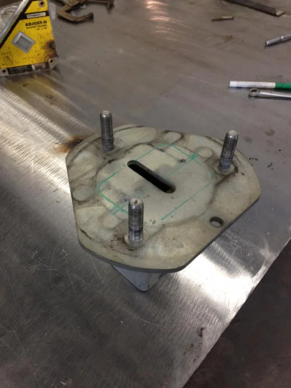

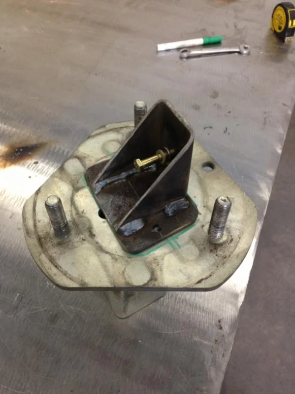

My 315 sized spare on my Kaymar swing-out rear bumper almost completely obscures my license plate... So I made a new plate mount with light.

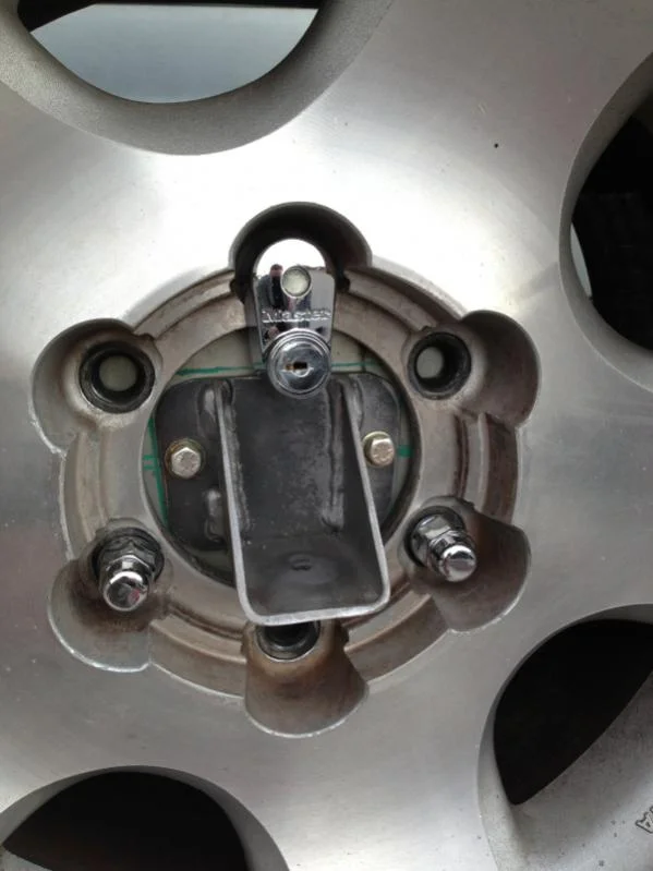

Do you have to remove the plate to get to the spare tire nuts?

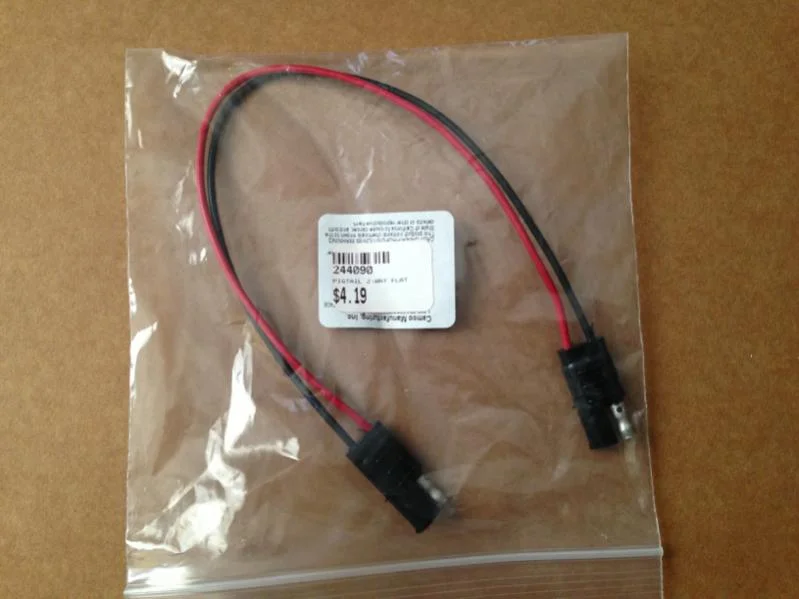

Light will be hard wired to 12VDC. I will install a weatherpak connector inline to allow for quick disconnection.

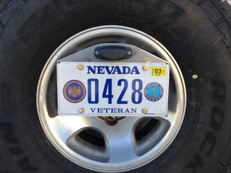

Yes plate has to be removed to remove spare tire. Plate assy. is held one with a single 1/4x20 bolt for easy removal. (See pics) I may install some kind of wing nut/bolt to make it tool-less.

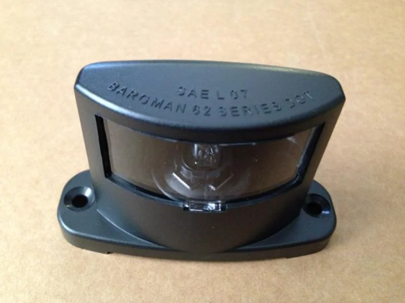

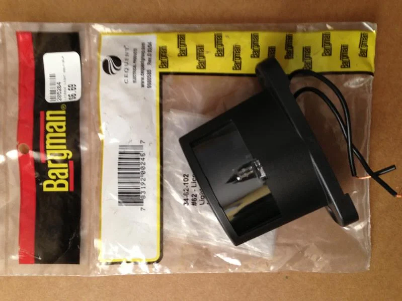

1st design improvement. I did not like the way the first license plate lamp mounted nor the fact it did not have a ground wire but grounded through its physical mounting. I like this lamp much better. Light is directed down over license plate.
Here is the coupling I'm putting inline to quickly disconnect the light when necessary.

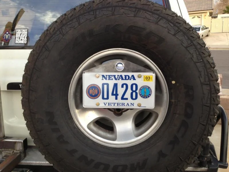

I made the latest version of the license plate mount today. I like this one much better.
