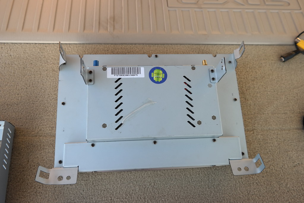

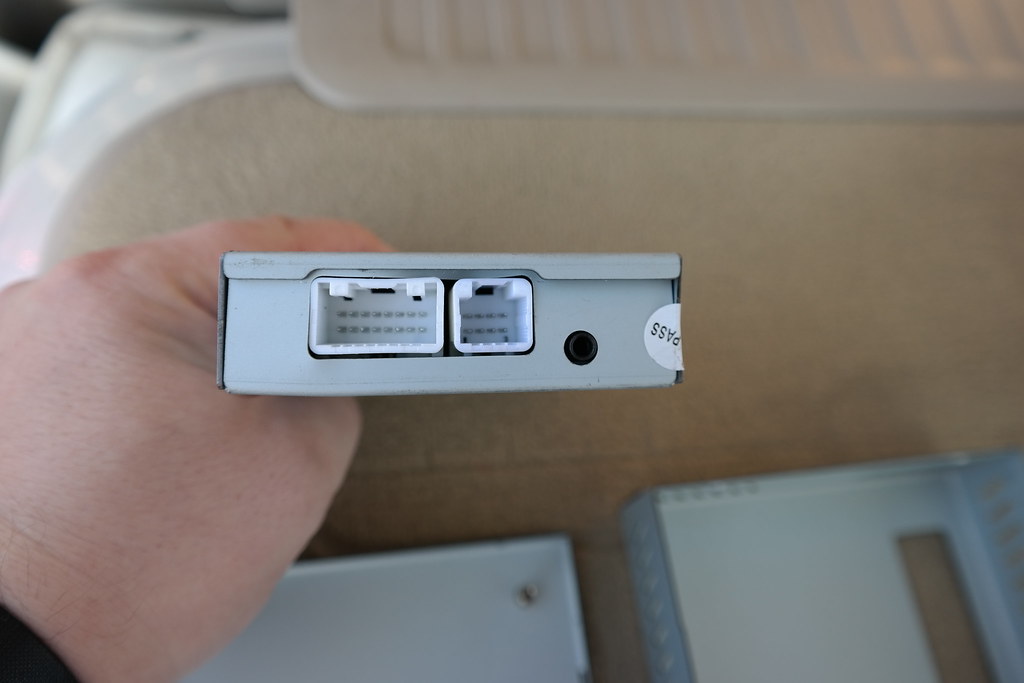

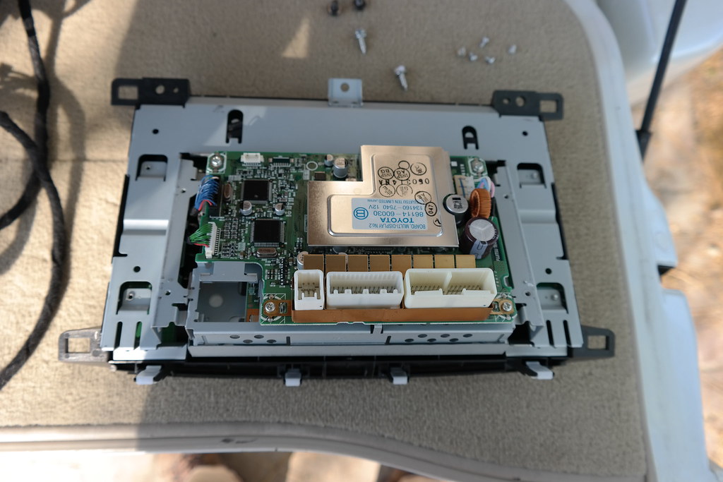

Hit a snag as I don't know what board is suppose to go in the supplied box.
Box:

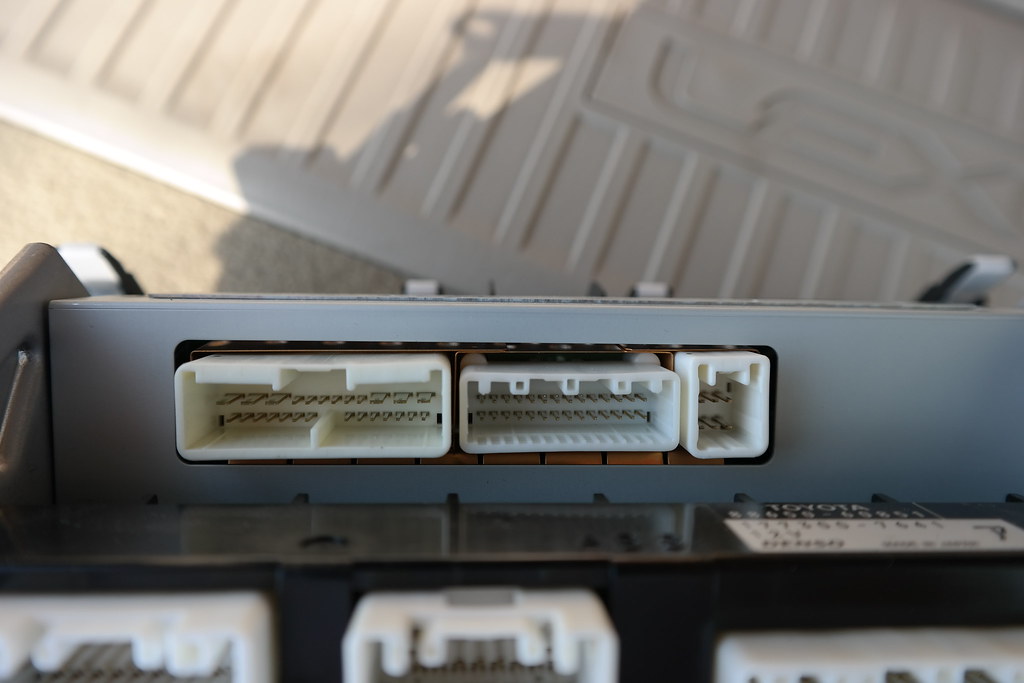

OEM navigation board connectors:
Board:
The board does not fit the box. The cutout is on the wrong side (could be the box is bent upside down. I do sheetmetal for a living and this is a common problem). The holes also do not line up with the standoffs.
I am actually not even sure that is the correct board for the box, but I can't imagine what else I would put in there.

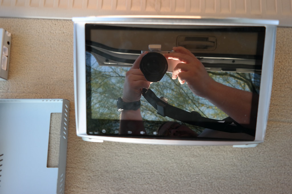

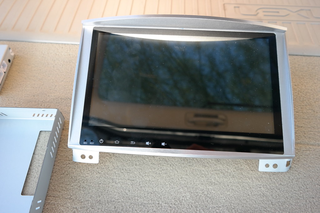

Here is the business end. It is very glossy and has quite a bit of glare:
The top of the screen is machined aluminum. It is screwed on and was a bit loose. I tightened it up and it was fine. The surround is made of what looks like die cast aluminum. The mold needs some work in the bottom corners, it isn't completely smooth. I have not fully installed it in the dash to check fit, but it does have some movement so you can adjust it.

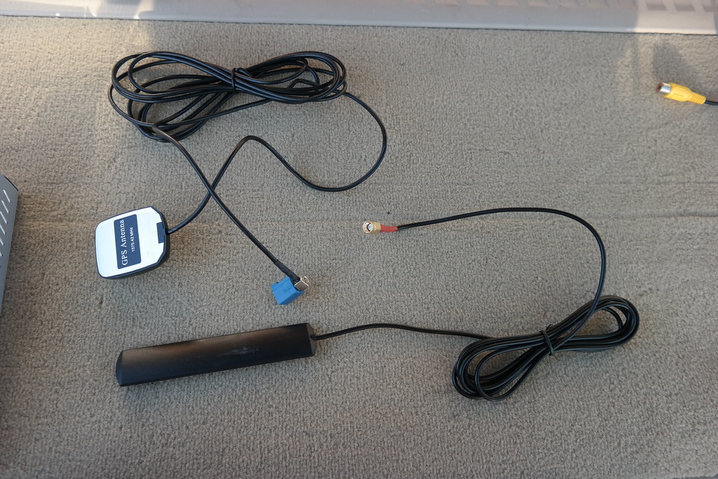

GPS and Wifi(?) antennas:

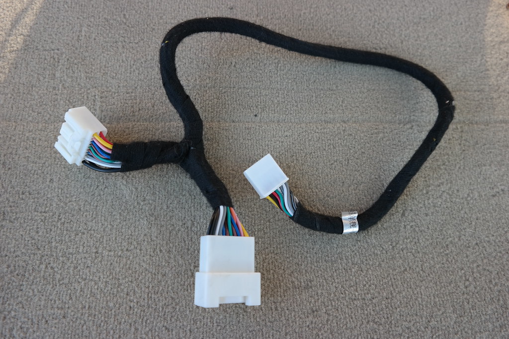

Main wiring harness that taps into the tape deck:
It is wrapped in a fabric tape. Not my favorite wiring covering but it seems to be pretty good quality.

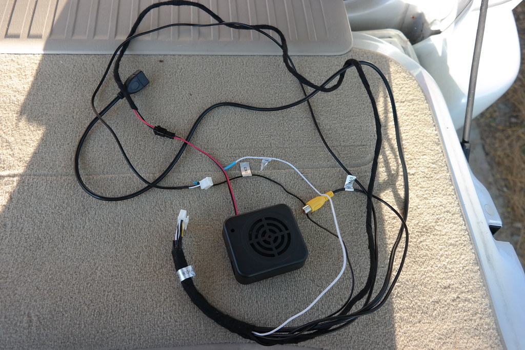

"Nav speaker" and DVR harness:[/URL]

HVAC controls work, sort-of. No auto it seems, no polling the outside temp either. I'll have to look into why, but I suspect it is looking for the wrong pin or that function may be on one of the other nav boards that did not get carried over. The nav board does not fit into the supplied box at all. I will have to home brew something. I am unsure why mine is different. It is not the box, the cut out is not even the correct width to fit the connectors.

The extremely glossy screen is infuriating.
