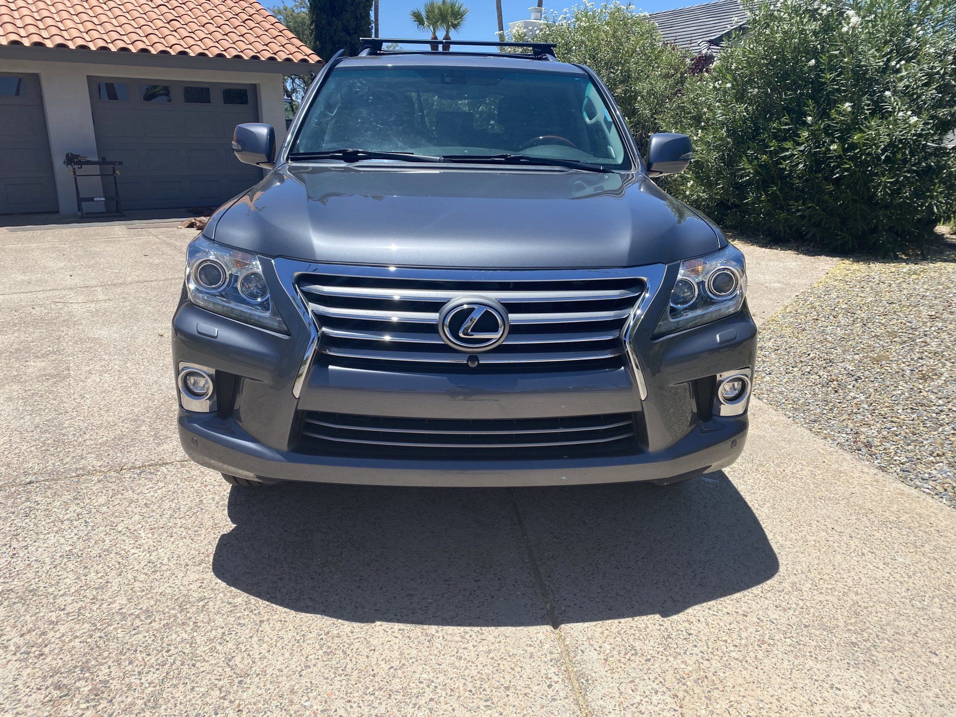

Here is a recent photo of my 2015 Lexus LX570. I am the original owner and am about to embark on a few customization to make it more enjoyable in the outdoors.
Here is my starting list of the things I plan to add / modify in the next month. Please let me know if you think any of it is crap and a bad decision. I am a "novice" when it comes to off-road / overlanding.
