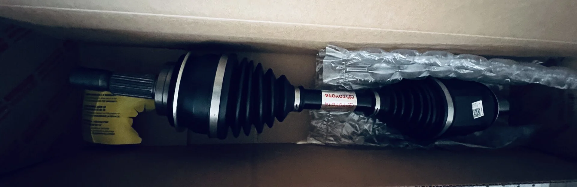

Got my Toyota reman cv axles

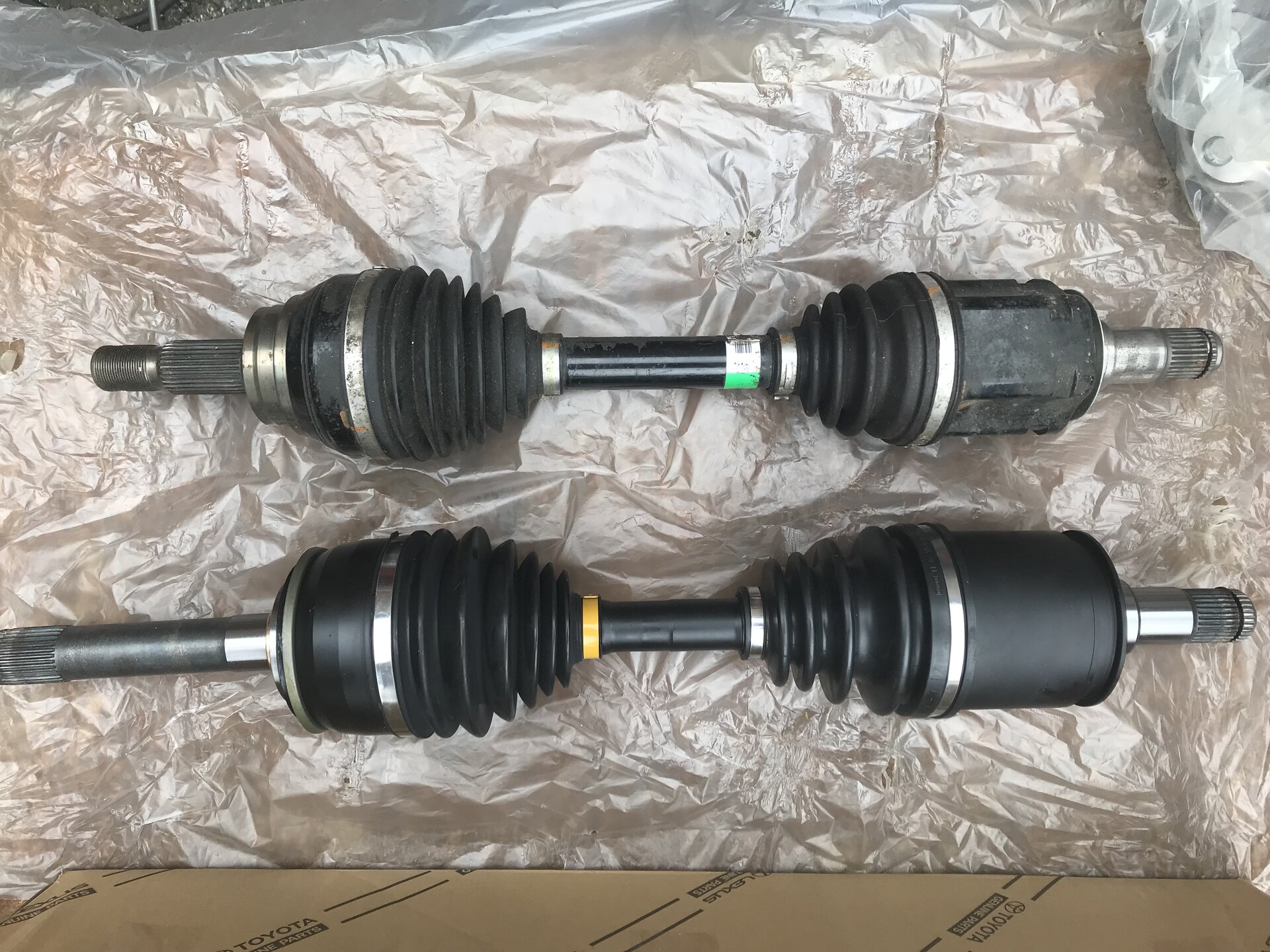

There are several ways to tell. The easiest is the inner axle cup often has different shapes and indents vs oem. and the axle shaft on non-oem are usually raw metal. CVJ and OEM are often painted/coated and usually have a sticker unless someone removes it. The outers are harder to tell but diameter of the bell can vary and the non-oem are usually smaller. A lot of people mess up the inner boot as the tulip shape of the cup needs the booth to either be OEM or you need to keep the OEM boot and cut the tulip part out and put it in the new boot or it won't cinch onto the axle and cause a mess.

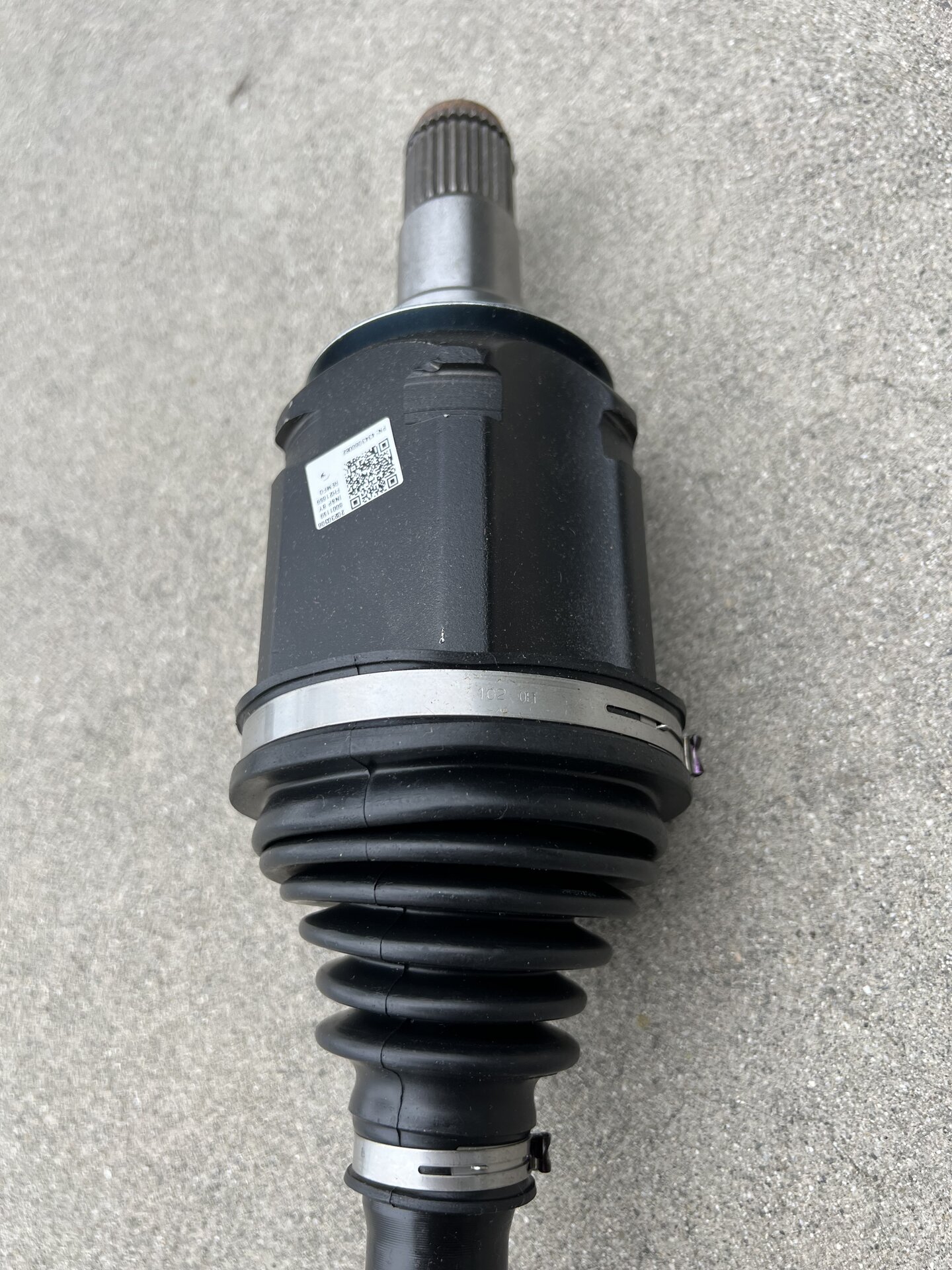

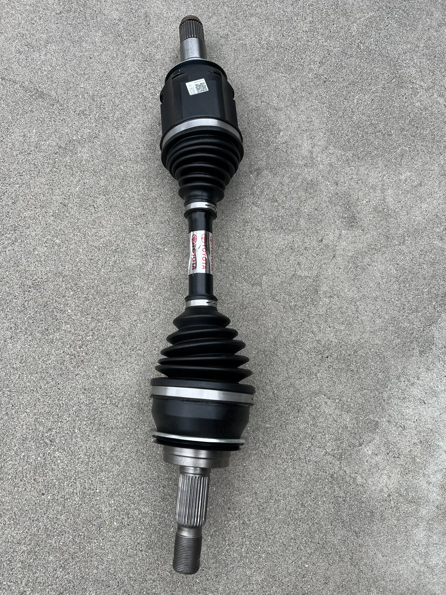

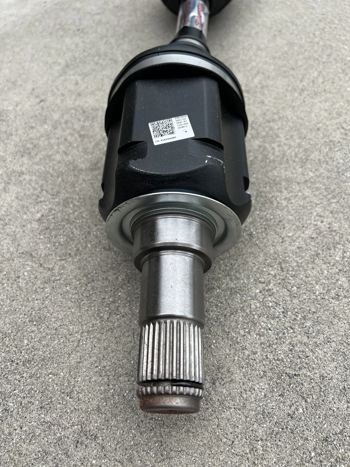

I happen to have a cv axle handy…reman from Toyota dealer.
Maybe put pictures to Dan’s words
Good pics. A non OEM will look totally different and not have the same notches on the differential side that allow a slide hammer to be used for removal.
