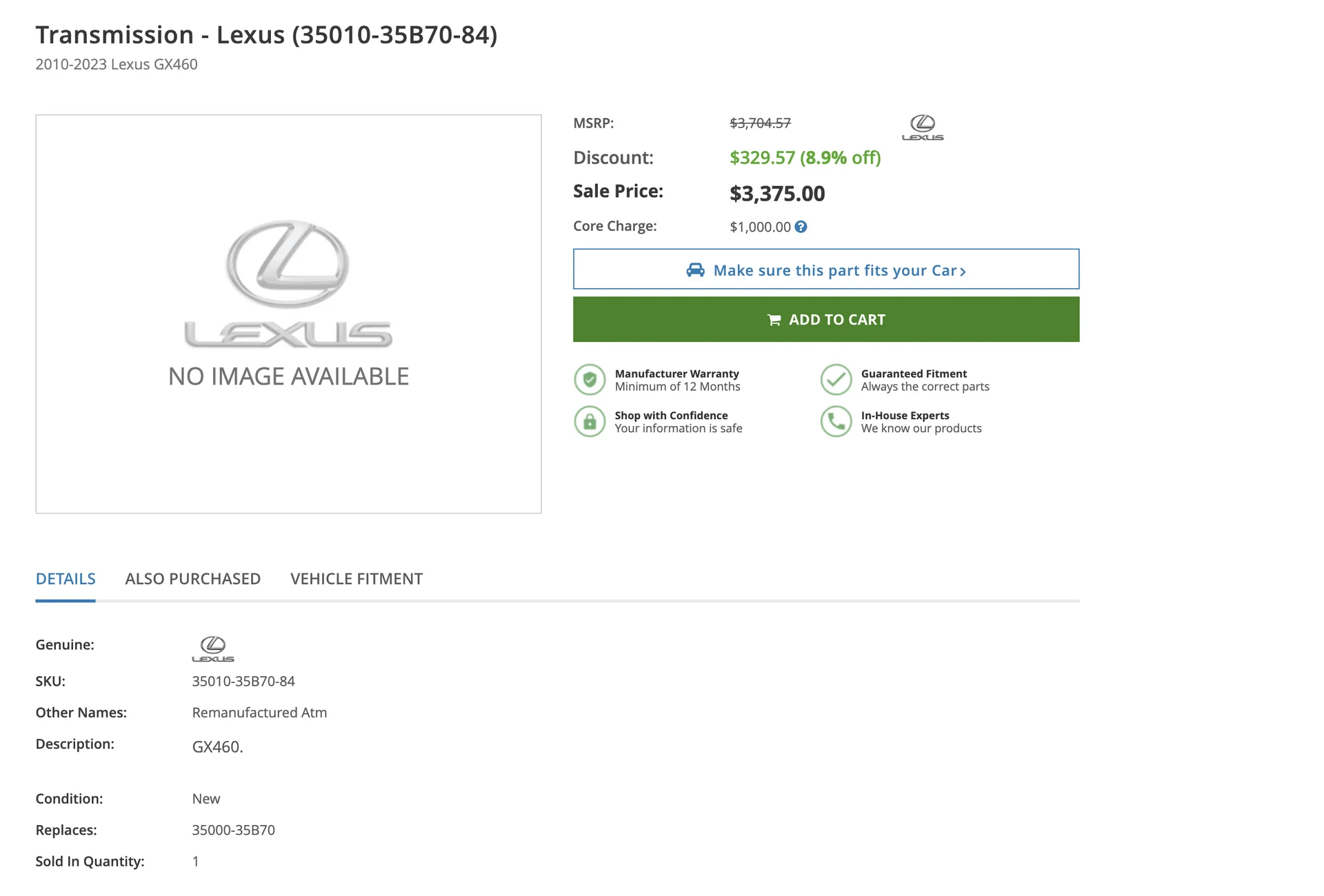

•• I am told transmissions are back in stock
PN:
35010-35B70-84
