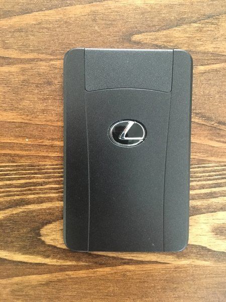

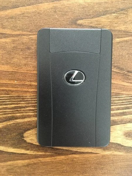

I had an older Lexus credit card style fob that worked great on my 2011 (range was OK, but wqs nice not carrying key around. Sometimes had to touch door a couple times to get it to unlock). Unfortunately it would not program on my 2016 LC.
I ordered Toyota part 89904-53512 from Norfolk Toyota and it successfully programmed using Techstream. I also purchased a key blank for the and had it cut locally.
Works MUCH better than the older CC remote I had on my 11. Senses very well, must have a better antenna. Highly recommend if you want the convenience of having your key in your wallet.

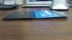

Any chance you post a thickness comparison next to a credit card (or harmless equivalent for a photo)?
Curious, since thickness would help me decide.

The thickness is roughly the same as 2 credit cards. A pretty nice upgrade. (Online pic from a tacoma forum):
