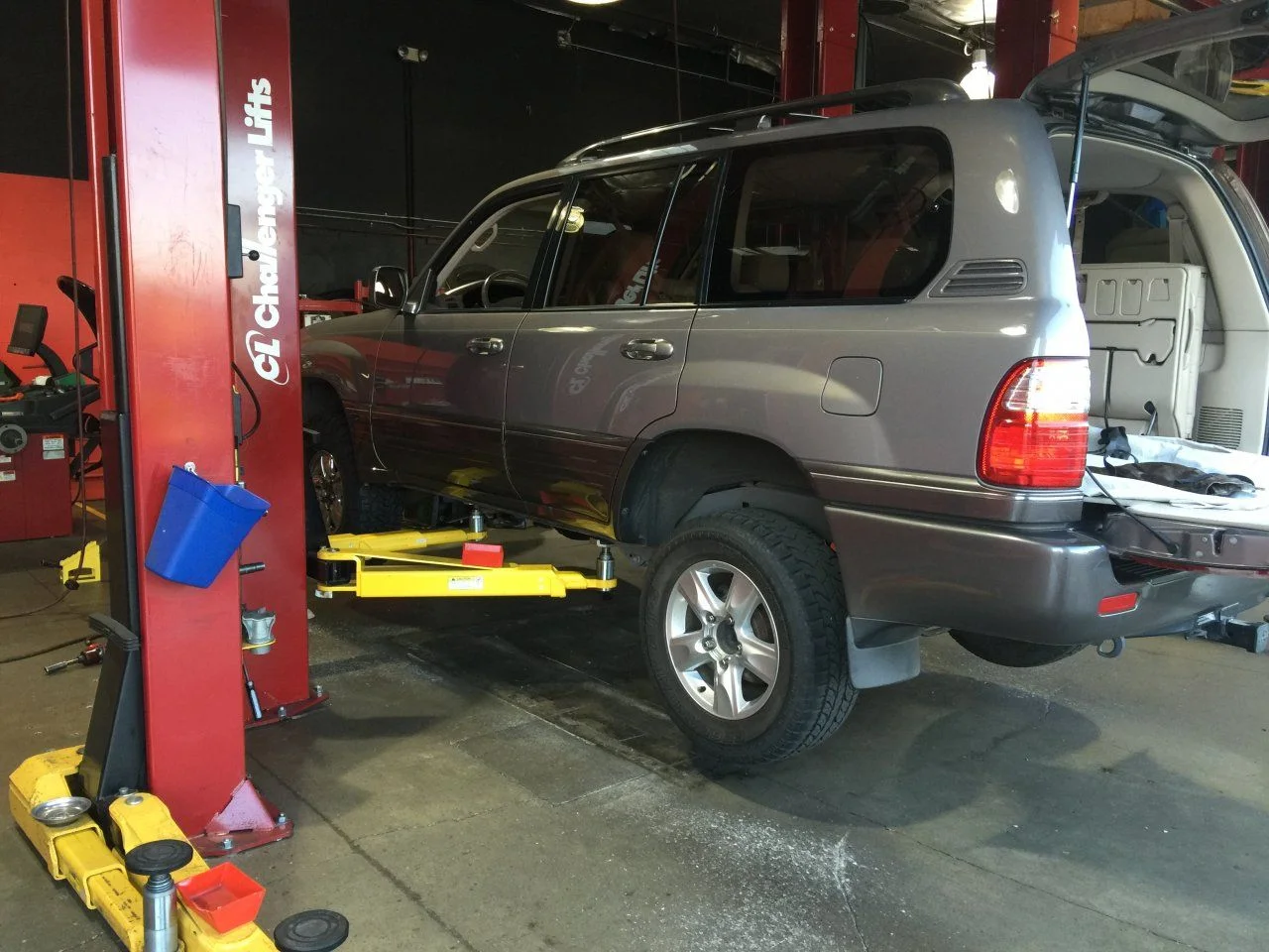

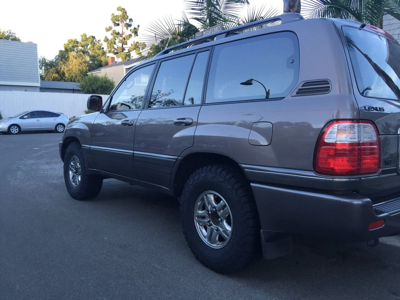

Got my LX some 285/75/16 BF Goodies KO2s on my chromies!!!! And I love it!!!!
With my recent AHC fluid swap and new tires its feeling and driving great.

I like the chromies bc it's stock! I love keeping looks factory! But I still want bumpers and TRD rock warriors....

Do the BFG's rub when turned all the way?
Not at all. Free and clear.
