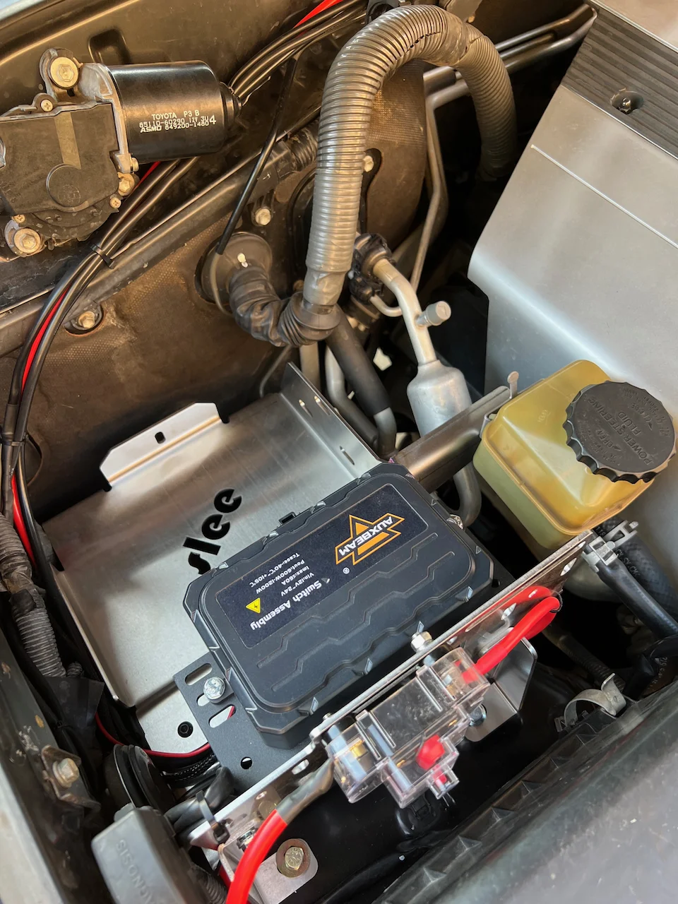

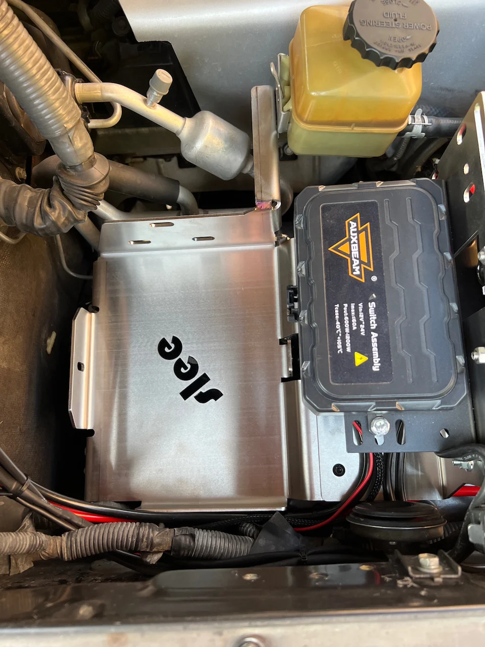

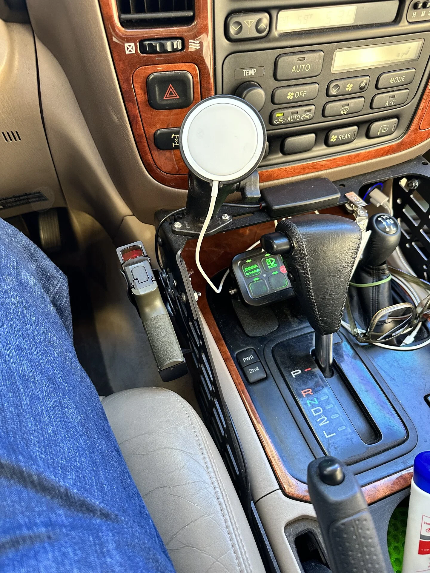

I use the 8 switch auxbeam. Have it mounted under hood on a Slee second battery tray. Positive and negative are ran over to the main battery across top of firewall. This may change once I add second battery.

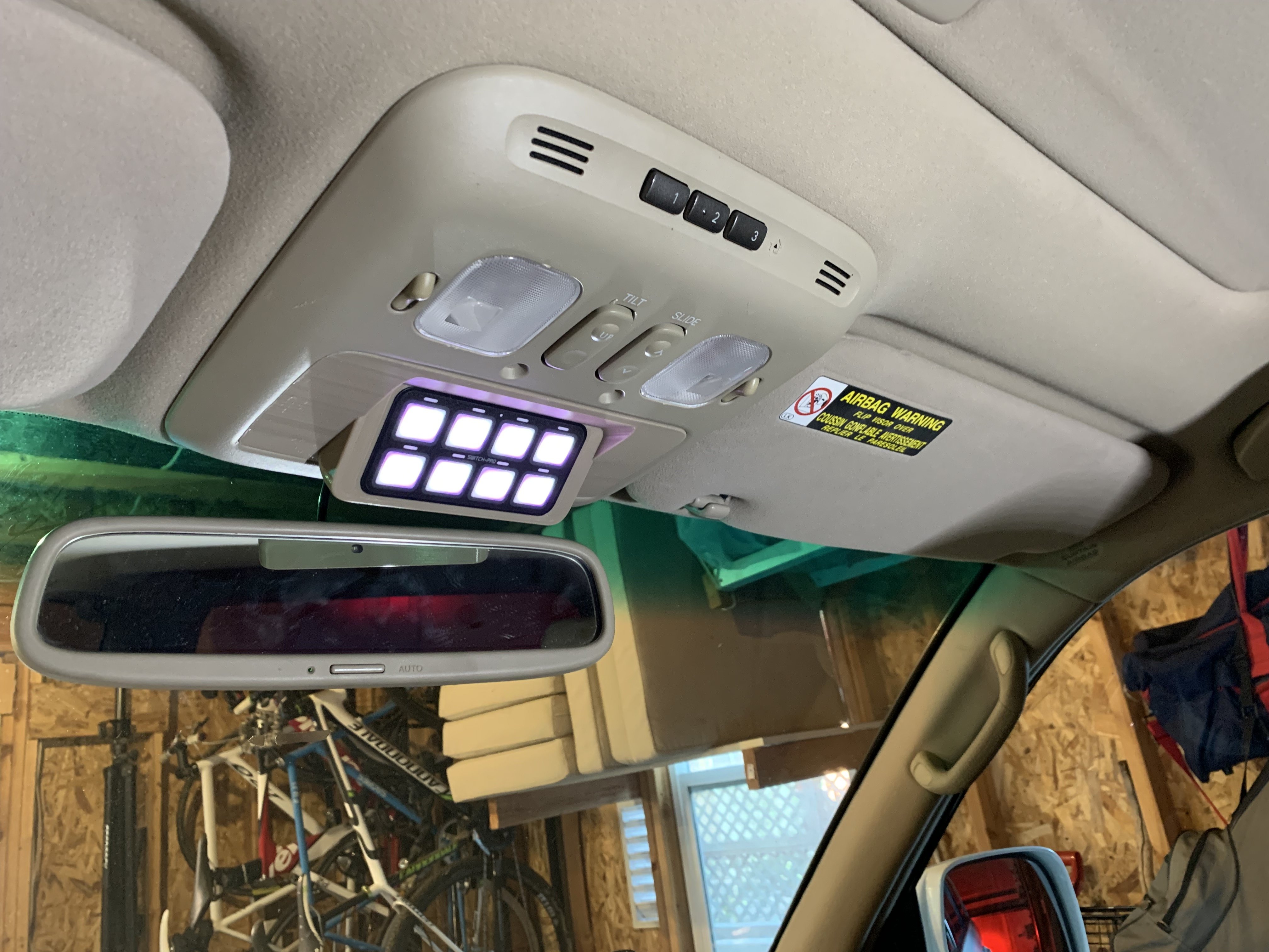

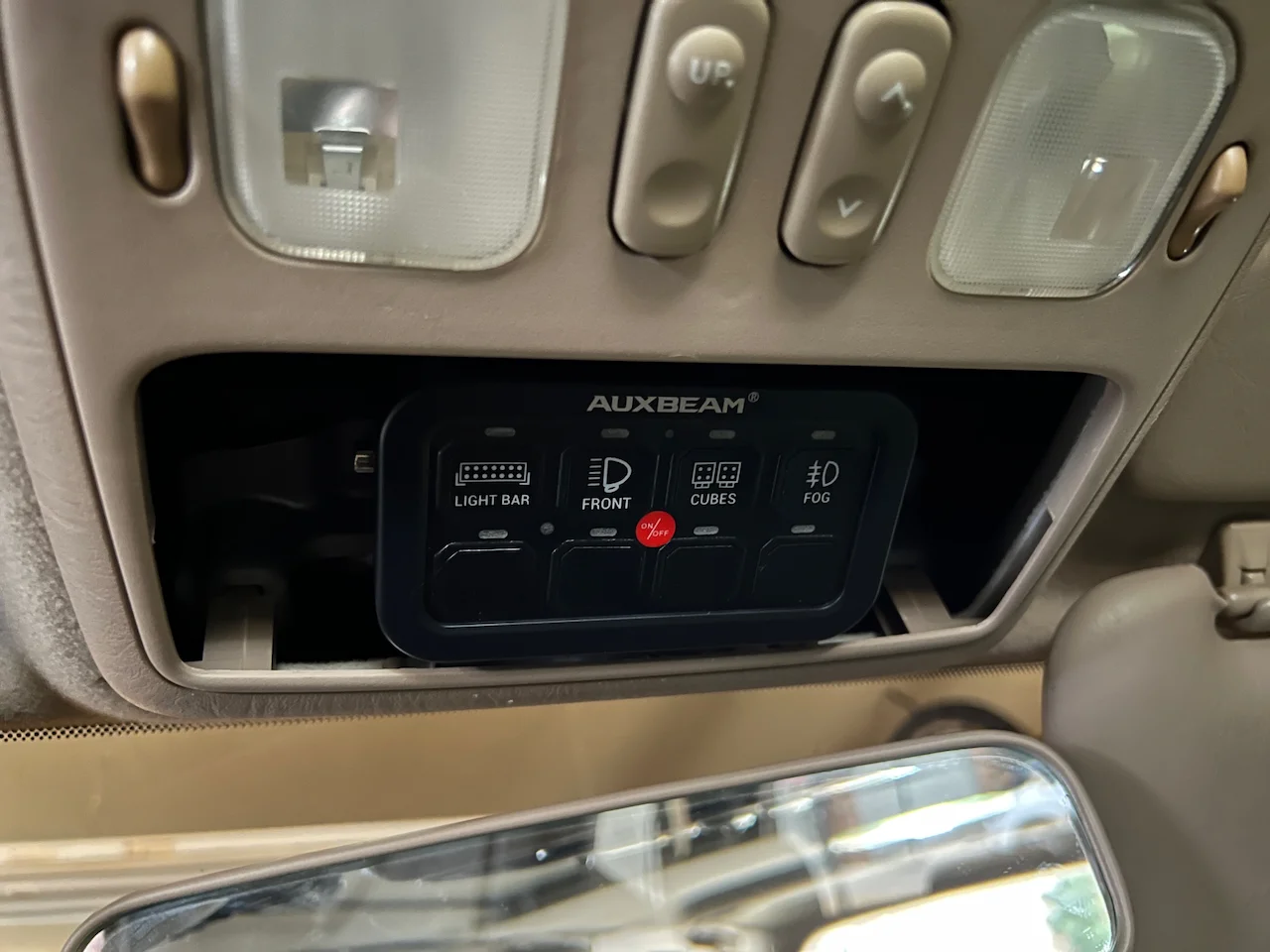

Ordered the 3D print from @BenCC for that Auxbeam switch in the interior. For now this is just bolted up to one of the available bolts in this spot.
Nice. How do you like the AUXBEAM so far?

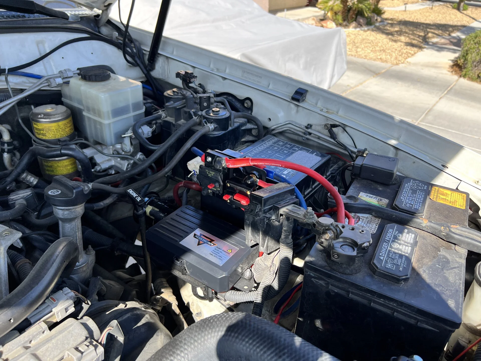

This was my initial install with the owl accessory mount. I have 3 circuit breakers mounted to it as well as the auxbeam box.
