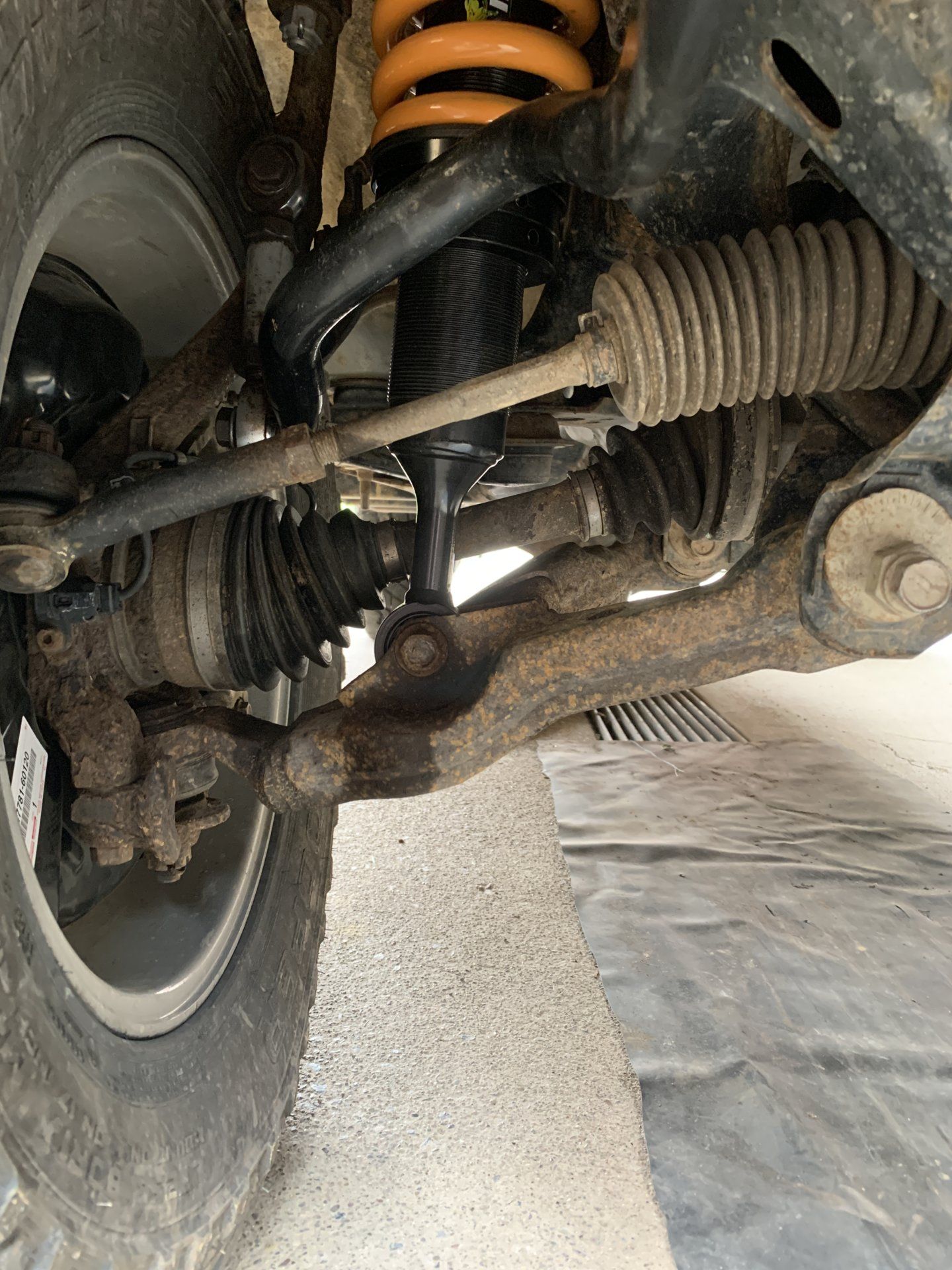

This is mine after the new lift.
Fully extended is 26.5" with stock travel coilover. You basically only have 2" downtravel. Even extended travel only add minimal down travel. It does look really tall. Maybe reduce all the preload.

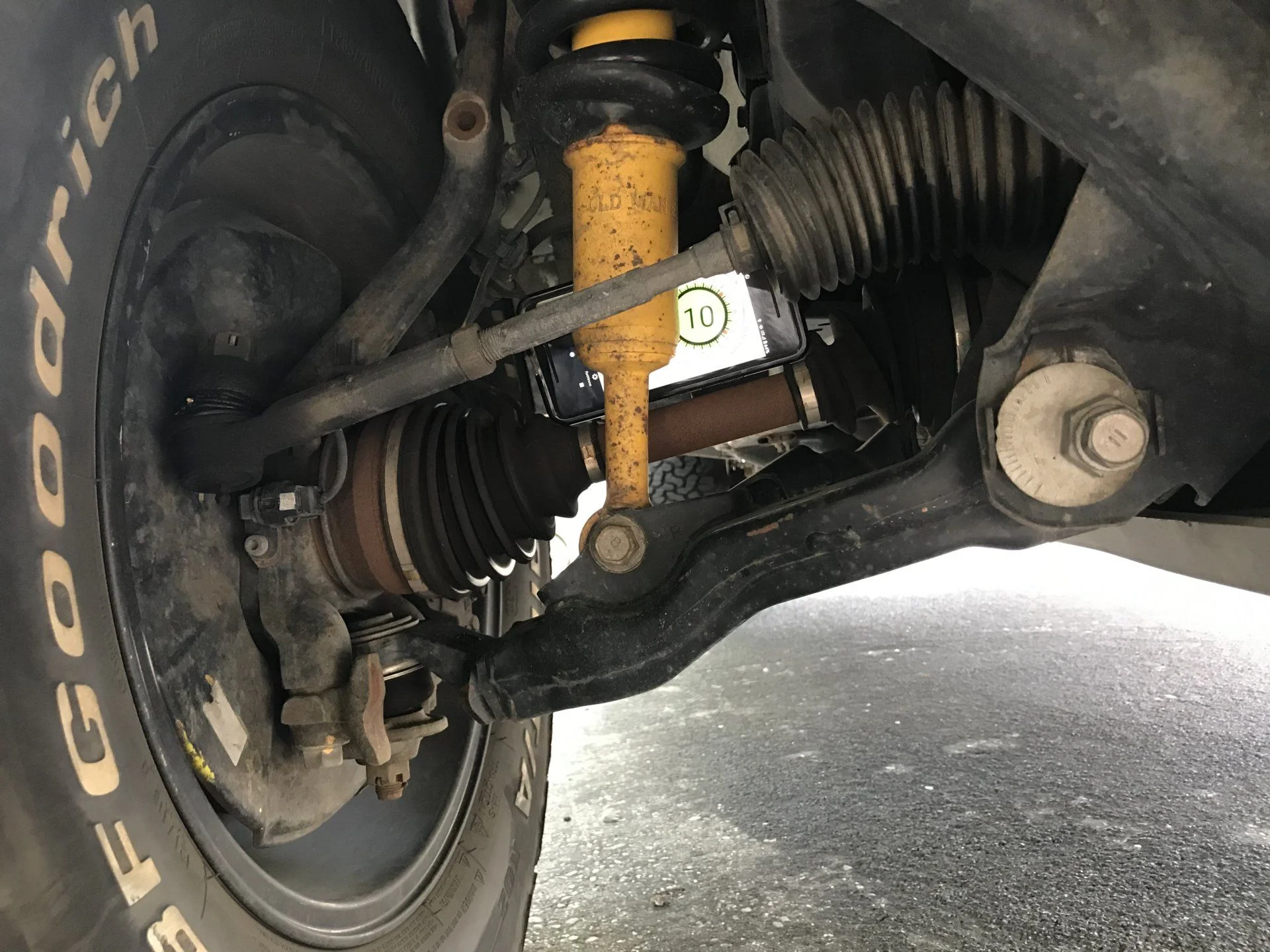

Lifted to 23.25" in the front.

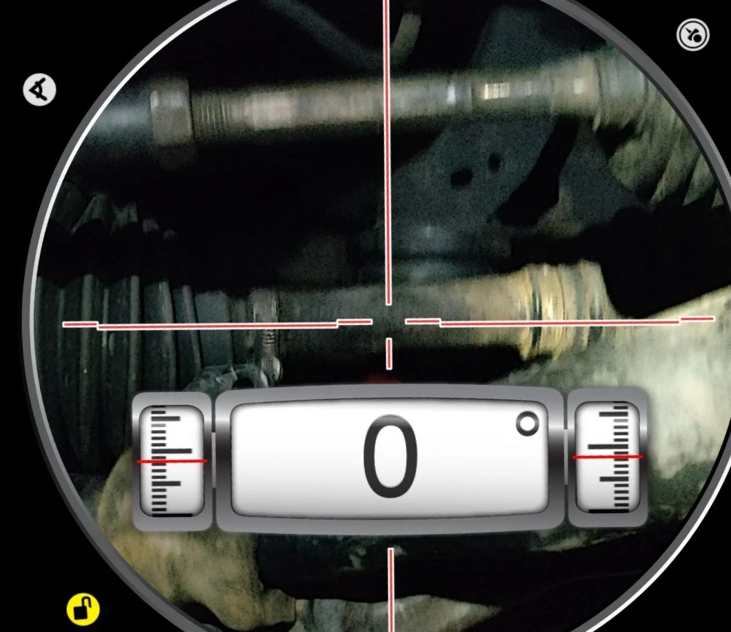

Found a use for my inclinometer now that I can't go skiing :(. 10 degrees but obviously that's not exact

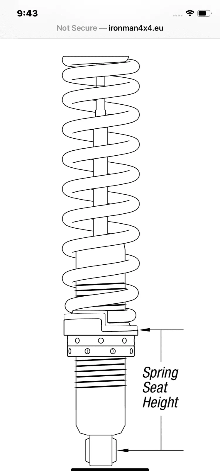

Well I’ve done some reading, and from what I can tell. Ironman says the spring seat hight on a 120 is 214 mm =8.425 mine are measuring 246 mm = 9.7 so I got to bring it down.
This is why I’ve got a little over 4 inches of Lift.

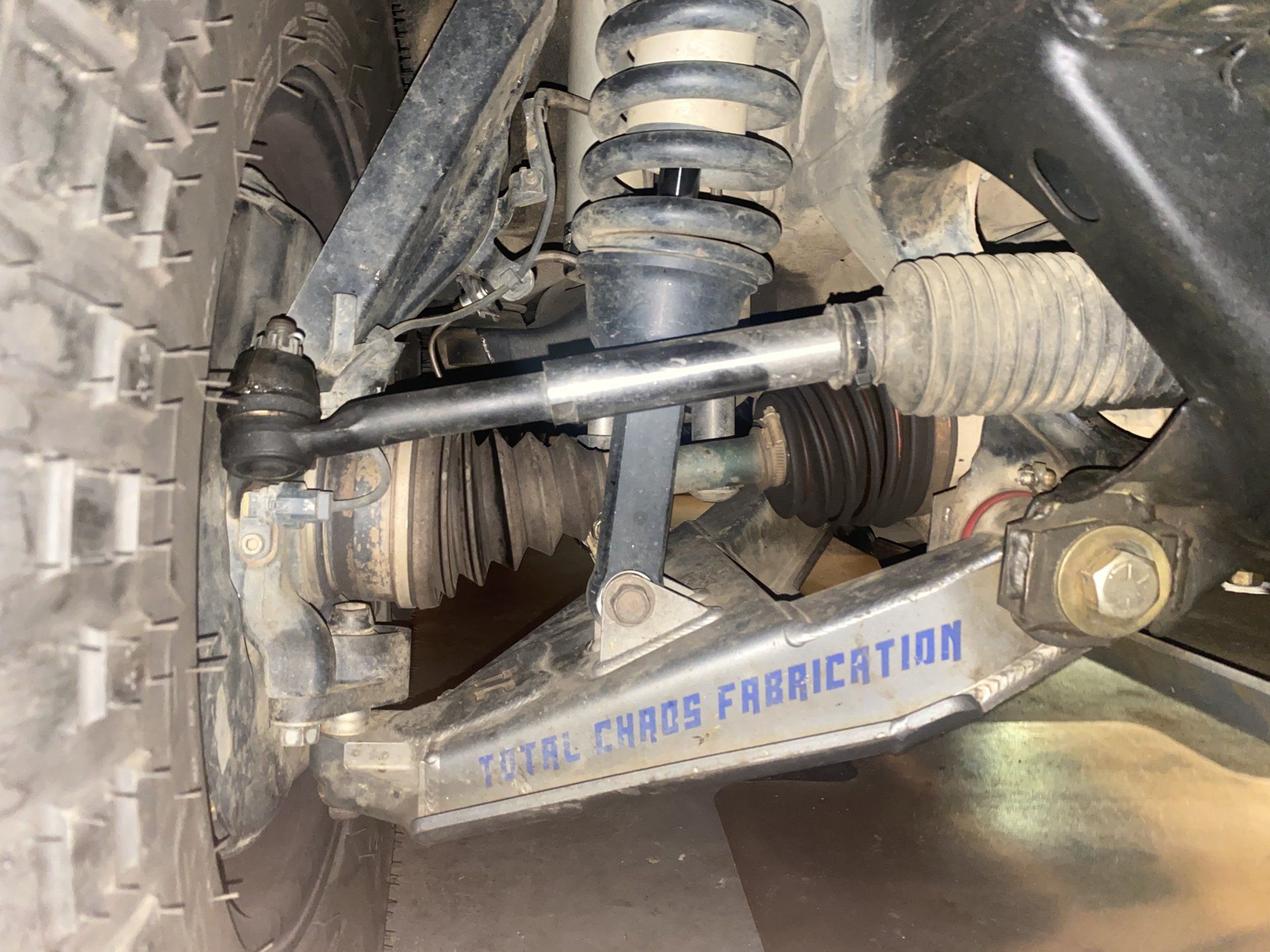

Extended travel stock width. TC lowers, GXOR uppers, ACC tie rod sleeves, Icon coilover with 700# coils, TC spindle gusset, Lotus axles.
These were prebuilt from metal tech and was hoping I wouldn’t have to mess with them.
Sounds like I need to lower them about and inch.
Pre-built Ironmans from Metal-tech 4x4? Must have been purchased awhile ago as we discontinued carrying the IM4x4 brand mid-last yr.
As for the angle if you don't need that much lift, definitely back the pre-load off to the minimum height you need to relieve stress on your CV boots. It can be done on the truck, just a bit harder to reach with the IM4x4 design of the threaded area being below. Way easier to remove pre-load on an FCP that it is to dial more in as the official IM4x4 suggestion is to remove them from the truck and use a spring compressor to do adjustments.
