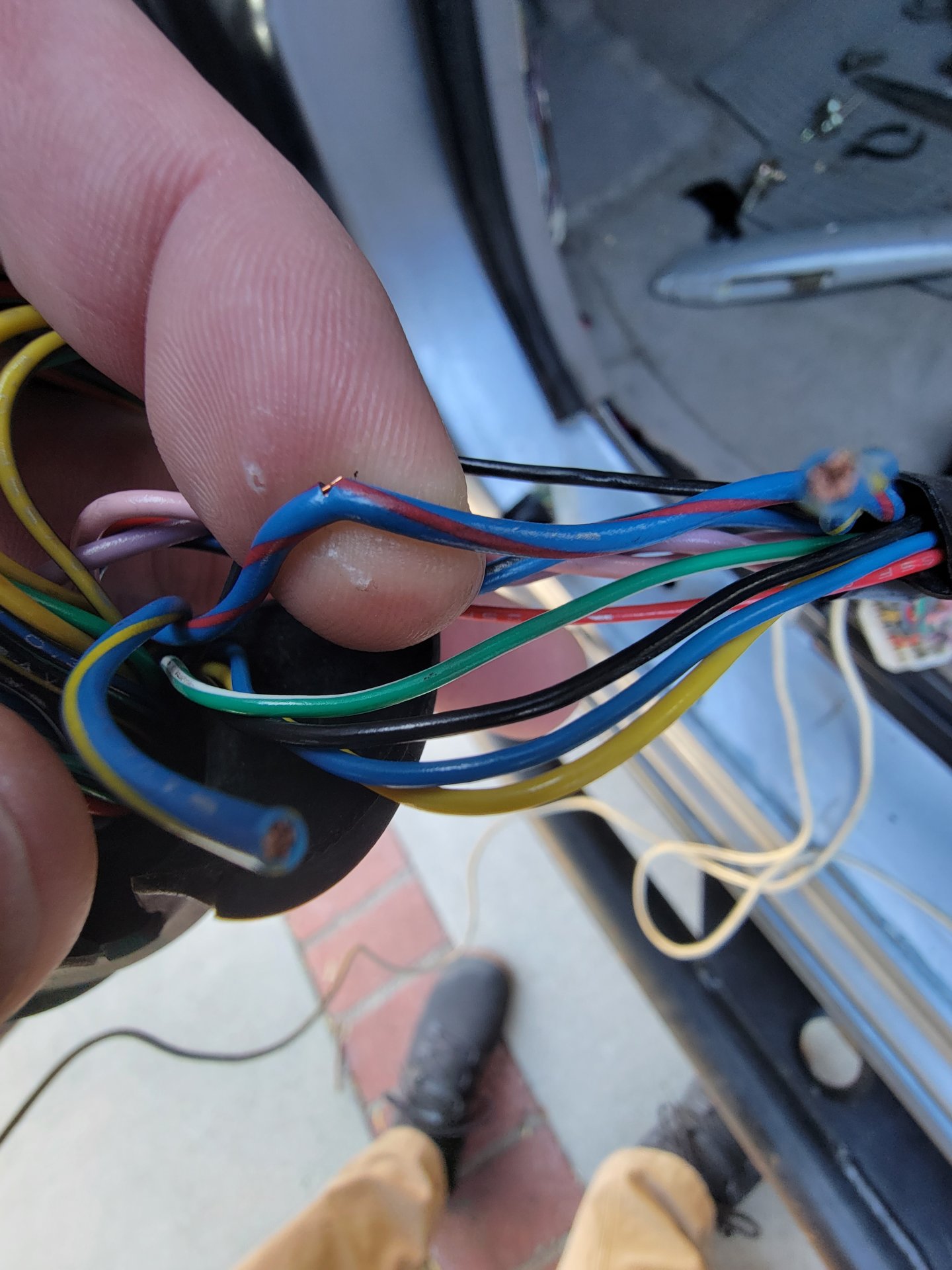

Thanks for the helpful response. I got a little deeper into it and found that the signal was getting thru the Nav DVD player. I phoned a friend (member nissanh) and was advised that these LC's sometimes break wires in the rubber boot serving as a conduit between the car body and door. I pulled the door panel and found that there was a broken speaker wire under all the black tape about 6" inside the door. A quick splice fixed it right up. I have no idea what could have broken that wire inside the door like that. It seemed to be completely unmolested. Thank you, TXSunDevil and nissanh for the help. I'm greatly relieved.

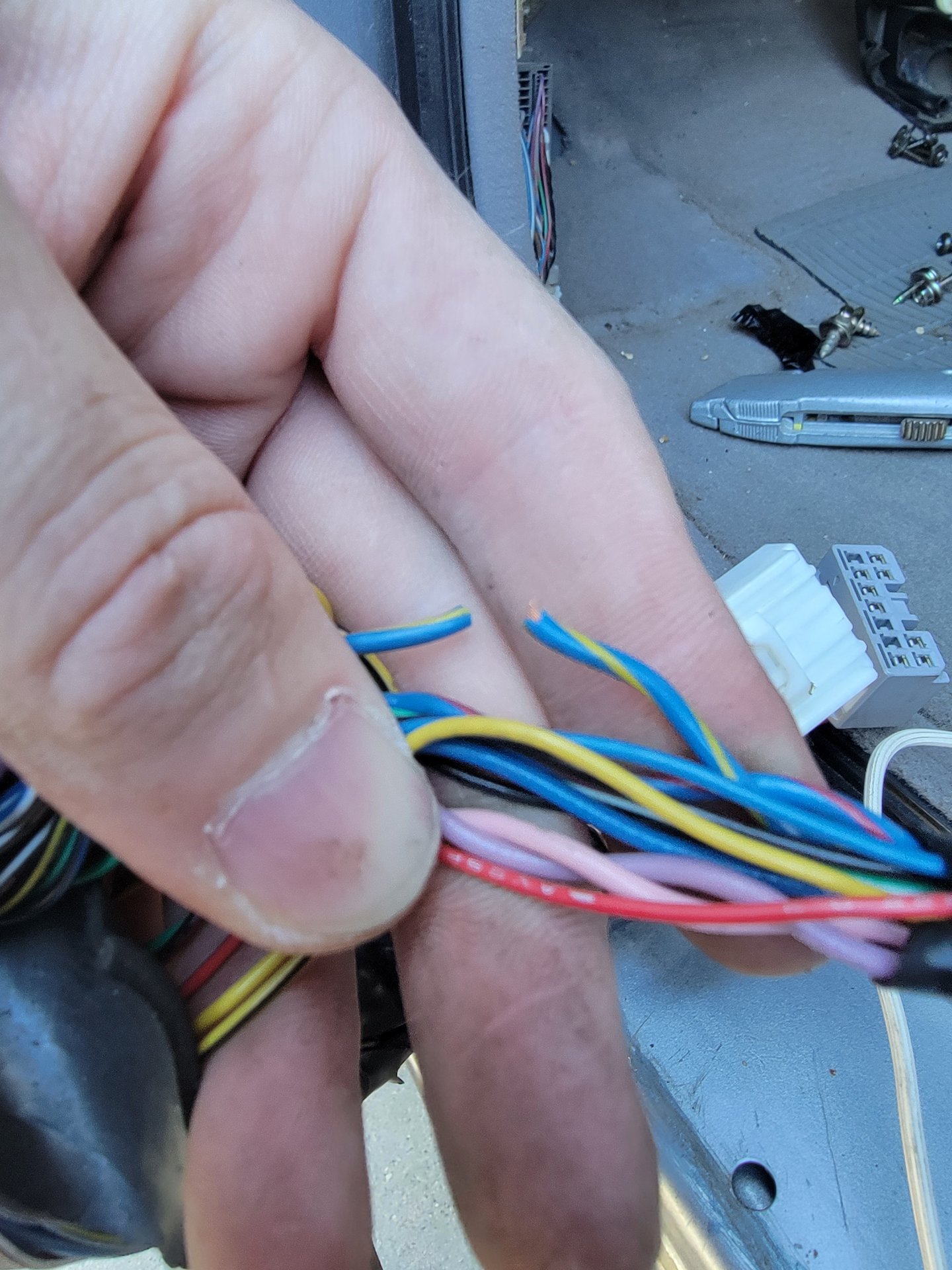

I pulled the door card, the woofer speaker at the bottom, this gave me room to disconnect 4 connectors from inside the vehicle and then pull it all back through into the door and out of the woofer speaker hole. That allowed me to be able to unwrap the electrical tape and pull back the boot to find that one of the wires looked to be very cleanly cut (blue with yellow stripe), and another wire to be partially cut (blue with red stripe). Both wires supply the tweeter and knee high speaker, but they woofer speaker on the bottom of the door takes as separate input.
Strangely enough, the wires were twisted around each other, undoing that twist gave me 3/8" overlap that I used to solder the ends back together. With ONLY the speaker wires being damaged, it makes me think that the wires were damaged during production/assembly.
The cut/damage was about 9.5" back from the connector.

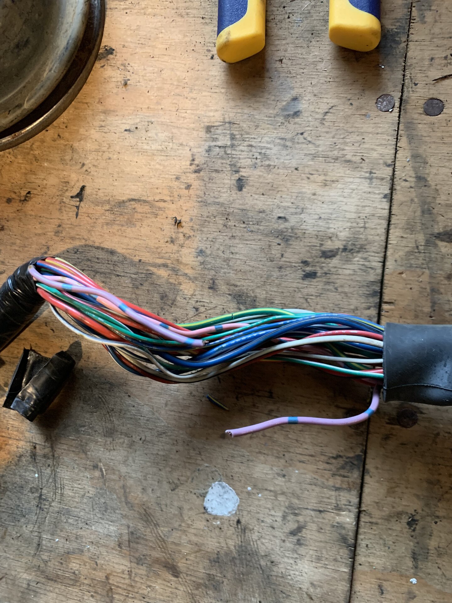

Removed the wire harness pushed the rubber boot back & as suspected broken & frayed wires. Replaced 3 sections of wires, wrapped with heat shrink & mission accomplished. Bluetooth works again.👍👍

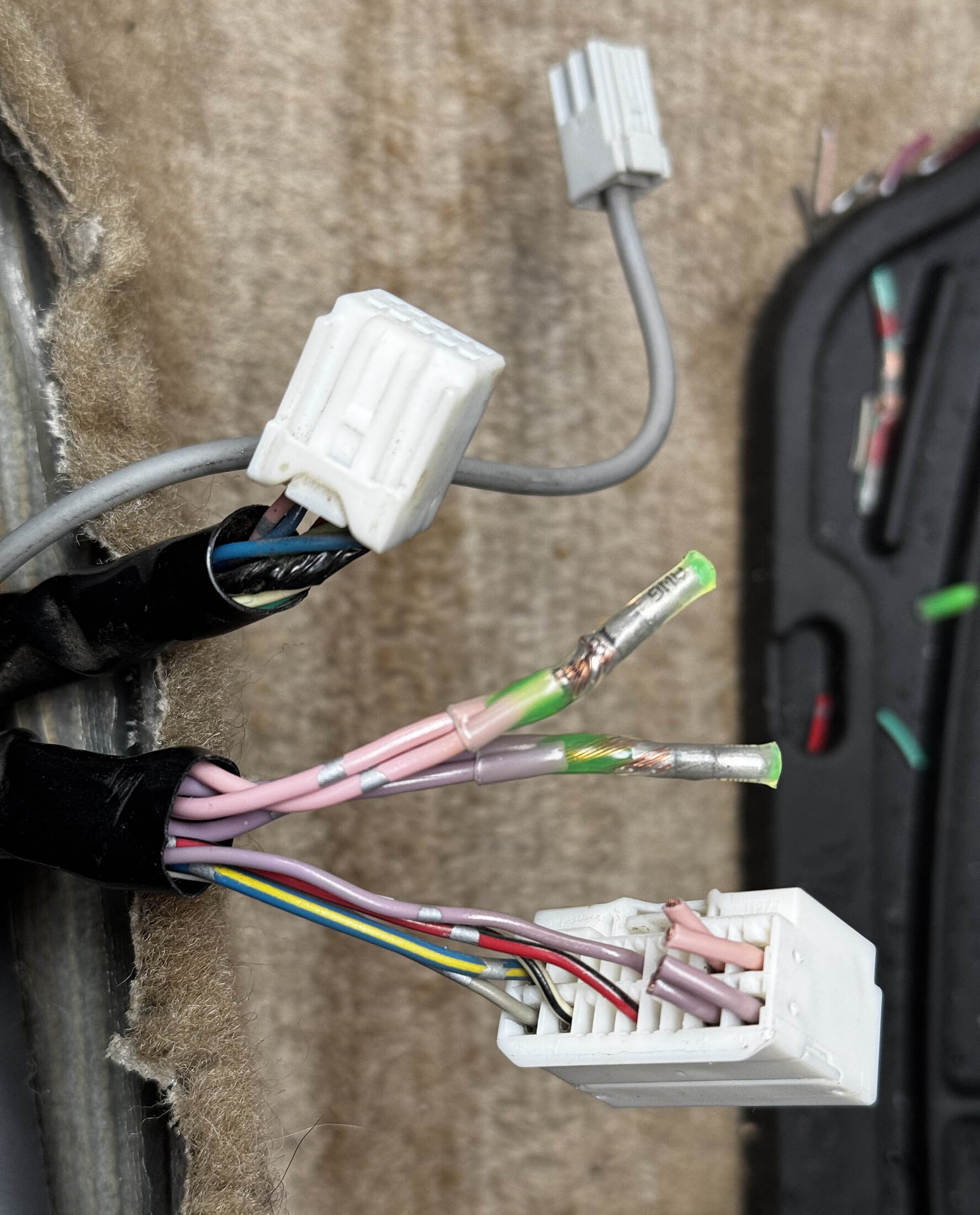

Here's how I fixed the left speaker not working: I cut and connected the 2 pink wires, and I cut and connected the 2 purple wires from the big navigation unit plug (under the front of the front passenger seat). My left front speaker is now working again.
Thanks for sharing this! After doing this I still don't have audio at the tweeter and the smaller middle speaker on the driver's door. Did you get power to all drivers side door speakers after splicing these?
@w0lfgang did you ever figure this out? I did the same thing, jumped the pink and purple wires but still nothing. :bang:
