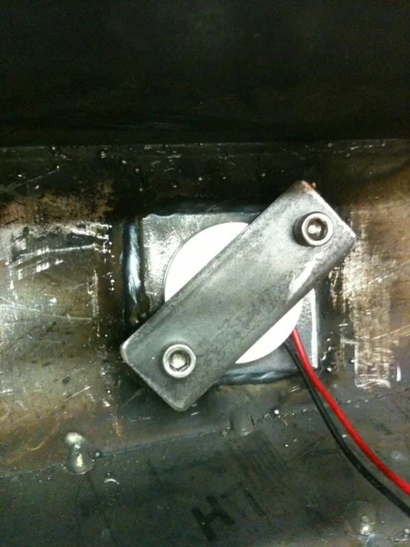

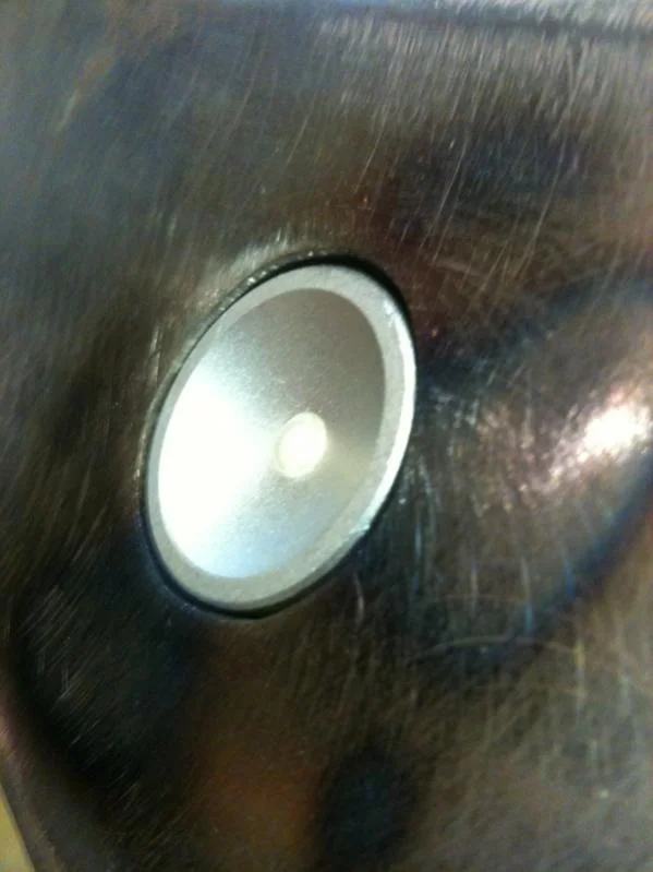

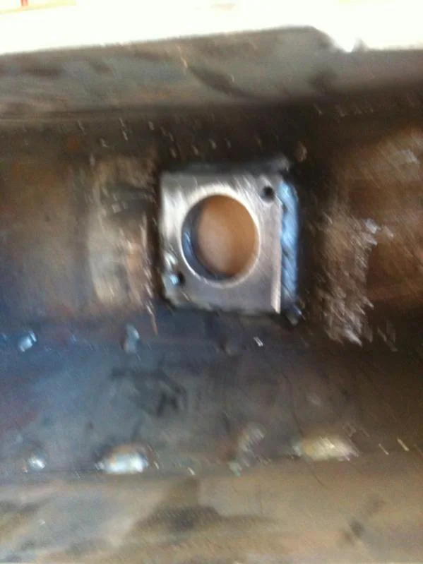

Here is what I decided to do. Flush mounted. I wanted it to be stronger than the tiny mount holes. And wanted it to be easy to replace the lights if needed.
Used a 1-1/8" metal hole saw. Then used a burr and a file to get it to 1-3/16". 1.25" would work with a tad more gap showing.
Tapped the holes in the plate welded to the bumper. So the light is just sandwiched between the plates.

That's a hell of a good way to mount the lights man, good work:cheers:
