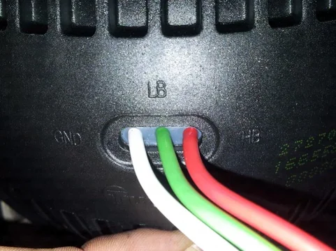

In a closer look ground, low beam and hi beam are pretty clear from the back of the lamps
I put ground and 12V as indicated in the back and sure it lights up as expected..
As we know Toyota use weir method swapping ground between port at the wiring H4 connector.
So I guess I would need to do another circuit!

Another real time update
Call find who owns a J**p and have those installed and it's close to home to go there and check how the light work in his setup since were bolt on for him...
That POS works the same way as I found in all Toyota soo I I took my chances and connect directly to my H4 connector..
Boila!
It works the only think it's you don't have the hi beam light in the dash any more..
