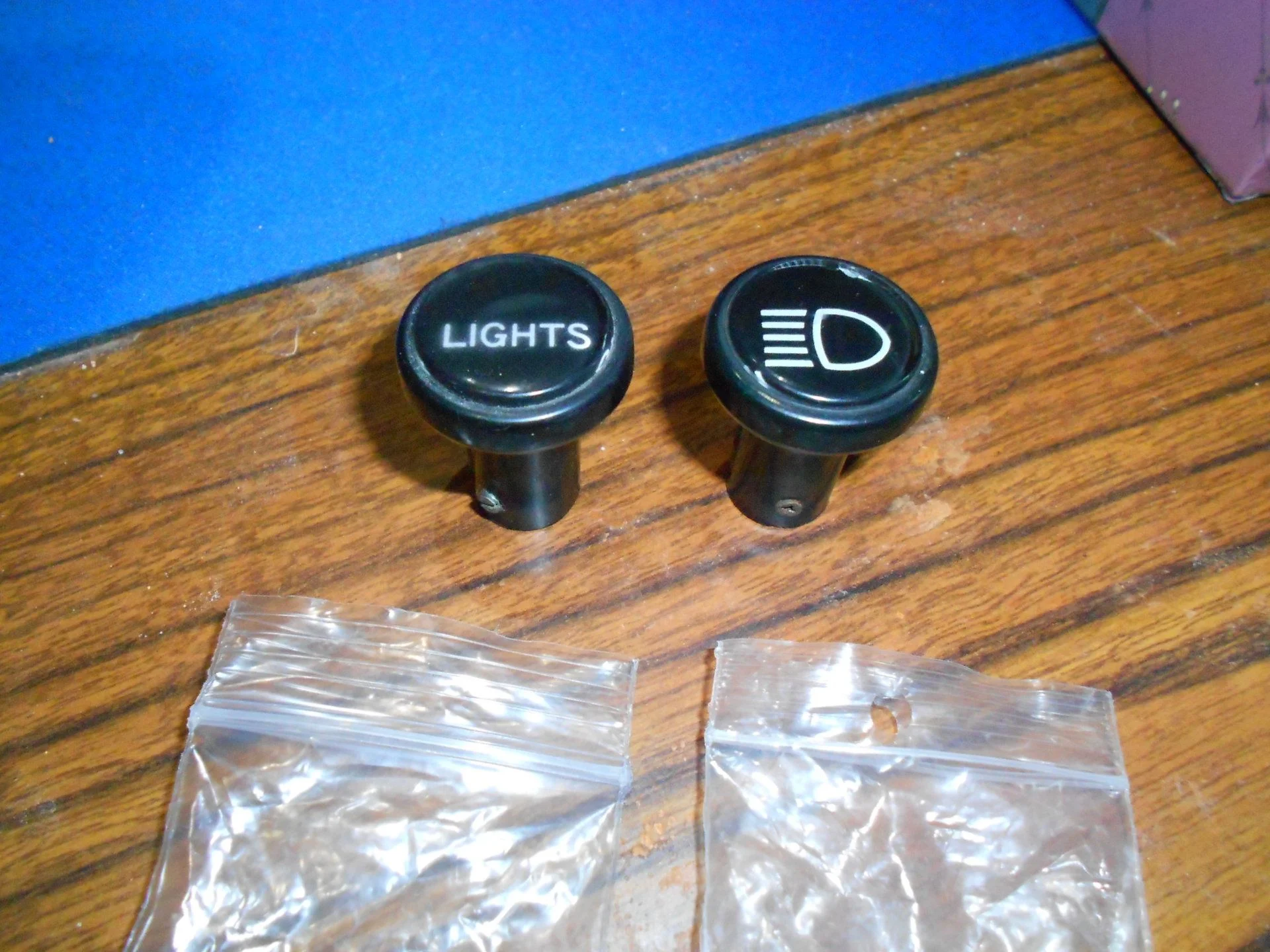

Inside the 75-84 headlight switch both the "LIGHTS" ( 1975-1980) style and Later " EYE BALL LOGO " Knobs ( 1981-1984 ) Like on @imyahucklbrry 's 1982 , There is also a 3rd style the " Saudi Spec. LX Model " " Lantern Logo " ,
( The Year span of application use on the "Saudi Spec LX Lantern Logo" back lit knob Has Alluded me thus far )
In each knob Is a Green Plastic Light Filter or Lens , so a color keyed LED Bulb Should be used , Per the Super Bright LED Website

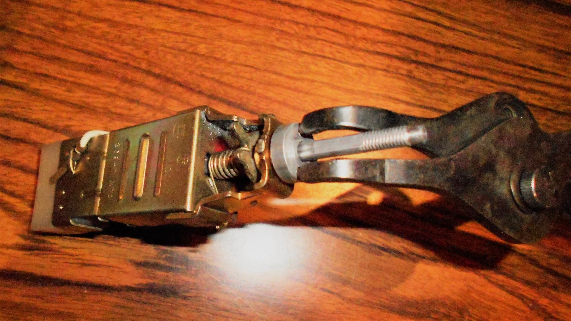

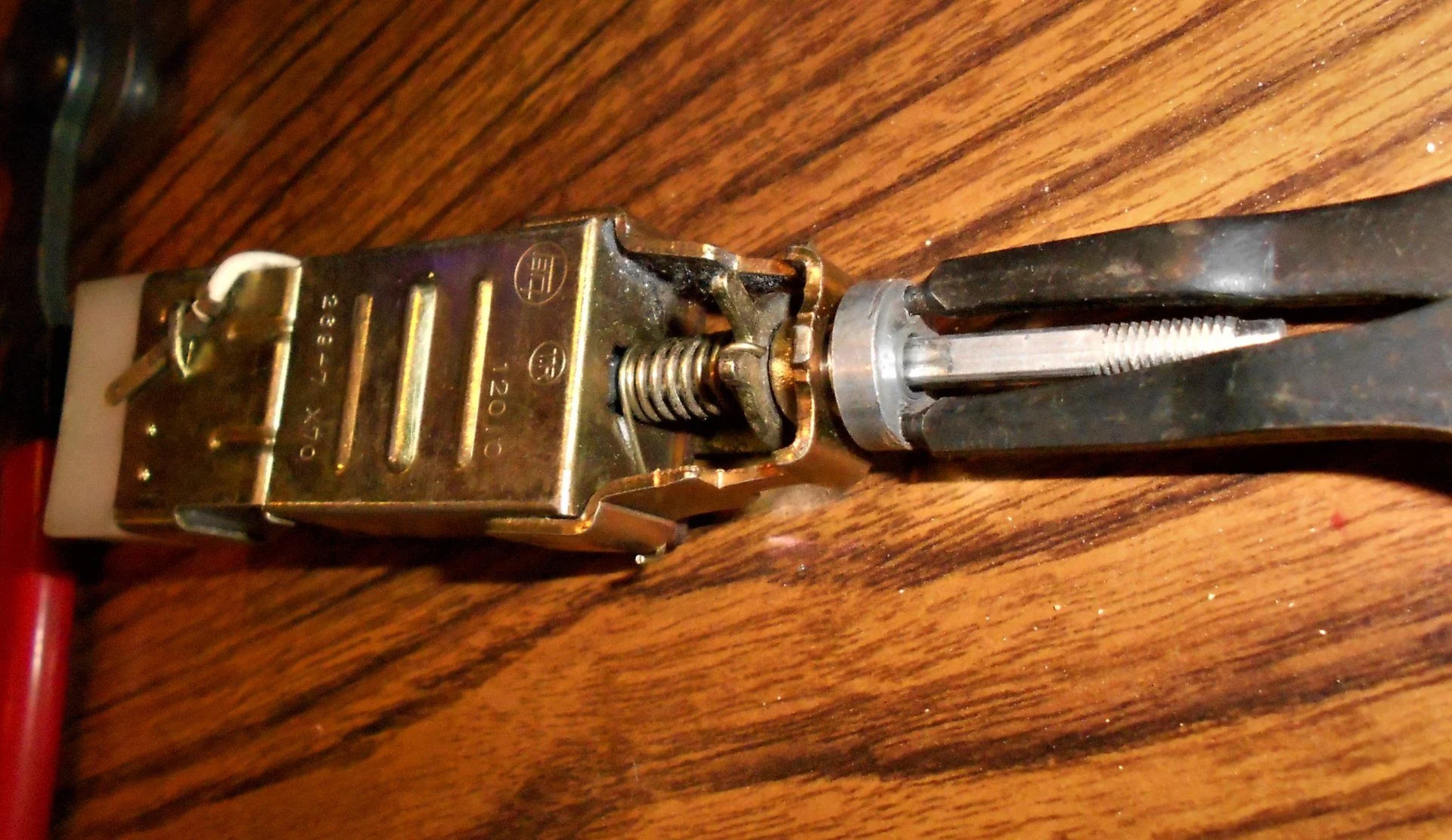

As outlined below , first loosen the set screw holding the knob on the Pull Switch shaft , unscrew the knob , then use snap ring or Pin wrench Nut Pliers & remove the pin wrench Nut , apply MED. forward pressure on the Pin Nut as u also turn in Counter clock wise to loosen it

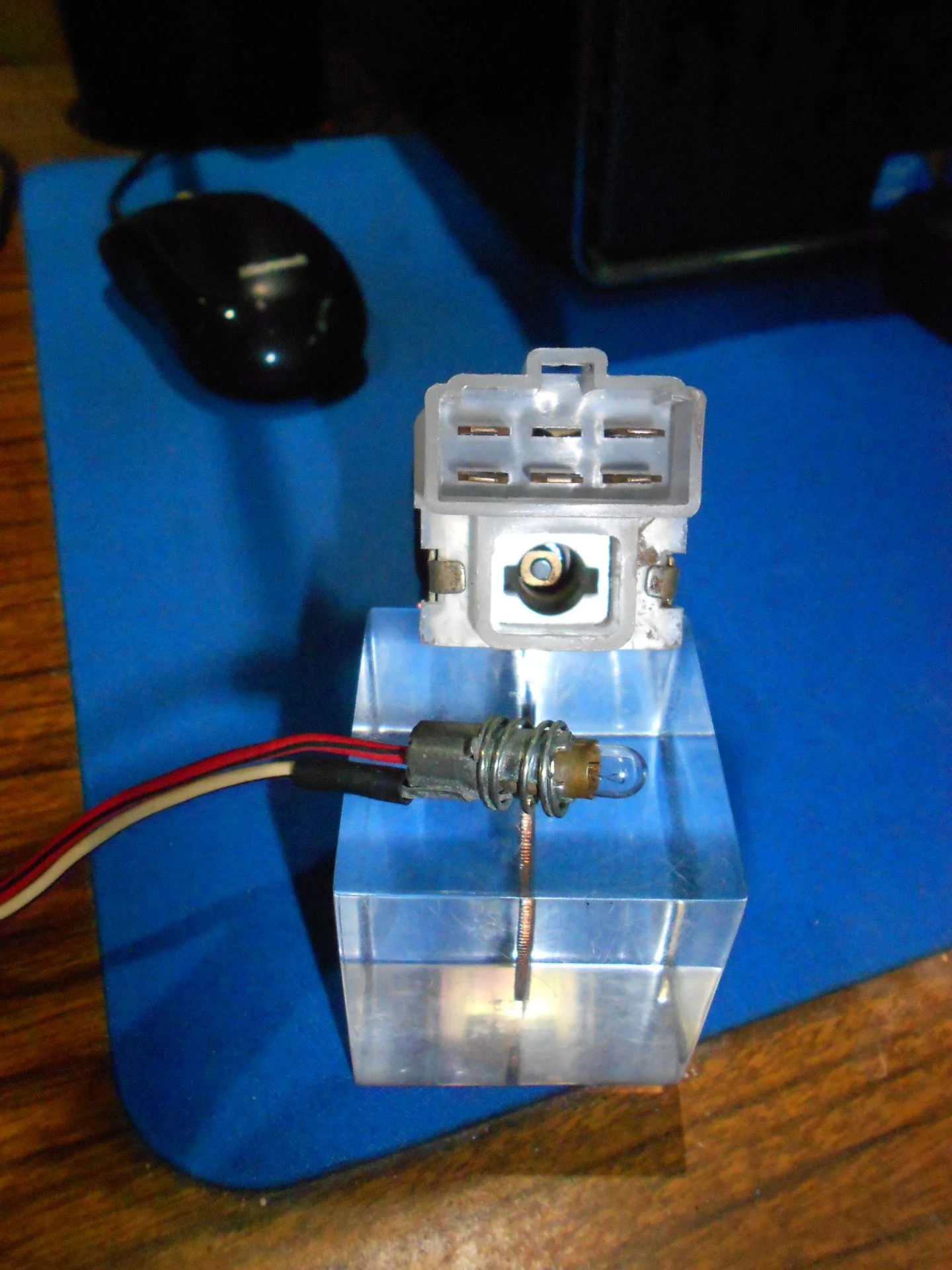

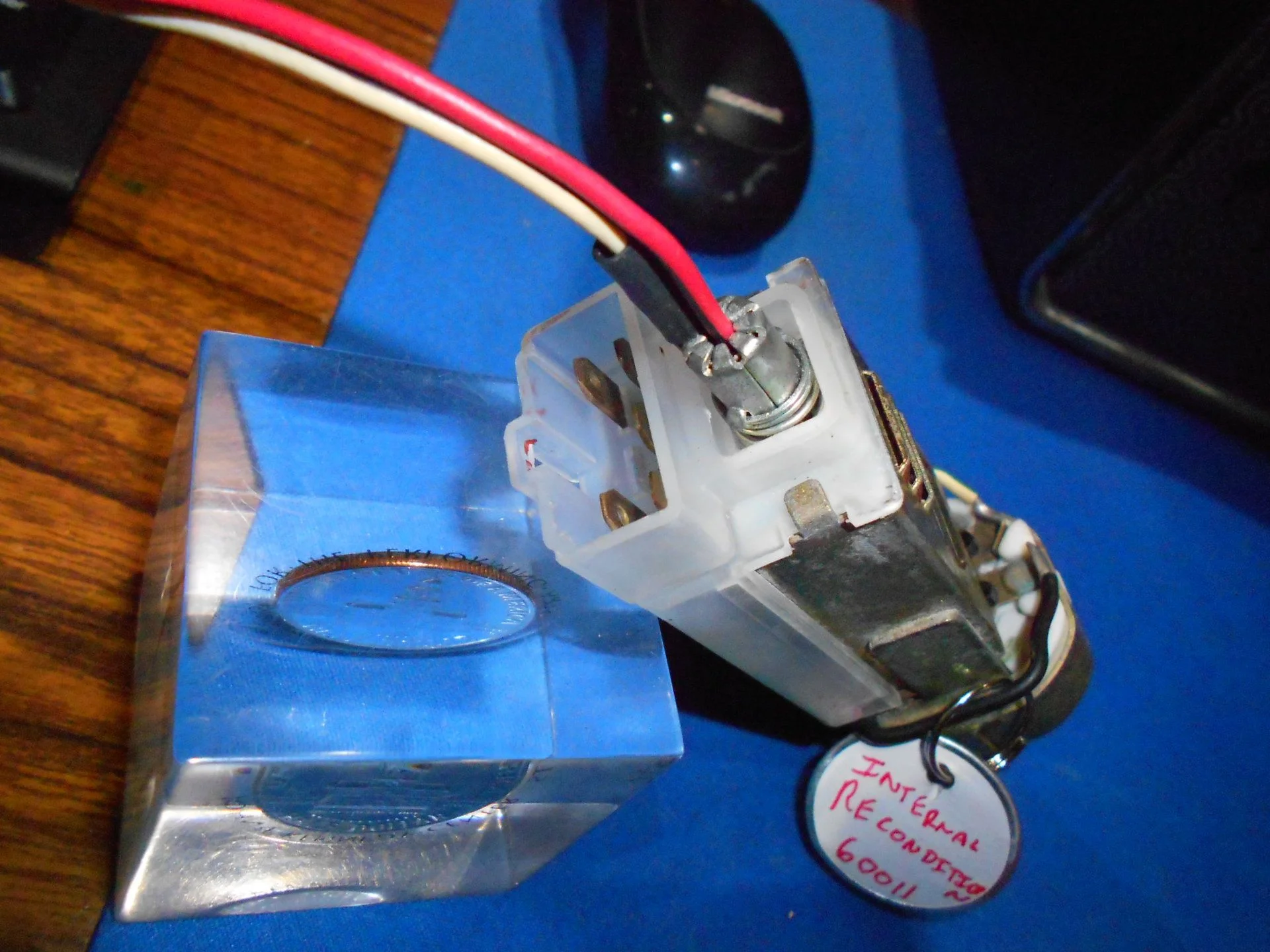

I have found the BA7's both clear , green & amber from super bright LED's on occasion to fit a bit to snug in the Toyota socket , I dont know if this is the bulb or socket itself ? I take my small snap ring pliers in the expanding mode and spread the socket just a Hair Micro Millimeter out so the bulb fits loosely & the socket sill fits into the back side of the switch in it's twist lock receptical hole shown below
Test Bulb prior to Re-Install of switch
U must Re-install the socket into Back side of switch prior to re-Mounting the switch back up under dash
