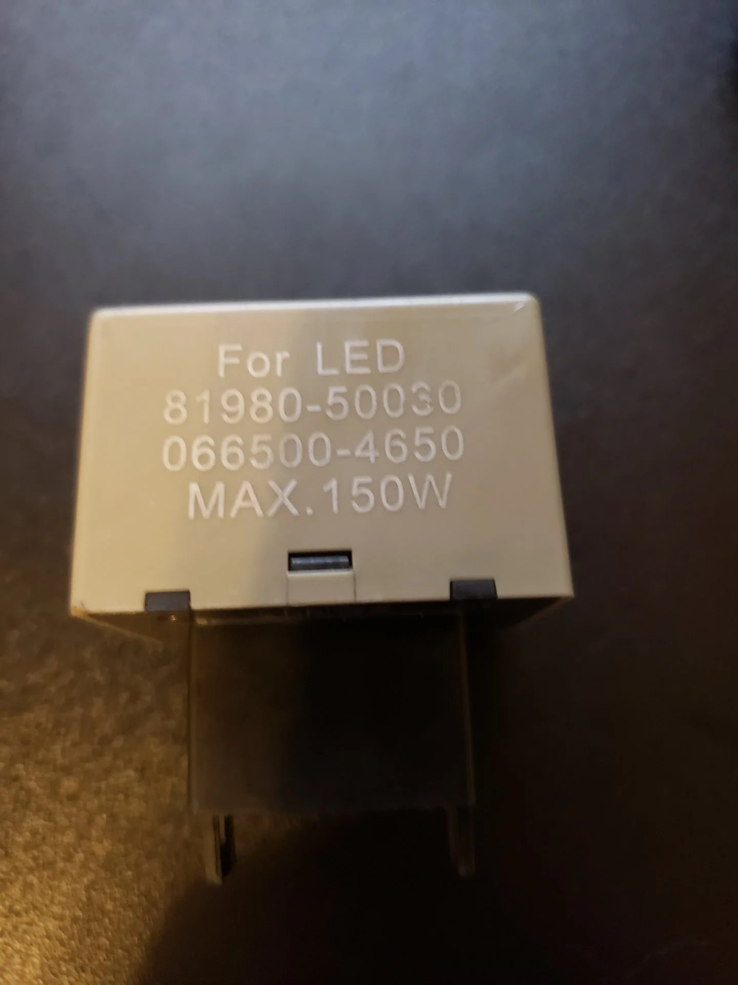

Well, I managed to get this done. This is the Amazon link for the relay that worked for my 99.
Amazon product ASIN B008C9YS0Y
It seems like I nearly dis-located both shoulder blades and it looks like I got in a fight with a mountain lion on my back. I put a storage
box along side my truck. I wiggled and wiggled my hand in between all the wires and bent each tab back. I then took a tiny flat head screw driver
and pried it loose. Luckily, it wasn't zip tied real tight and I could pull it down. The new one plugged right in.
Anyone replacing a bumper or just upgrading bulbs to LEDs, this is the better, although more difficult, method.

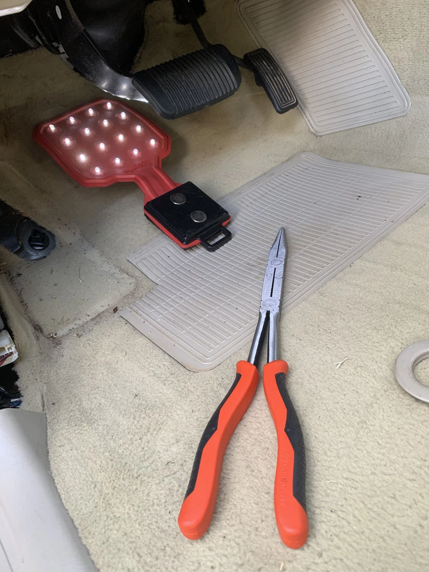

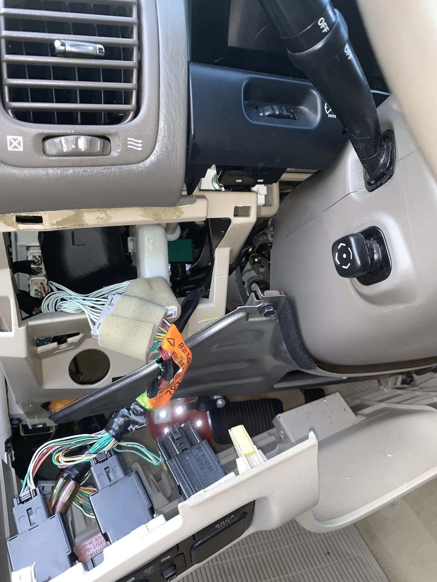

now that I’ve done it, I think the following method is much easier. No need to lay on your back, you can reach everything from a kneeling position.

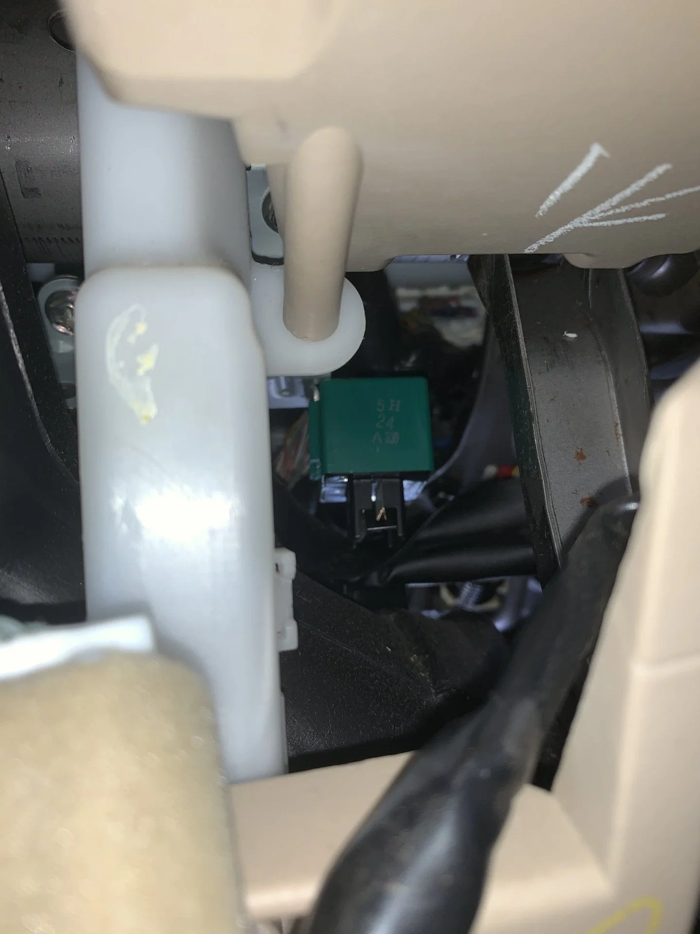

I had the green relay position (2006 LX), I think there are different setups. I wouldn’t waste any time trying to get the bracket off. Leave the OEM relay in place. Quickly remove the plastic panel under the steering wheel. There is one philips head screw holding the bottom left corner, the rest of it is held on by clips. Just pull carefully.
You will then be able to see the relay through this hole. You can easily reach under the dash while looking through the hole and bend back the tabs holding the male plug into the OEM relay.

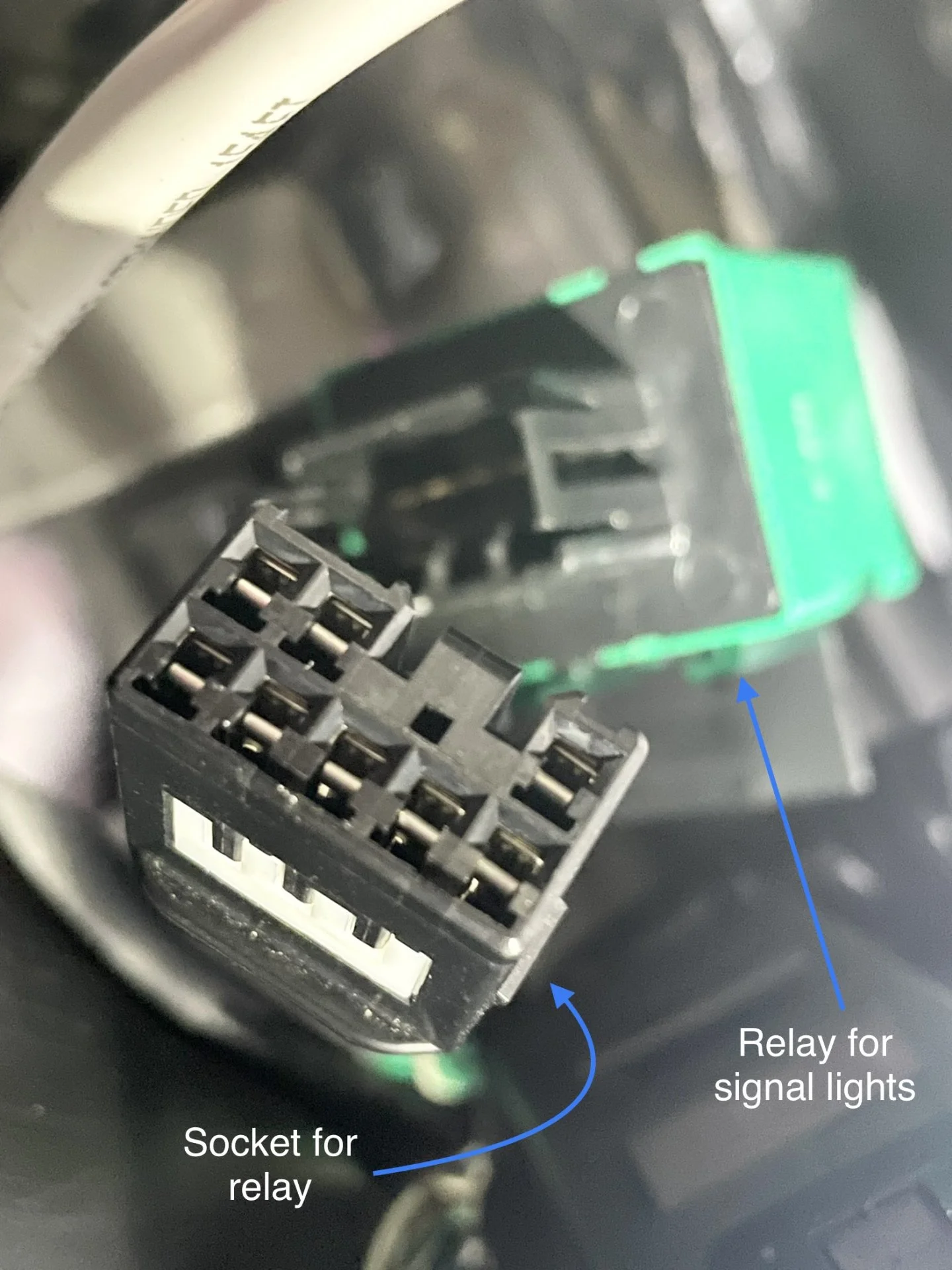

as you look at the relay in this picture, you will shove a tiny flat head screw driver up between the relay and the connector on the left side. This will unlock the “tab”locking it in place (reference your replacement relay to see how it locks into place). The little screw driver is just spreading the two pieces so you can pull the connector straight down with some long needle nose pliers through the observation hole.
pull the connector straight straight down with the pliers and it should come easy. Plug it into your new relay and you’re done. The slack wires on my OEM harness basically have zero slack so there was no need to zip tie up the new relay.

I swapped all my indicators to LED and purchased the relay below off Amazon. It corrected the issue and all lights work properly
8-Pin 81980-50030 066500-4650 Electronic LED Flasher Assy Relay Fix For Lexus Scion or Toyota LED Turn Signal Light Bulbs Amazon product ASIN B008C9YS0Y

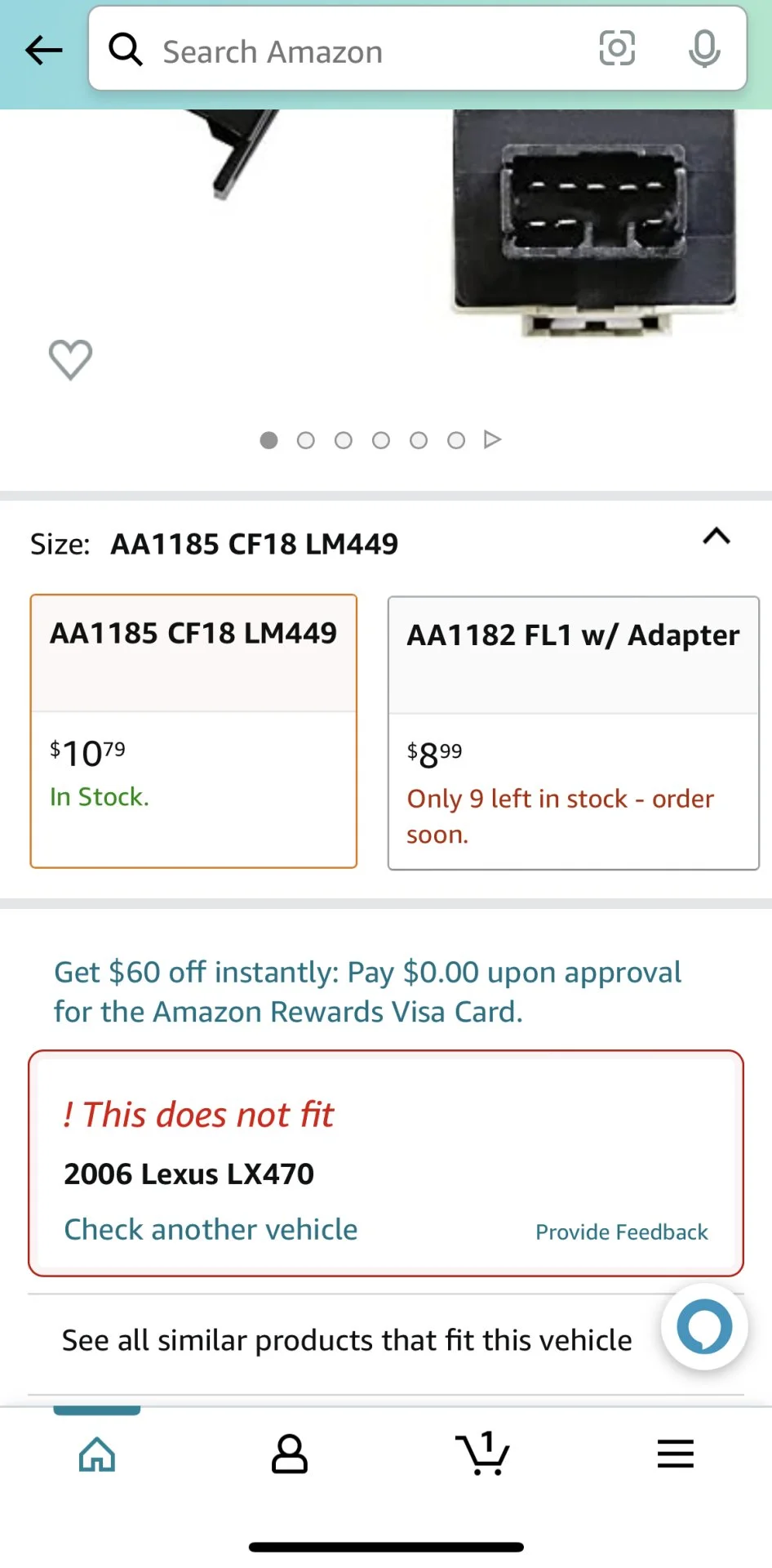

Will this product work on any LX 470 year model? Mine’s an ‘06

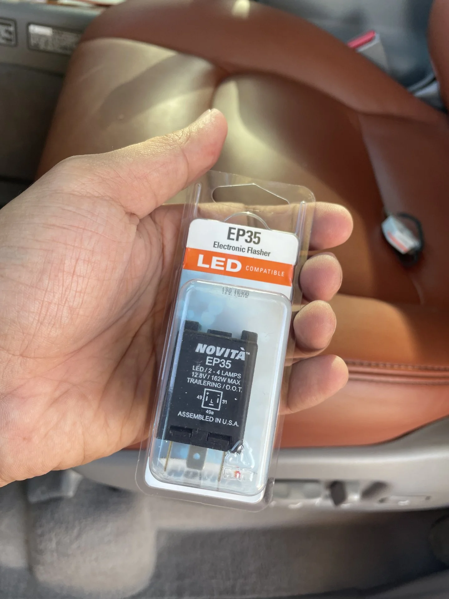

I bought the wrong one, I think. This is from my local AutoZone.
For anyone who has an 06-07 LX/LC, I can confirm this product works and hyper flashing is now gone.
iJDMTOY 8-Pin LM449 81980-50030 066500-4650 Electronic LED Flasher Assy Relay Fix Compatible with Lexus Scion or Toyota LED Turn Signal Light Bulbs

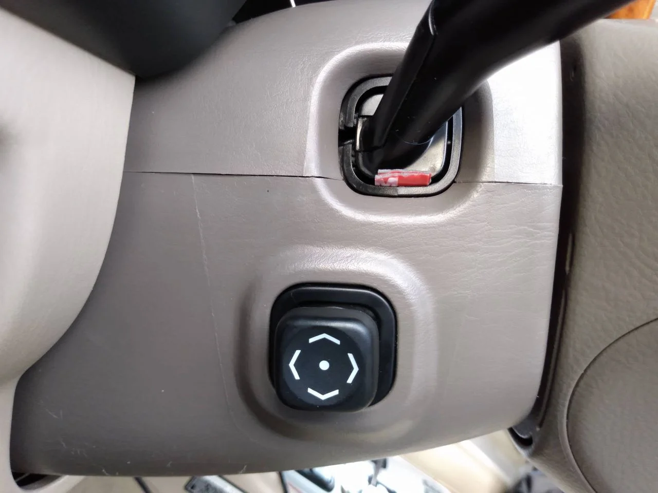

I think it’s how the stalk on the 100 is designed. When the wheel returns to center, the stalk bounces back hard to original position that it hits the opposite contact points triggering the opposite line and the signal light.
I tried to intervene and held the stalk so it returns to original position softly to see if that helps and it doesn’t blink 3 times anymore.
Yes, it’s actually annoying tbh. Any work around on that other compensate a wide turn like an F1 car trying to make the straightest possible racing line?

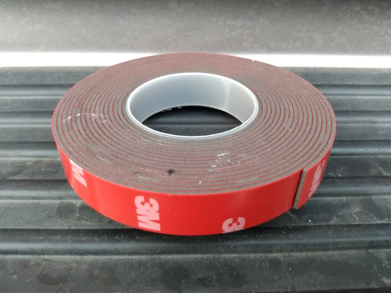

I made a mini shock absorber from 3M tape. It has been working well for a few weeks. I am going to blacken it to make it my permanent solution.
