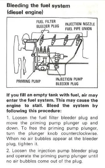

Just so there's no confusion, here's how Toyota recommends using the OEM primer:
(Using the Bosch is the same except you never need to turn any part of it in order to free/lock it. In other words, it is always ready to pump fuel and will do so whenever you push down on the black plastic top.)

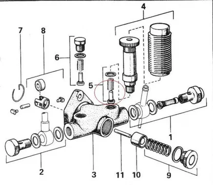

I suggest removing the Bosch and looking underneath to see if you have the undamaged components circled here:
(ie. What I was calling "spring and plunger" that form part of the check valve)
If you screwed in the Bosch without realising the stem of that "plunger component" needs to go up into its rectum, then you could have mutilated it?
