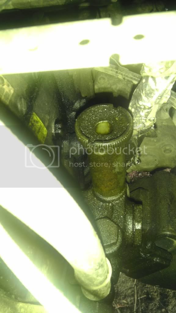

Anyways leaking at the priming pump where you would screw the plunger in. The rubber washer is all stretched out, any good replacment ideas? I can't be the only one this must be a commen issue.
On a 3b. I can probably run to mclendons find something unless there is a better option. I have time to order something because I was able to hold the washer in ans get it to stop leaking diesel for now.

Can't find anything, this is the one I have. Again sorry only have my phone and its a pita searching.

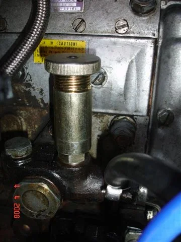

The plastic plunger and alloy body was OEM. Here's my original primer:
They're well-made and typically last 20 years without leaking.

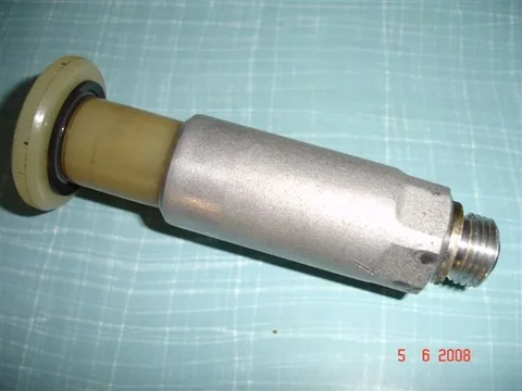

Don't make the mistake (like I did) of thinking all-steel (steel plunger and steel body) automatically represent good quality.
I bought this example from a well-known eBay seller and ended up dumping it within months due to leaking problems caused by internal design failures:
:beer:
PS. I respect both Denso and Bosch brands. That second primer shown above was unbranded.
