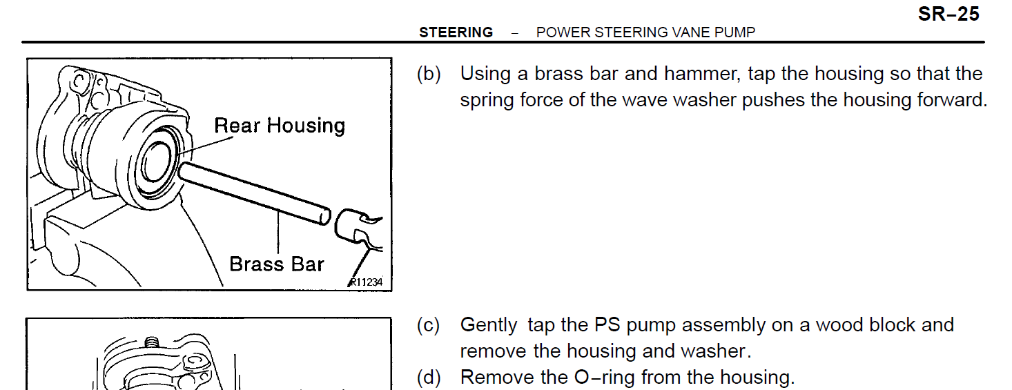

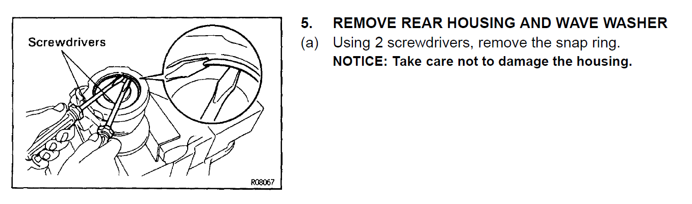

What would this process be? How do you get the rear cover off while still in the truck? Thanks.

If it's leaking out the back of the pump, determine exactly where it's leaking.
There is a round hole that has a plug with an o-ring on it that is not serviceable. It has been known to blow out this plug and immediately leak out all the fluid and lose power steering. I personally know three people this had happened to.
When Wits' End existed, he made an emergency plug for this purpose.
Personally, I would buy a new pump (Toyota) then fill that plug hole with epoxy before I installed it.
If you buy a remanufactured pump, that o-ring did not get replaced since that part is non- serviceable. However, it lived through the hot-tank and rebuild process just enough to not leak to make it to your doorstep.
