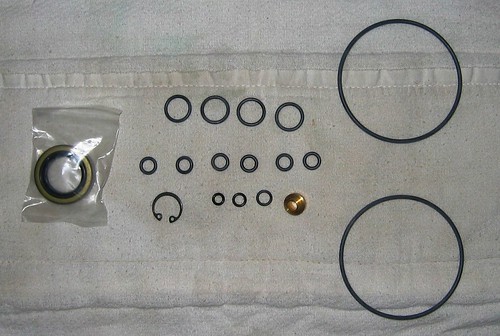

Here's the seal kit from CDan:
It was all pretty straight forward for the most part. I bought a couple cans of Brakeclean and sprayed the heck out of everything to get the gritty residue that was in the pump completely off of all the parts. Then, I put the new o-rings on (I soaked them in hot water until I was ready to install them to soften them up).
Question: Where do B, C, and D go? I didn't take apart the bottom half of the pump, so I do realize that E goes in the lower housing. D'Animal told me I'd have one small one left over, but that leaves me with a couple question marks. Any help?
Got the old shaft seal out and installed the new one with a "hi-tech" SST :rolleyes: suggested by D'Animal (a large socket with the rachet side on top of the seal. I put a small extension through the socket (reversed from normal use) and tapped on that with a hammer until it was fully seated. Worked like a charm...

Well, no one replied to my questions :o, so I decided to "wing it." Put the s-port seat in and seated it using the same method I used to seat the shaft seal. Torqued the housing bolts and saved the "extra" o-rings in case I discover later that they were important :meh:
