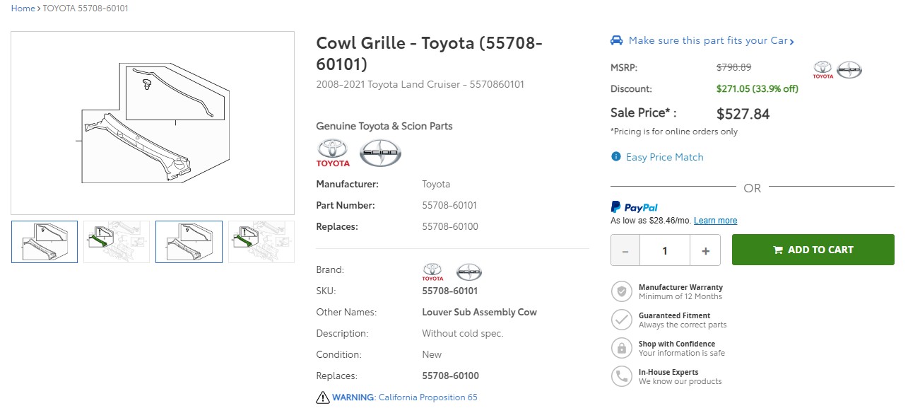

Is this the part I'd get to replace on my 2017 that has a leak issue now, post-windshield replacement? I've heard the price was supposed to be in the $200's but looks like it's gone up. Thanks in advance!

That appears to be the right part. It's a little cheaper from Partsouq. But maybe not cheaper enough to risk the international shipping. I ordered mine through IMPEX from Japan as that was the cheapest way to get it. It was around 400-450 after shipping. But the earlier ones are a lot more expensive than the 2016+ part. The 2010 part is $300 more so the savings was more drastic. Looks like you can order the new part through Toyota rather than Lexus which means it can be included in the 25% off parts sale. That's probably the way I'd do it.
It's $422 shipped through the Toyota sale.
