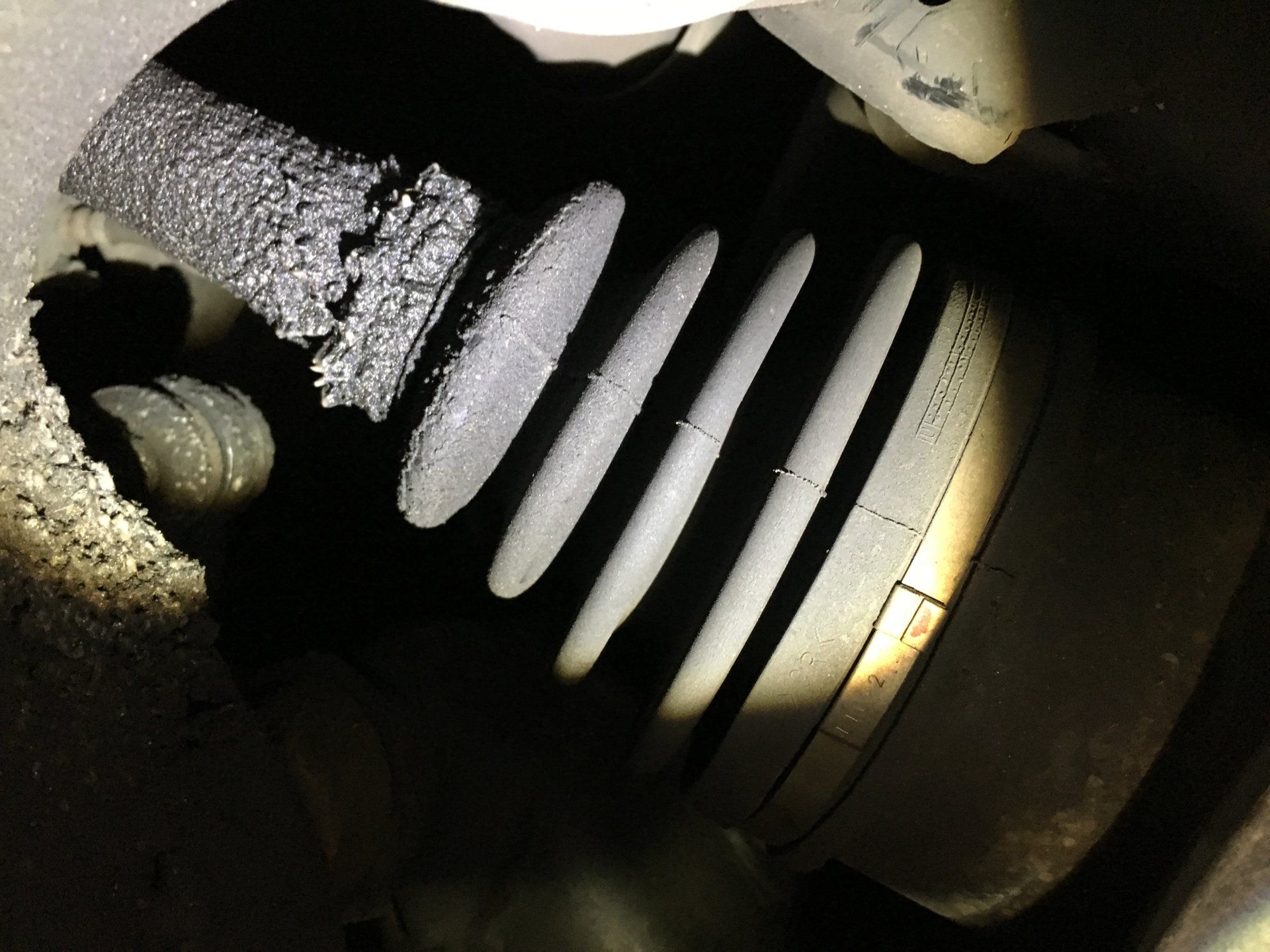

Wasn't sure of the best place to post this...I didn't want to resurrect an ancient thread.
What do you guys think? There's a shot of the passenger side and drivers side. I also posted a close up of the drivers side. Do you think I can get away with just putting new clamps. They recently started leaking. 2006 with just under 90k.
Edit: I think they are all driver side. The passenger side isn't quite as bad.
This was my logic...the CV boots on my truck were not cracked, and they didn't look frail. So i thought..."What do i have to lose by going the clamp route?"
So i had the dealer put grease into the existing boots, and install OEM clamps. $100 later, i was on my way.
There are other posts on here about doing the clamps yourself, but again, if the boots aren't cracked, give this solution a try.

I would try to get that nasty, grey grease out of there as much as possible before filling with new, fresh grease.

I'm assuming they're leaking at the small end?
If the boot/shaft interface is contaminated with gunk it's possible that they won't seal. I'd take off the clamp, wipe it clean, slide the boot back and forth, re-wipe, etc until it's a good, clean mate and then reinstall the clamps.

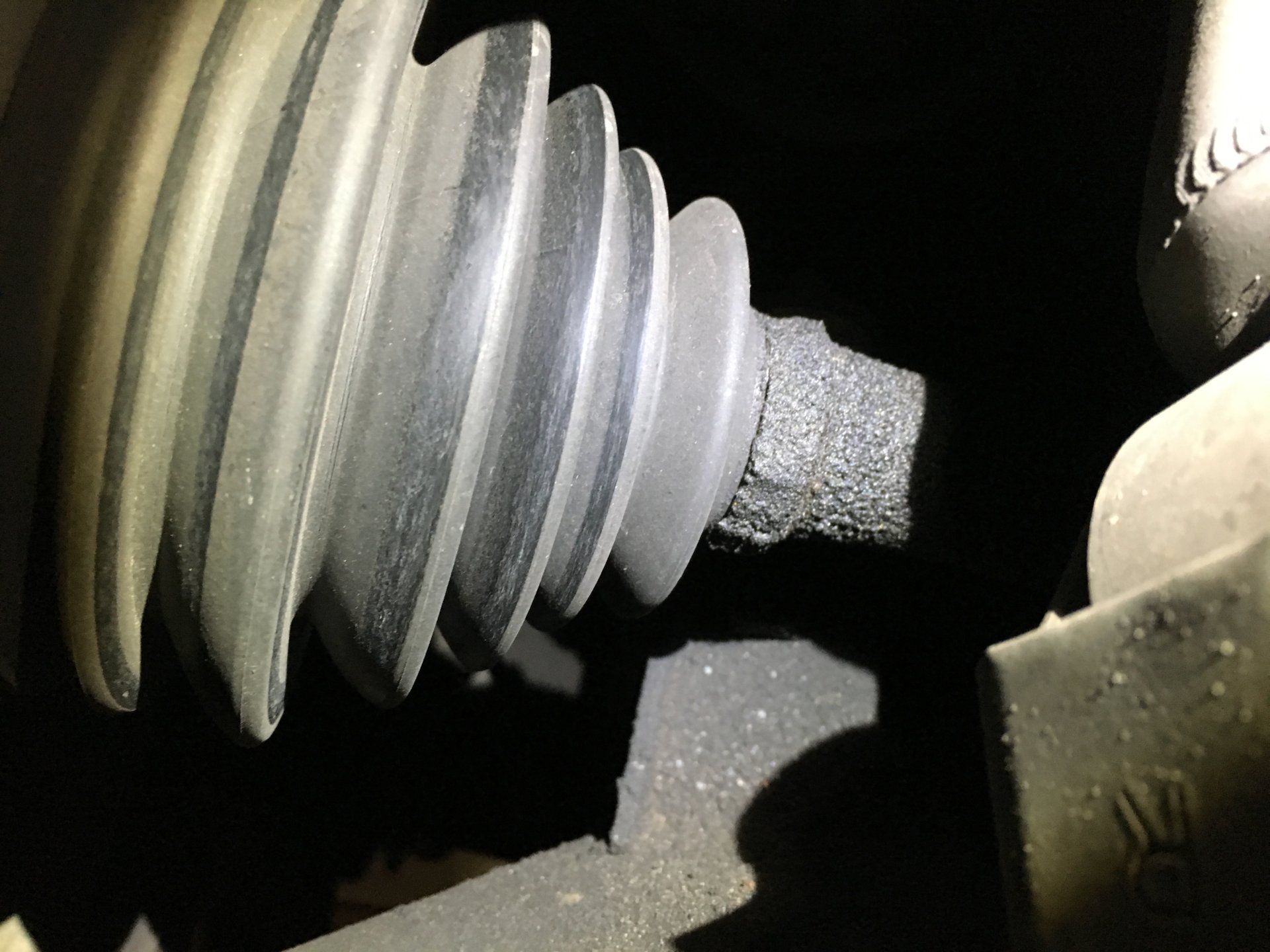

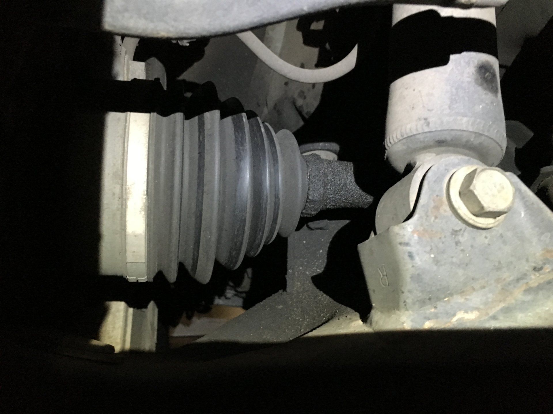

Below are pics of my driver side front axle boot.
Just my 2 cents - I have looked at many 100 series over the years, and a majority of the front axle boots I have observed have some leakage on the small end of the outboard boot. (the ones in the above pics look pretty typical).
(Perhaps Toyota designed them this way so the grease they sling around would act as rustproofing for the front suspension components? :-)
Unless you are doing a lot of deep water crossing, I don't think this small amount of leakage allows water or dirt into the cv joint, and I wouldn't bother with reclamping / regreasing at this point. Do however keep an eye on them as I have had boots split with as little as 110K on the odometer.

Unfortunately, I'm reviving this thread seeking some advice. 1999 100 series with 147xxx on the clock. While installing my new Ironman suspension I noticed a fair amount of grease on the inner driverside wheel, fender, lower control arm area. Like an idiot, I wrote this off assuming that the dealership made a mess while repacking the wheel bearings a few months back (no mess before I took it in). Since then the truck has driven fine, no clicking/vibrations. Upon completion of my Ironman install, and cranking the new torsion bars (+20 turns each side after seated), I noticed/felt a slight clicking noise on my test drive (~5miles). Not having much experience with this type of work I assumed I forgot to fully tighten one of the many bolts during the install. After a thorough inspection, I noticed a very small tear on the outer, driver's side CV boot and determined that to be the culprit.
So, my questions:
1. Is my CV joint toast and now in need of replacement?
2. Is there anything else I can do to determine the extent of the damage? ...other than taking it to the dealer
3. Is the CV joint replacement the same as replacing the axle shaft? ....that may be a dumb question.
