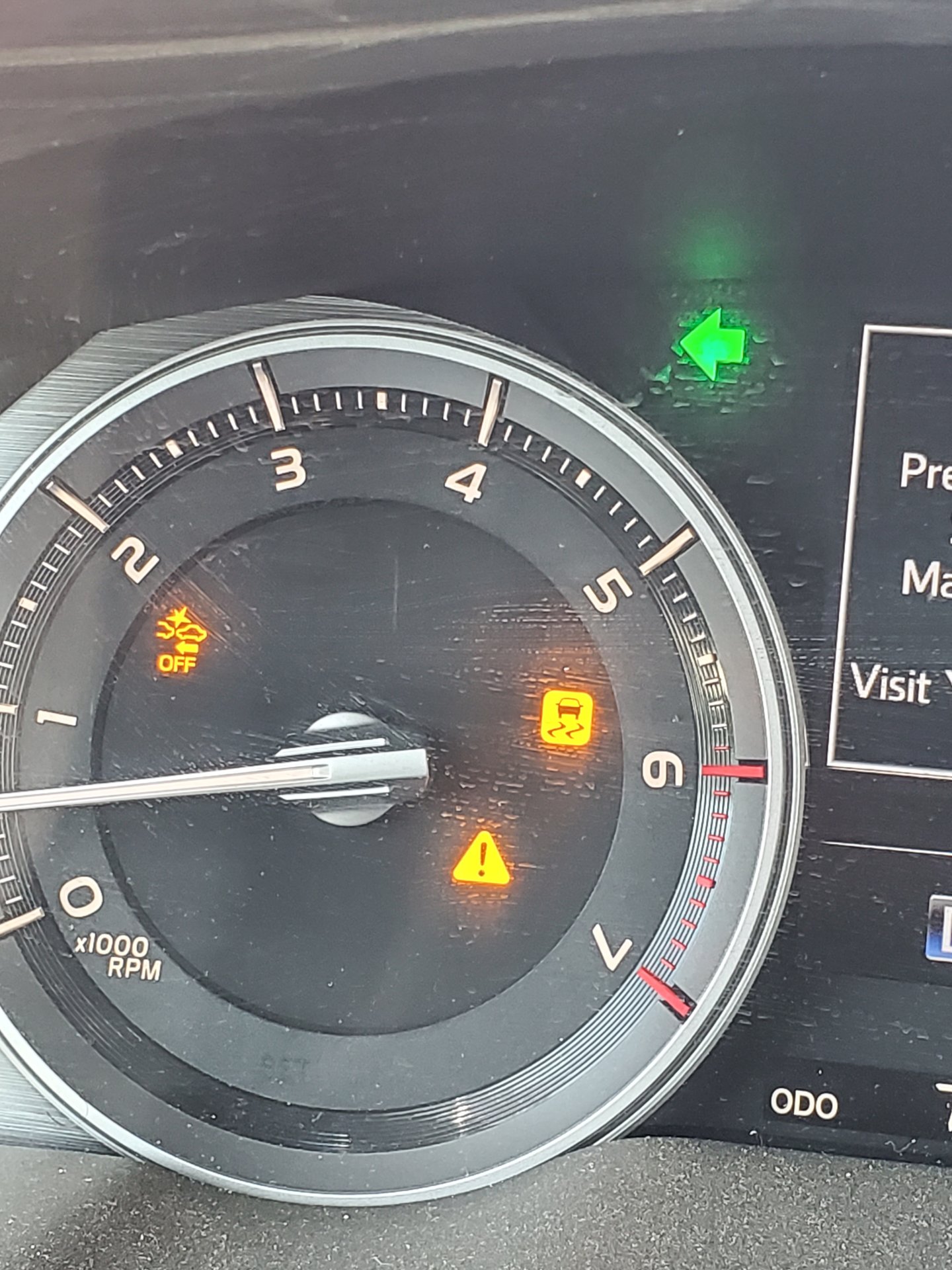

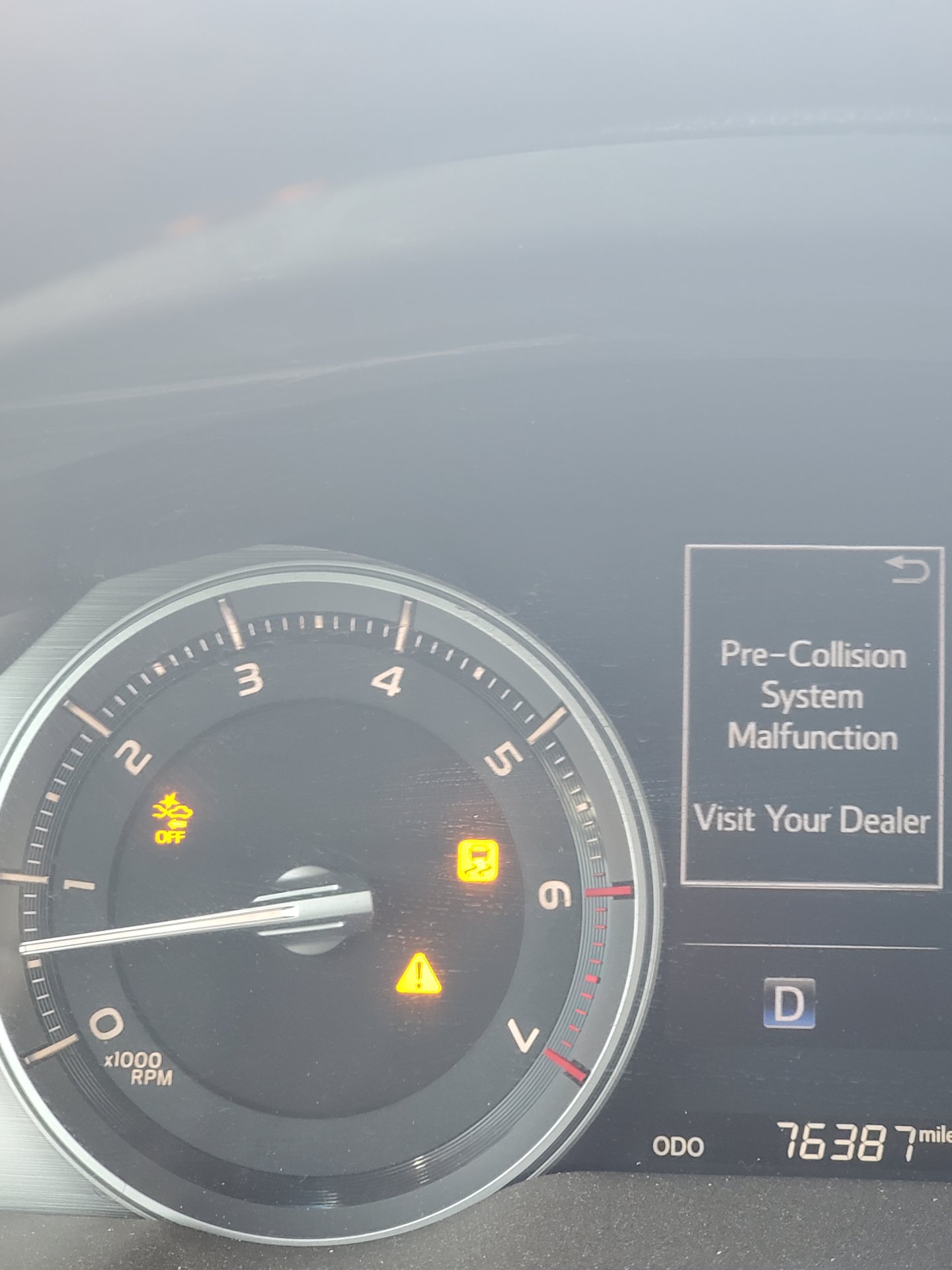

And the hits just keep ****in coming. Backing into a parking spot last night, there was a pop. And then this motherucker lit up like a Christmas tree. So im clearly nowhere near fixed. Should prove an interesting 1775 miles home.

For the pop… your dash says PCS unavailable, which seems odd but is probably just one of the systems which shuts down with whatever went wrong. Can you pull codes using OBD Fusion or similar? I would expect that to pop up if the radar sensor is borked. I think it’ll also disable if traction control is disabled or a wheel speed sensor is bad but I need to check the FSM and I’m traveling until Monday

I get the PCS warning often in the winter when the sensor ices up. But I don't remember it throwing the traction light. It just warns you that the AI brake has left the chat.
I like with wheel sensor theory. Without full ABS authority both traction and PCS would be inhibited. But shouldn't there also be a red brake MIL illuminated?
Steering angle sensor perhaps?
