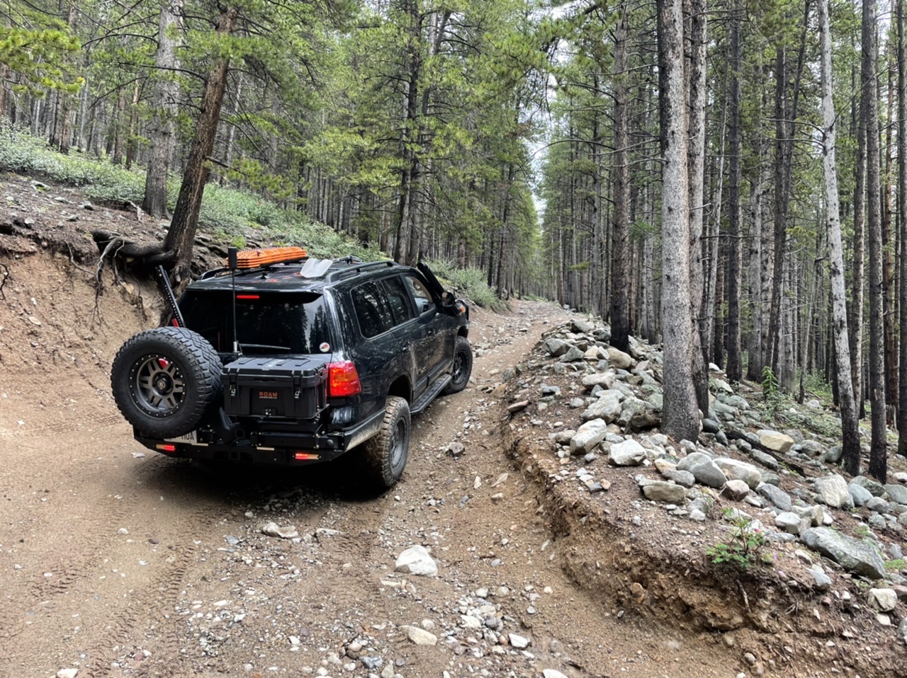

Staying in Blue River and noticed the trail head for Pennsylvania Creek trail that connects to Boreas Pass trail. Pennsylvania Creek was pretty fun. Pretty narrow and there are spots where two way traffic is hard.

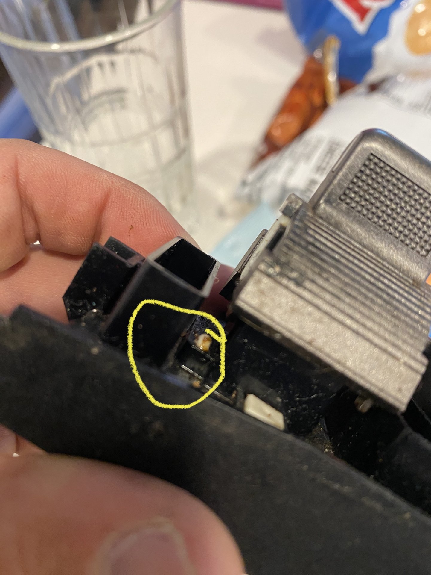

I need some help!
I’ve used 4lo twice today without issue. Third time I flip the switch and nada. No ligjht, no sound, no beep.
I pulled the battery a couple of times too. Any kind souls want to meet and help me debug?

EDIT: For those with 2008-2012(11)…
If your 4Lo switch/knob has no effect, and seems to turn too easily…do this:
Pull the rotating switch/knob straight off. I mean…REMOVE IT. Now try pushing/turning it without the knob on there… Also…look at back of knob to see if the little half-circle piece that turns the actual knob is broken.
