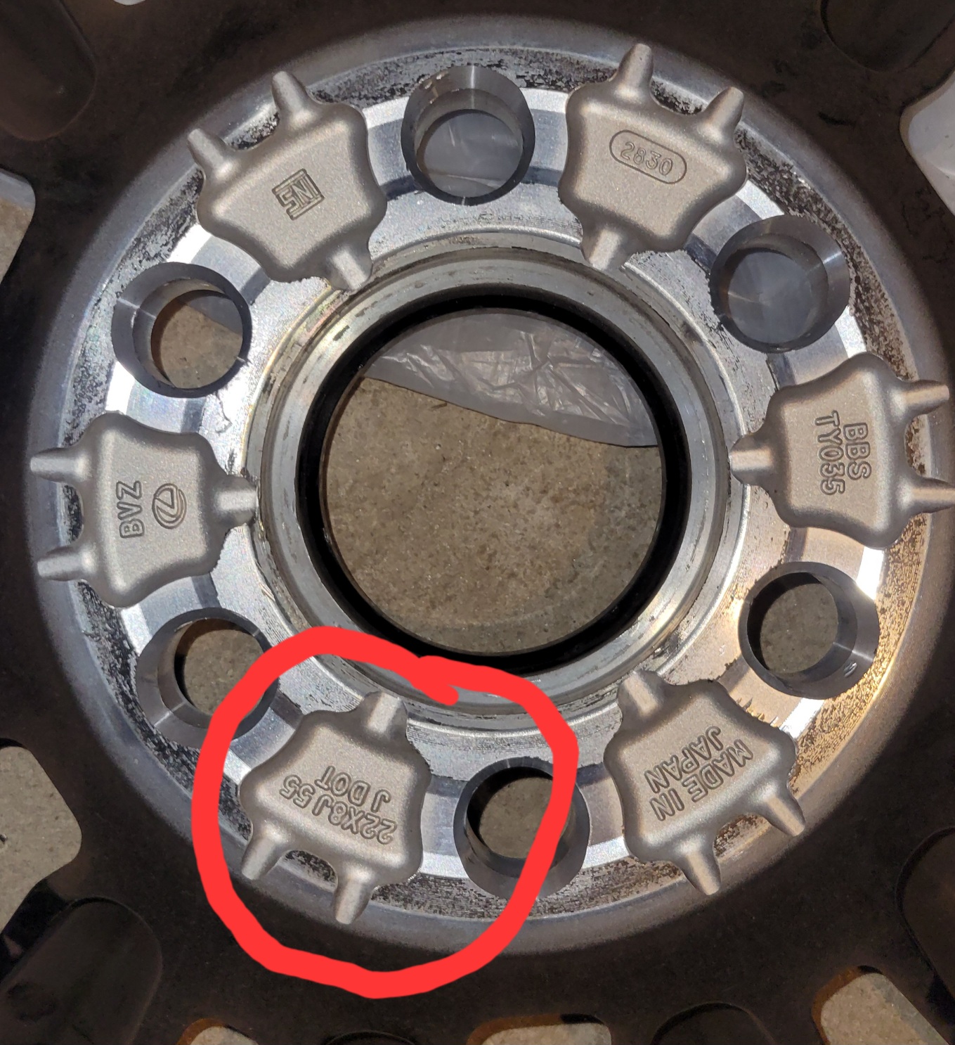

FWIW, the offset on the stock 22" rims is 55. The TRD Pro BBS rims from the new Tundras/Sequoia's is 47.
Here is a picture of the back of one my 22's that I took off.
Thanks for sharing.
The numbers I mentioned were for the Toyota LC300 from the tech info.
I havent checked the LX wheels but I also would predict all LX wheels are pretty much the same range as your 22.
