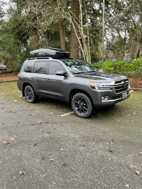

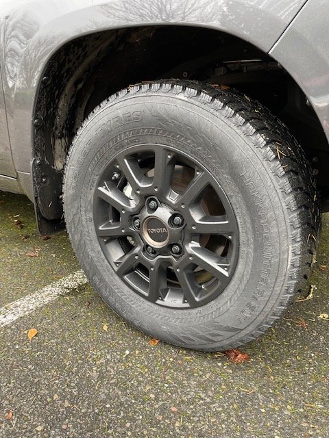

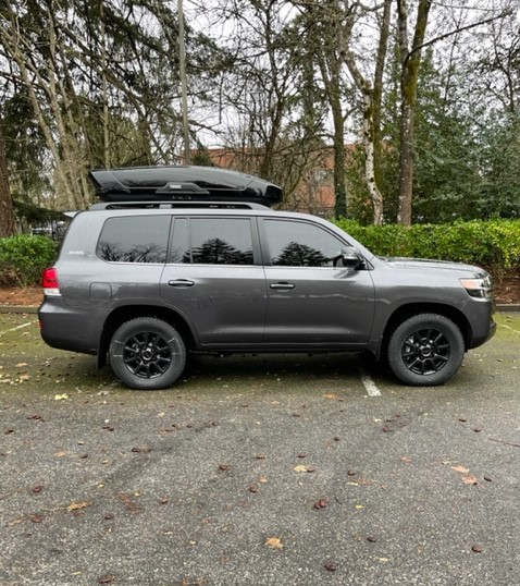

I decided to go with the HAKKAPELIITTA R3 SUV 275/65R18 116R SL. So far I'm happy with them. Looking forward to trying in the snow soon.
Thanks to @wiseinvestors for the idea of modifying the Tundra center caps with the Toyota center plate from the heritage wheel.
You running stock setup w/ suspensions/lifts etc? I just ordered same size and same tire based on your post for the stock wheels. Running stock. Seattle seems to be getting more snow than usual this year, and I need to hit some pretty steep and icy hills so trying to find more traction
