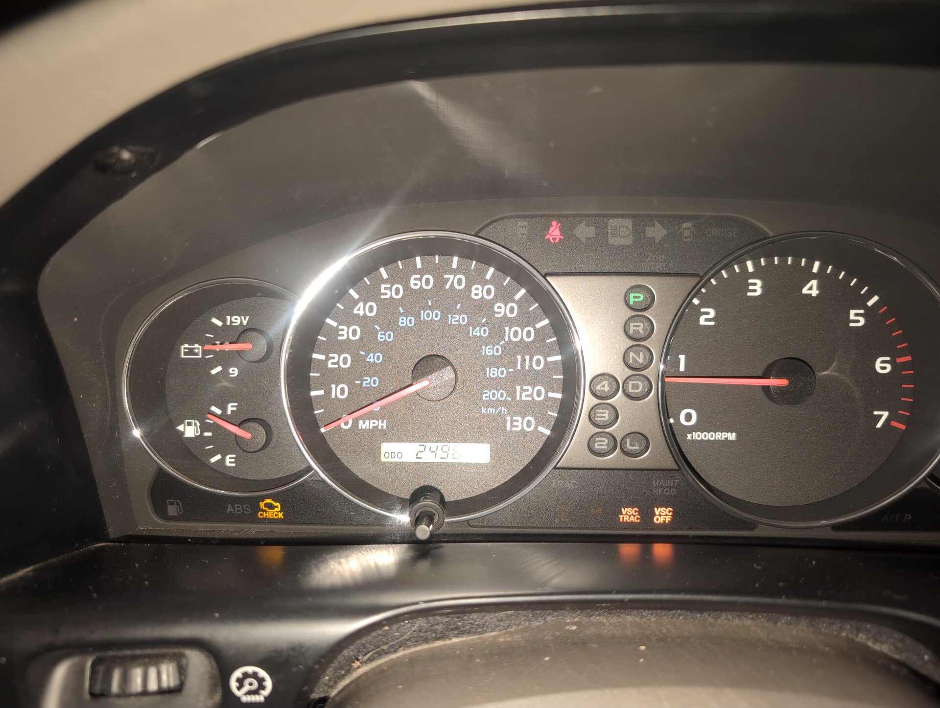

Yesterday, the CEL, "VSC TRAC" and "VSC OFF" lights illuminated alltogether on second drive after taking possession from the Honda dealer that I bought it from. At first I was worried that this was the dreaded imminent brake failure so I returned home ASAP, there was no ABS light or alarm, so hopefully that's not something that's in store for the future. Truck seemed to function normally on the 2-3 mile return trip home. I'll be searching the site for info on possible cause. According to CarFax, the truck was serviced multiple times at a local shop, so I might drop by there to see if they might be willing to talk about some of the vehicle history. Any thoughts, suggestions, or referrals to links is greatly appreciated!

Congrats on your purchase! In my experience that combination can be something pretty minor think misfire or evap stuff. I would suggest getting over box store and have them check the codes (betting there will be a couple) and then we can help more. As an aside, think about getting a code reader such as Carista or if you are more into it get a techstream set up on a laptop.
Finally, if those service records are from Toyota dealers. It might serve you well to go to Toyota.com or a dealer and pull the service history. It will help get an idea of anything minor that might be needed.

As someone else mentioned getting an OBD II scanner is a good idea to check your codes. I had the same lights come on recently, the truck runs smoothly and I wouldn't know anything was amiss but for the lights. The code I got was P0333 (knock sensor 2 - high bank). The lights have been coming on and off for the past few hundred km - they've been off now for the past 130 km or so. Others with this issue have replaced the gas cap - I did as well but not sure if that's what it was, also checked my fuses. Fingers crossed and hope that the lights stay off. I don't plan on doing anything unless there's indication of a performance issue with the engine. I've read posts where others had this issue and it just disappeared on its own.

Thanks for the info and suggestions, guys! I still need to get an OBD scanner, but I took it to the local O'Reilly and it threw P0430 code which looks like catalytic/O2 sensor... the guy reset the code, I replaced the fuel cap and haven't driven enough to see if it returns. Truck seems to be running good so I'm keeping my fingers crossed.
