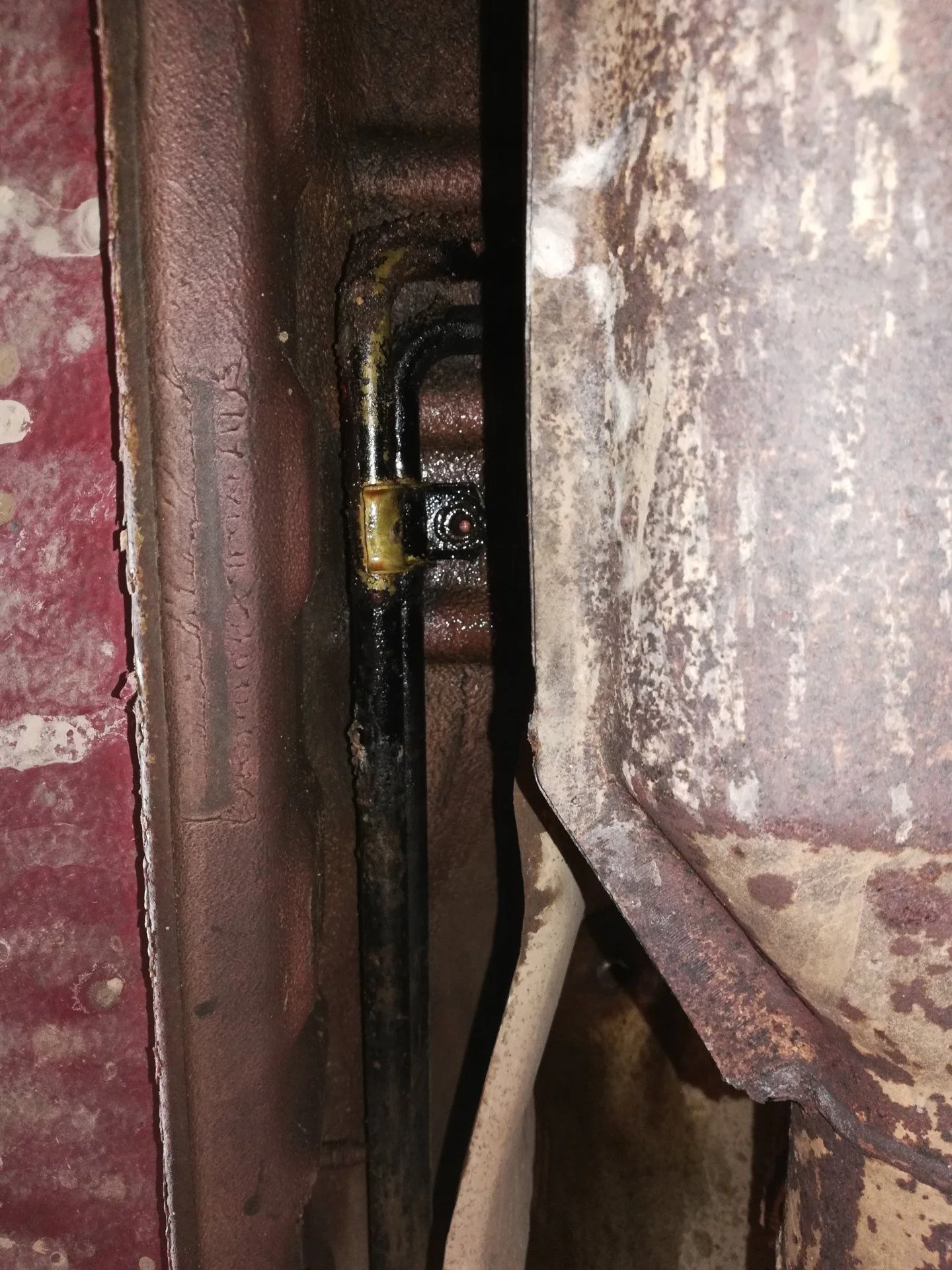

It seems that the rear soft lines are crimped to the hard lines and can't be easily replaced by themselves - probably what lc4life meant by "not serviceable". There are some soft lines upstream that I'll be replacing while everything is apart.

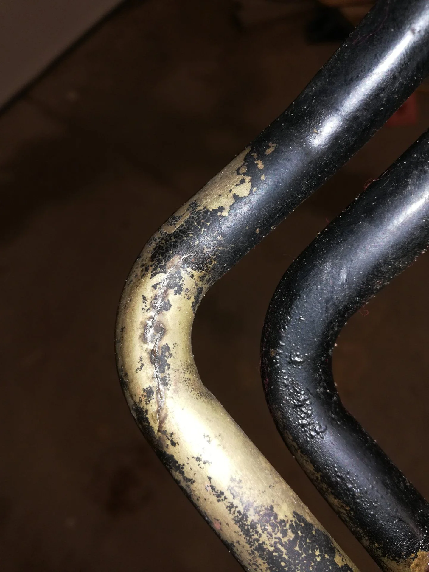

So got the lines replaced. Leak was in the hard lines. Cracked along the top and bottom in the corner. The old lines were brass - new one is steel. Soft lines were in remarkably good condition for 26 years old. Replaced them anyway.

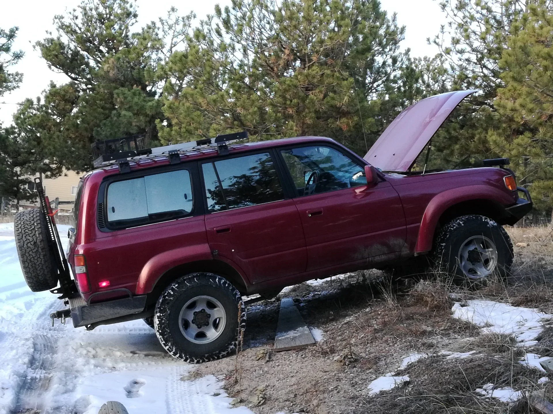

Filled it up - took nearly 2 gallons, which is about half the capacity. Started up and no leaks :bounce2: but no heat from front or rear either :bang: I let it idle about 15 minutes, revving to about 2k and guage indicated it was up to temp. So I'm guessing there's air trapped in the system somewhere. I'll check the level again in the morning when it's cooled off. Any suggestions?
Put it nose up on a hill this morning and ran it for awhile with the radiator cap off, and now I have heat! Took maybe another quart of coolant.
