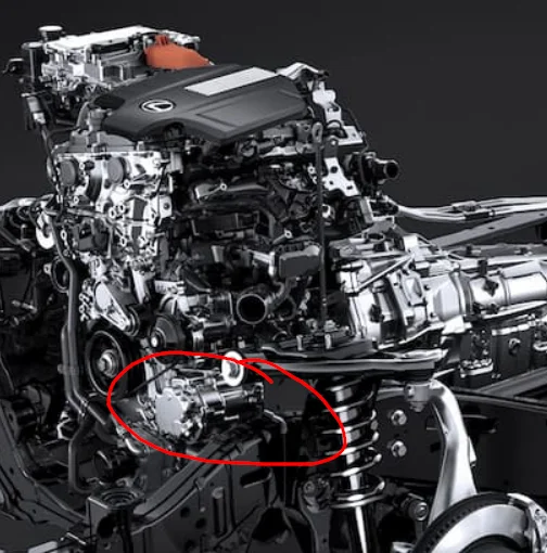

I understand the electric motor is situated between the ICE and the transmission.
So unless the AC compressor is electrically driven vs a legacy belt drive unit, I don't see how the air conditioner will function without the engine running.
Edit: I can't quite make out which accessory is the AC unit this image, but perhaps this is it; whatever this accessory it may be electrically driven:
The Tundra hybrid is an electrically driven AC unit. I'd guess that red circle is the same unit. It is a hi-voltage system component apparently. This is from the Tundra manual and letter F is the AC compressor:
You answered your own question — the AC on the Prius is driven by electricity, not a belt.
Yes, hence the edit. I wasn't aware of how the Prius's system works until now.
