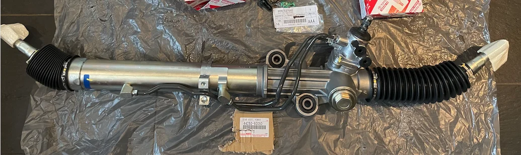

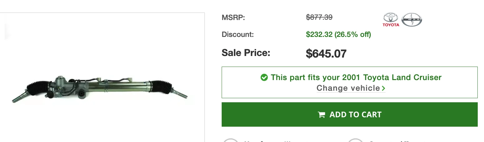

I just did the whole rack as I had fluid leaking also. It's a pain to do.
Rack and Pinion - Toyota (44250-60050)​
OEM Toyota Rack and Pinion For 1998-2003 Toyota Land Cruiser
