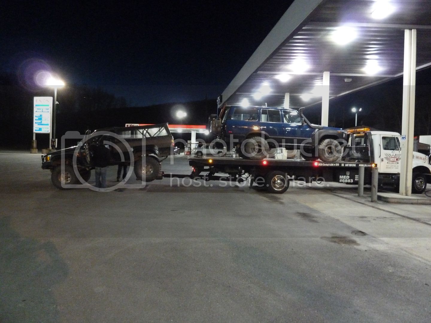

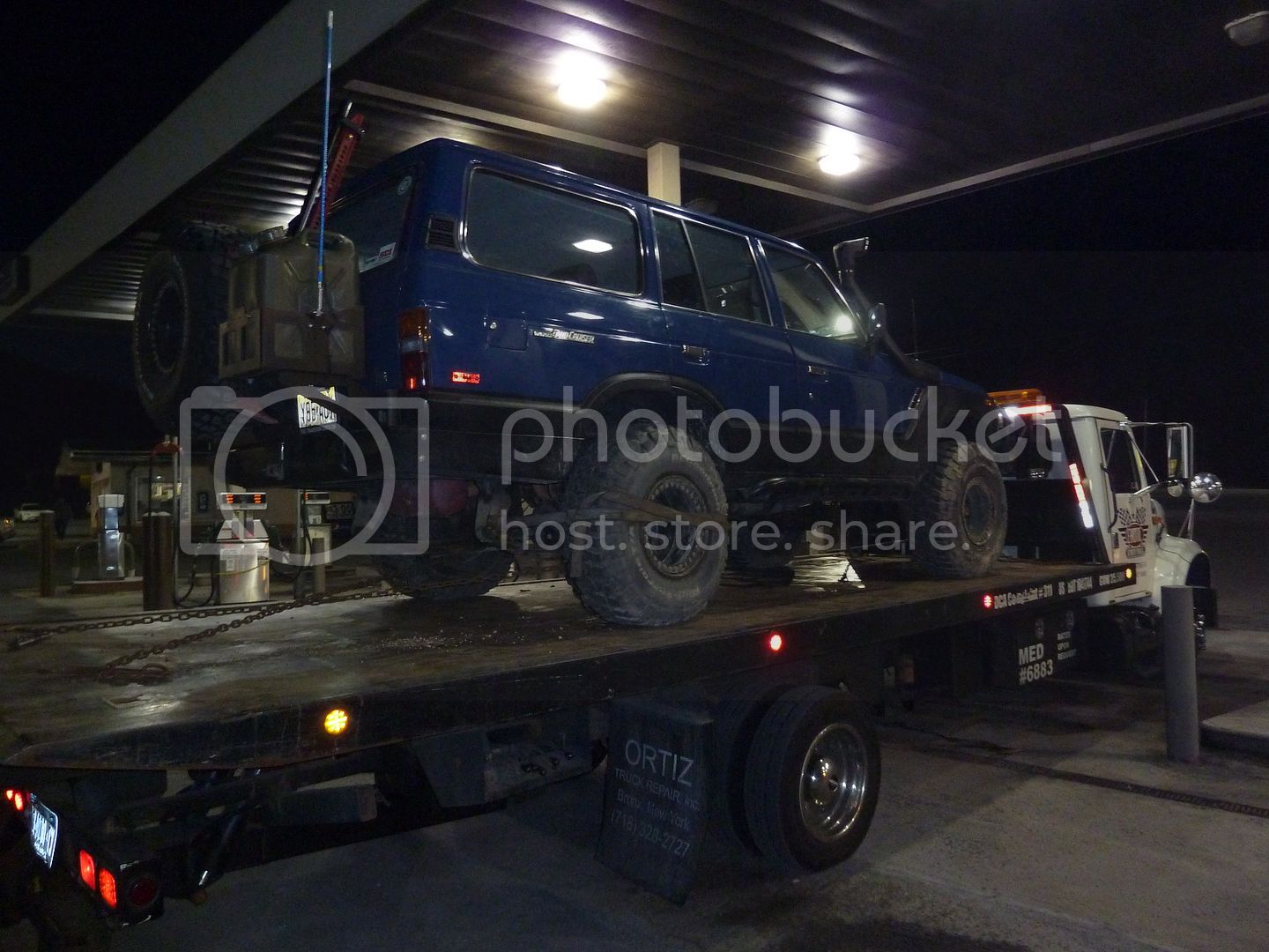

Loooooong day at Rausch Creek-
Passenger birf and passenger rear axle shaft
Luckily the flat bed belongs to the brother of the owner of the 4 runner.
time to go Chromo!
That sucks man. What trail were you on when it broke?
It was the hillclimb on trail 6 - I've done that at least a half dozen times - even with my FJC. It looks like this past winter changed the trail a whole lot. It took about 4 hours to get me out of there. We positioned a truck on top that I had my winch hooked up to so I could control my backwards descent and one truck down at the bottom with his winch pulling me down.
Sounds remarkably familiar to when I blew up two birfs and a rear axleshaft all in one shot at Dave's Place on Memorial day last year:lol:
Funny thing is that we you told me that on Saturday over the grub at the Bronx Alehouse, I thought to myself - s***, that would suck huge....LOL>.....It does...
