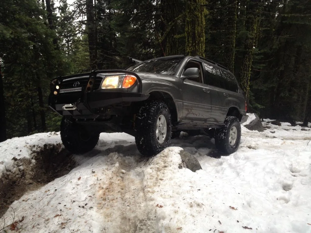

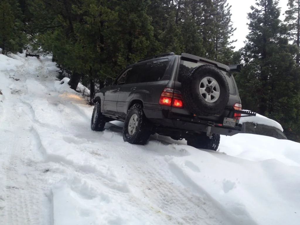

I had 35s on mine with no lift for a while,didn't take it off road but no rubbing on the street. The trick on these rigs is keeping the tires inside the wheel wells. I have 2 1/2 in lift with stock wheels and 1 1/4" wheel spacers. The problem is when you lift them the track width narrows and the wheel spacer are needed to correct that. But when the suspension compresses the track width get wider so the tire no longer compresses inside the wheel well. My front tires will contact the inside edge of the fender hard compression but had not hurt a thing.
35s, stock
View attachment 1006922 I did consider a body lift, but if you plan on adding a winch bumper I would not go more than an inch. If you go any higher and you correct the height of the bumper your winch will set much higher on the frame, thus causing way more stress and leverage during winching
This is an awesome looking rig my friend! Wow how those wheels fill the wells so nicely! So no rubbing even on road bumps hard turns... That's great!

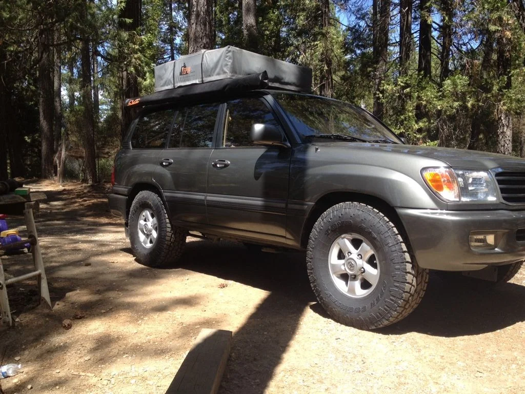

Thanks, but it wasn't that way for long. But no rubbing at all on the street. I did have to bend over the pinch weld.
Here is how it sets now

What tire size, exactly, are you running with the stock 16" rims? I can only find the 315 or 12.5" width, which I feel is too wide. I don't want to go any wider than 295 or 305 at the absolute widest. I'm not going to be doing a body lift and I want to avoid rubbing with the right tire width, spacers and longer bump stops.

I ran 315/75R16 Fierce Attitudes (stock wheels no spacers) on stock suspension with leveled t-bars for a few months until I got rear springs.
Just trim the plastic in the offending areas with shears and beat the pinch weld with a BFH.
