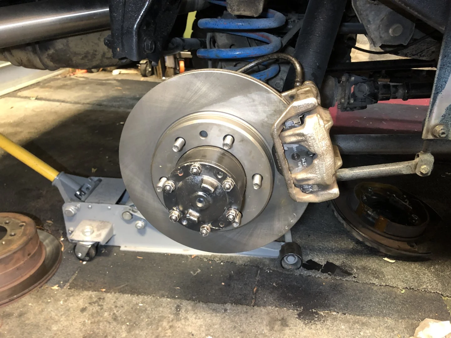

Wow, that rear transfer case kit is bloody expensive for a design with some pretty fundamental issues (EG it relies on all 4 wheels being on the ground and is a single point of failure).
I reckon I could put a kit together for less than that to convert to a proper caliper with electric handbrake like I've done on my 80. Works 1000x better than stock and has redundancy (each individual caliper is capable of holding the entire cruiser on a very steep incline and never needs any adjustment).

you have a good point there about all 4 wheels having to be on the ground. please share what you have done on your 80 I'm definitely interested in what you got... all I see above is a rotor and caliper ;)

Are those the RX350 calipers? I've been looking into that
