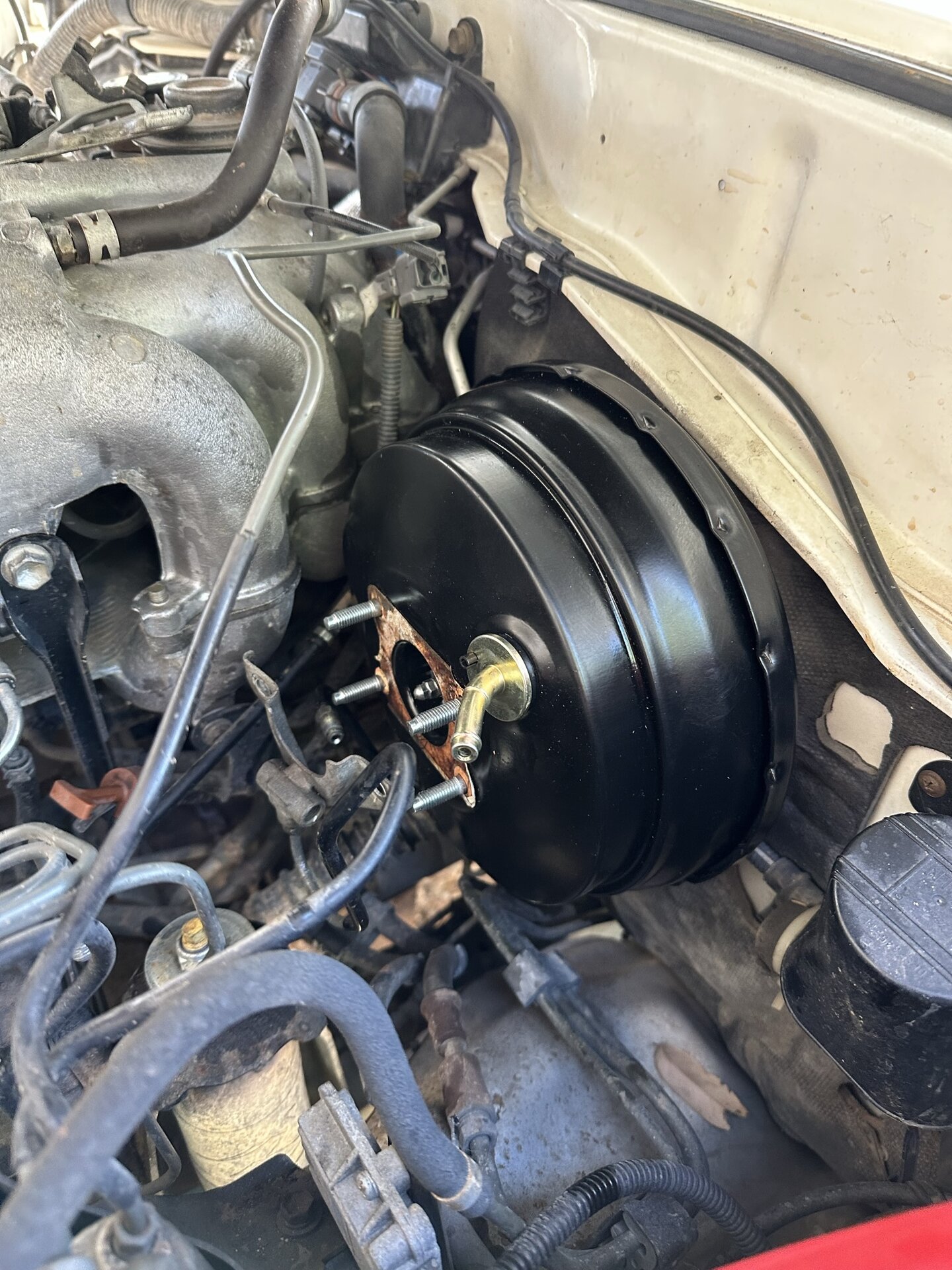

OK, I'll be the test case for this one... $70 vs. $600 for OEM. I'm sure I'll regret it though.

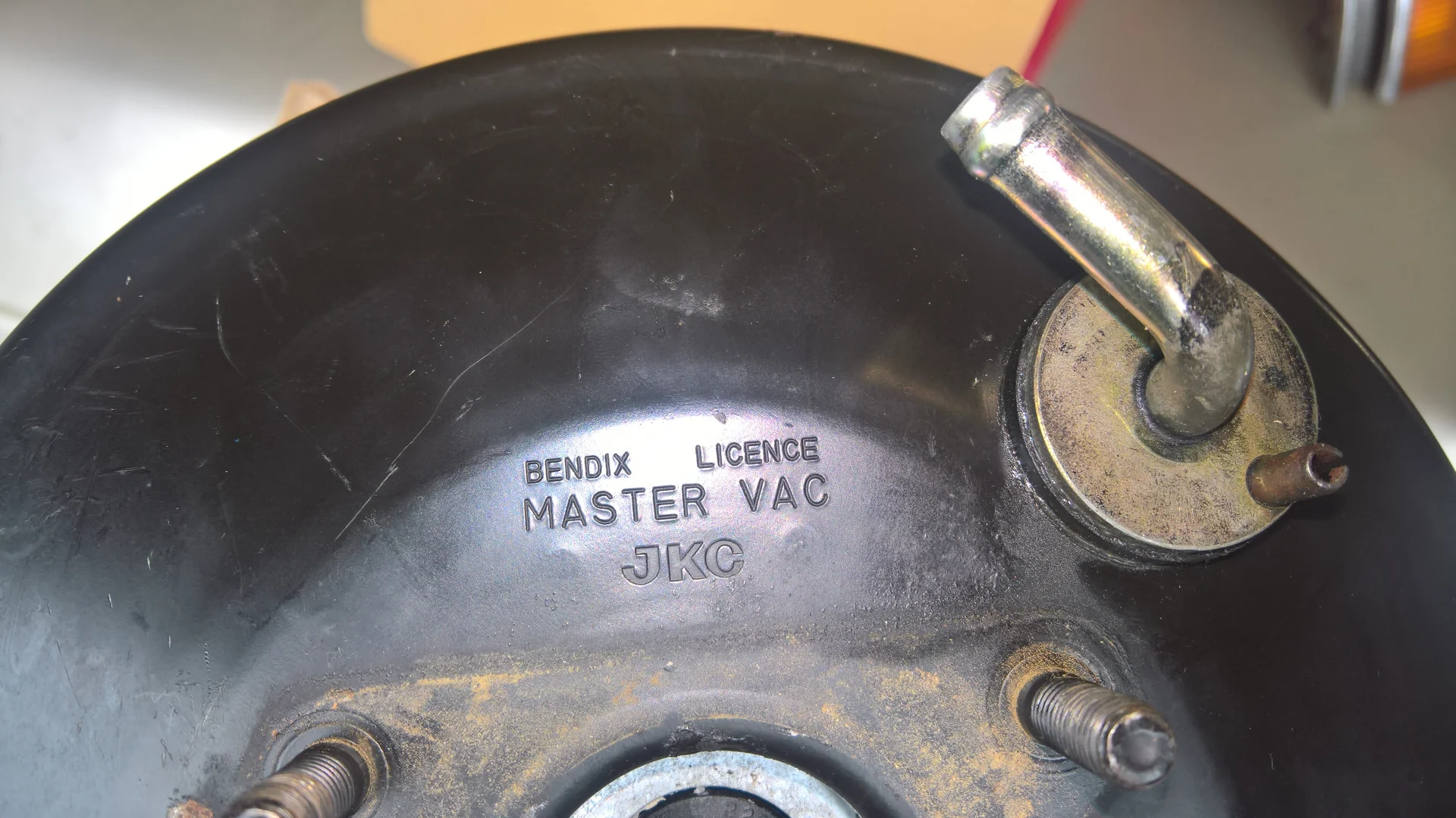

Was the OEM booster from JKC?

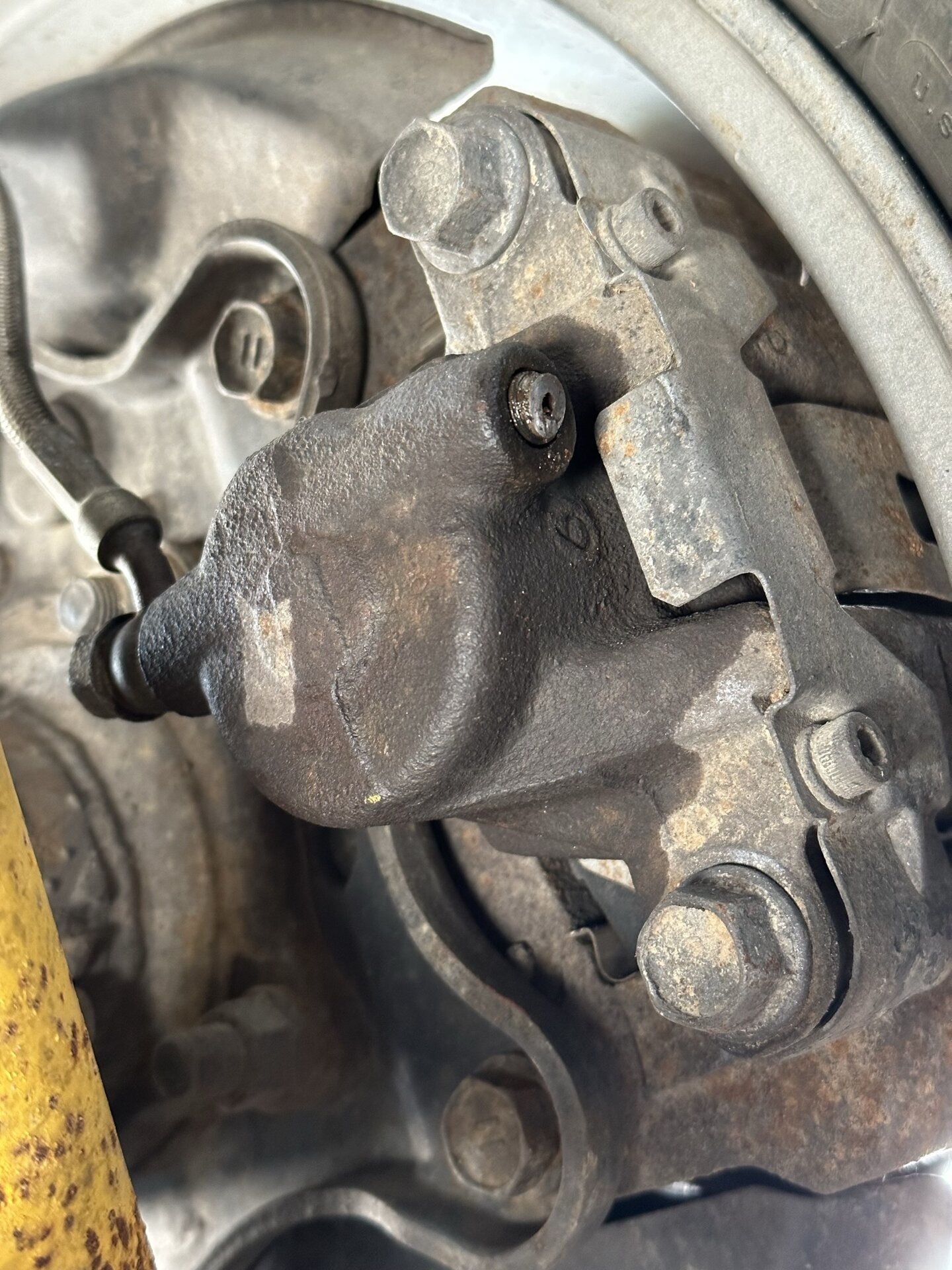

I had to lift and tilt the engine to one side to get the booster past the manifold. I'll bleed the brakes and as soon as I replace the bleeder screw :| Anyone have tips on getting this out? gonna try the usual ways.
I'll probably upgrade to a better one but geting parts for Partsoque takes a while and I need it for SAS.
"Was the OEM booster from JKC?"
Been discussed in the past:
The Seiken booster compared to the Toyoa part appears almost exactly identical (IME the rubber boot is a slightly different design) but both have the same letters stamped on them, same paint (high gloss black), same valve design/plating, same stud design, ---.
By itself some people say that does not mean they're both made by/for Toyota (I'm not taking sides either way, just interpreting previous discussions, read the thread linked above to draw your own conclusions):
FWIW, installed a Seiken in my 97 model a couple years ago, it works and looks right (if that's a factor for anyone with LC OCD ;)).

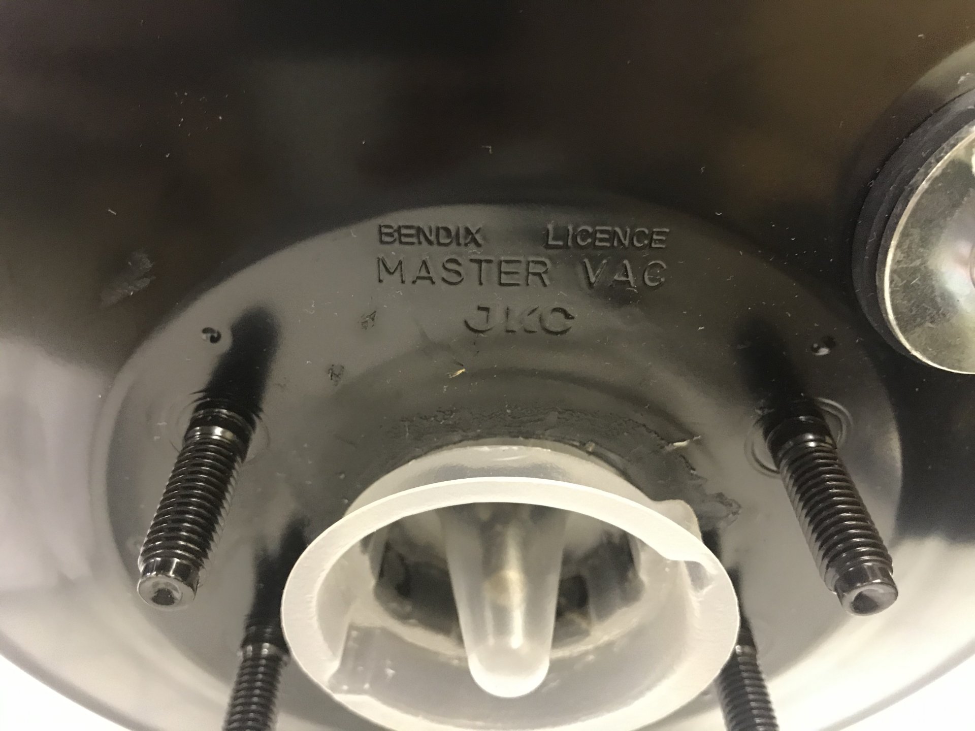

Toyota booster (original from 1997 FZJ80):

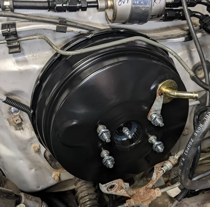

New Seiken brake booster for FZJ80:
@TexFJ : what markings/letters were stamped on the cheapo booster from Amazon? Country of Manufacture listed anywhere?
They appear almost exactly identical (IME the rubber boot is a slightly different design) but both have the same letters stamped on them, same paint (high gloss black), same valve design/plating, same stud design, ---.
No Markings at all....
Got everything bled. First impression is that the booster doesn't perform as well. The OEM booster was very sensitive while this one works but makes you want the soft touch braking of the OEM booster.
With that said, perhaps my previous system needed a better bleed job but it always scared me that I was getting to the bottom and still looking for braking power. The replacement system has me pushing and still finding braking power the more I push down at the end.
I'll probably replace it with the OEM version when I have more time.
Das it.
@TexFJ : Could be some air in the system; did you replace/open any lines or replace calipers and did the reservoir ever go dry??
How did you bleed the system?
I think that my air is gone, could have been the problem before hand. I bled the master cylinder since I disconnected the lines to get the booster replaced, then did the whole RP,RD,FP,FD,LPSG, PV.
The Brakes aren't soft, which is the sign of air in the system. The pedal isn't as sensitive, if that makes sense.
I picked one up to try. Looks identical to the original OEM one. Doesn't come with the gaskets.
I returned one because the M/C mount, relative to the firewall mount, was rotated a bit too much for me and was visually noticeable. The second was much better. The OEM has some rotation too, but only about 1° and I never noticed it.
