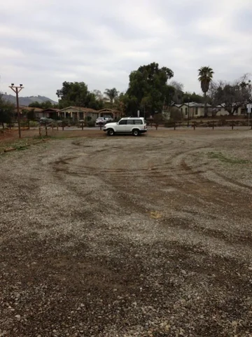

Next item is my rear locker not engaging. CDL in lo and light indicates it's locked. Abs turns off. Rear won't engage, but front engages. Or maybe rear engages and I can't tell. Fronts engage because it gets very tight. Def locked. I have read a few items such as paperclip/figure 8s/slight hammering on actuators to loosen magnets. Can someone help me with this. Suggestions???

My rear diffs have always taken longer to lock up than the fronts. Could be they just need a lot of exercise. Get her dirty, lock up the rear and do a lot of slow curvy turns to get them to unstick.
Ya. That's what I was wanting to do. Perhaps getting the truck in some rugged terrain and trying out the lockers may do the trick. I have been exercising the lockers near my house at a very large gravel area. Maybe I need to try them more often.
Doing figure-8s in the dirt helped me get mine to start locking properly.
Hey Matt. Just wondering. When you were doing figure 8s on your truck to engage the lockers you had the indicator lights blinking on the dash until it went solid??? I don't want to destroy anything on the axle. I just don't know if attempting to lock and driving while light is blinking is a good thing.
Thanks.
Doing figure 8 on very loose gravel so it won't bind when locked with solid light. Spray some wd40 on the housing to help it loosen up.
Mine was never used for 15 yrs until I bought it. Had to tap on it and let wd40 sits couple days then it finally locked after couple figure 8.
Thanks Peter. I'll give that a try. I know there is electrical connections down there. Don't want to fry anything.
Thanks.
That's exactly what I did. It's ok to drive it in circles while it blinks.
Good morning gents!!! Well it happened this fine Sunday morning. I'm officially 3Xs locked!!!!!! Thanks for suggestions. Sprayed some wd40 on front and rear locker housing last weekend. Figure 8s this morning. Voila!!!!!
