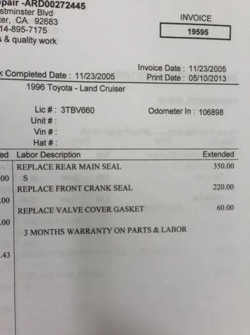

Ok. Now for some questions about maintenance history. Of course one of the concerns for our trucks is HG failure. Well here's an invoice from 2003:
And here's an invoice from 2005
And here's an invoice from 2009
All of these invoices have the valve cover gasket being replaced. Is this the HG that we all speak of? Please school me.

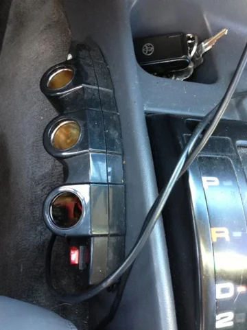

The PO was the owner of a Electrical firm/company. A bit of a tech so the truck came equipped with a few interesting and cool items.
Aux for my iPod!!!!!!
Pioneer touch screen Navi/Bluetooth/Rear back up camera!!!!! Safety. Especially with my lil critters running around.

She cleaned up very nice with the detailing. Hate to burst your head gasket bubble, but the valve gasekt is the easiy one on the valve cover, and is not the dreaded head gasket. Regardless, you've got yourselve another great cruiser.

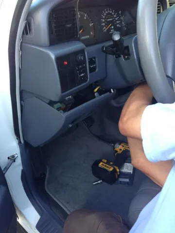

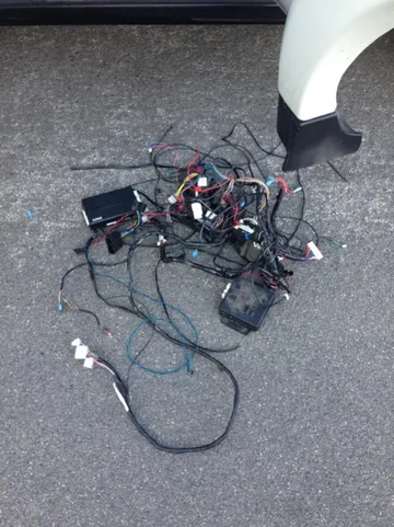

Stoked!!!!!!! Electrical gremlins defeated!!!! I was having issues with my lights not turning off. Here's what made them go away.
Viper Alarm 5701 on top of the existing factory alarm back from '96!!!!!!! GONE!!!!!!
Now. I get in La8enta. Starts when I want it to. Door locks are back to normal. Lights work the way they should. Driving it to work tomorrow!!!!!
Btw. I did not do the work myself. Called my cousin. It was too much for me. Daunting. Down right scary. Wires all over the place!!
Congrats! I had to do the same to my old truck. I have an aftermarket alarm on my truck now that I may remove eventually. I have it on a very short leash. Once it starts acting up it's gone.

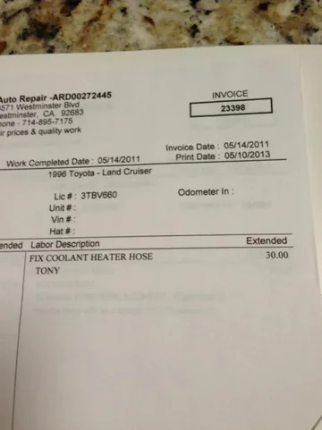

Thanks Brent for letting me know about the valve cover gasket. So.......... Now a question on the PHH. Looking at this receipt
Is the bypass hose and coolant hose the PHH that we need to replace? If it has been replace. How can i tell? If not. What hose does need to get replaced? Name?
Boy - it certainly could be the PHH by that description. If you know where it is, you might be able to tell by the look/age of the hose. You're showing the labor descriptions. Any part description on the left of the invoice?
Regardless, that was almost 7 years and 100k miles ago. If it was a factory PHH you may want to replace it again anyway. Go with the silicone and never worry about it again.
Ok fellas. Here's the part description pic of the invoice
Not much of a description.
But here is another invoice from 2011.
I know the location of the heater hose. I can't really tell if it is newer though.
