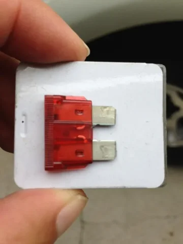

I few weeks back I had some electrical gremlins messing with my lights and aftermarket stereo. I was bummed because I had no toons and kept playing pandora from my iPhone. Well. This morning I checked a few fuses from the instrument panel. Then my dad looked at me and asked me to take a look at all of them. Instrument panel fuses were all good. Then I checked fuses from fuse block from inside engine bay. Here's what I found!
Voila!!!!! After replacing it all my dome lights worked! Clock worked! Chime for keys in the ignition switch and door open sounded. And most importantly my stereo with aux and back up camera worked!!!!!! Today was a good day.

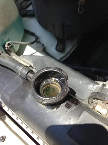

In some of my previous post I indicated my concern for HG issues and failure. I was concerned about my radiator and the over all condition of cooling system. Truck got a new radiator in 2009 done by the PO. Well I noticed a bit of sludge build up in the radiator. Here's what coolant looked like and new and old radiator cap.
I was kind of freaking out. After searching for answers I found that this film and sludge is due to a mixing of green and red coolant. Not sure how long thats been in the radiator. So La8enta
just got a full radiator and engine block flush and filled with 50/50 Toyota Red and distilled water. I will keep an eye on the radiator for anymore film and sludge. Plan on doing another flush after a few months or so. If radiator turns out to be fine I will be looking for a medium lift.

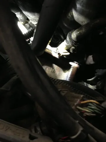

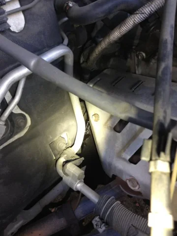

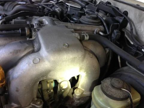

MAN!!!!!! The highs and lows of owning a Land Cruiser. Here I go. After doing a full radiator flush yesterday I drove my LC today and it was leaking radiator fluid.
In this second pic I can see through the opening shining my flashlight the highest place where I can spot coolant. I did see some coolant running from the other side.
I asked my cousin, who works at Toyota and did the flush, and he said, "I told you. A radiator flush will expose some weak spots."
He asked me to look around with a mirror. Maybe a loose clamp???? I was maybe thinking a hose?????
What do you guys think??? Head gasket? No misfiring. No milky stuff. No white smoke.
Suggestions to rule out some items or specifics I can check????????
Thats under the throttle body and manifold? PHH and Bypass Hose are located near there IIRC.
Well if I shine a light through there I can see some coolant, but it def near firewall behind block. My neighbor, being a plumber, is gonna let me use his camera that snakes through tight places. Some have suggested taking off the hood and laying across the back near the firewall. We shall see soon. I'm really really hoping its a hose. Fingers crossed.
Got into the engine bay this afternoon. Went from all angles all up in there. Then decided to crawl through DS front wheel area. I checked PHH. And PHH is def leaking.
Not sure if any other heater hoses are leaking. But it seems like an excessive amount of coolant lose to be coming from one single hose.
Is that pretty normal????
We shall see.
Just ordered PHH from 1FZFEPHH.com.
Absolutely on the PHH. Hindsight, but probably would have been a good idea, just due to age to have replaced all the hoses in the coolant system with the flush.
That's just way too much cooland to be a HG issue Al. Anything leaking out of the HG to put that much coolant ont the ground just doesn't make sense. It'd burn off on the engine before hitting the ground.
PHH and all the hoses near the firewall is what I'd be looking at too.
