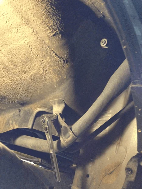

First steps are to remove all the spare tyre winch and mounting/stabilizing brackets. Pretty straight forward. A harder part for me was getting the rubber exhaust and muffler hangers off so the exhaust stuff could be shifted but in the end they came loose without having to cut them. I levered them off with a great big screw driver.

Installation wasn't so bad, after doing my homework on MUD. Removed the passenger side, then the driver side bolts and bushings. Once the bolts are out the whole rack can be moved around easily by hand, so I just misaligned the rack to the holes in the frame and knocked the old bushings and sleeve out with my drift. To install the new bushings, start on the DS, pushed the rack up, so I could get the bottom half of each of the 2 piece poly bushing in under the rack. Used some all-thread, nuts and washers to press the rack down onto the bushing.
Once the bottom half is in, then put the metal sleeve in from the top, again press in from the top using all-thread through the rack and the frame. Then put the top half of the bushing in over the sleeve from the top, again with the all-thread press. Do the same for the other DS busing, and then finally do the PS bushing.
The hardest part I think was getting all the bolts and nuts torqued correctly at the end. The DS is easier because the bolt heads are on the underside of the frame. The PS rear bolt is a bit more awkward, but I eventually got it by going from the wheel well through the channel for the drive shaft. Used thread lock too.
